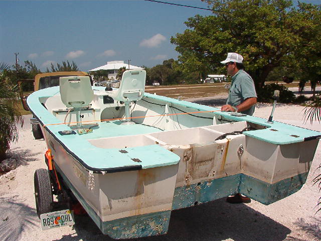

Like this Fibercraft:
Steve

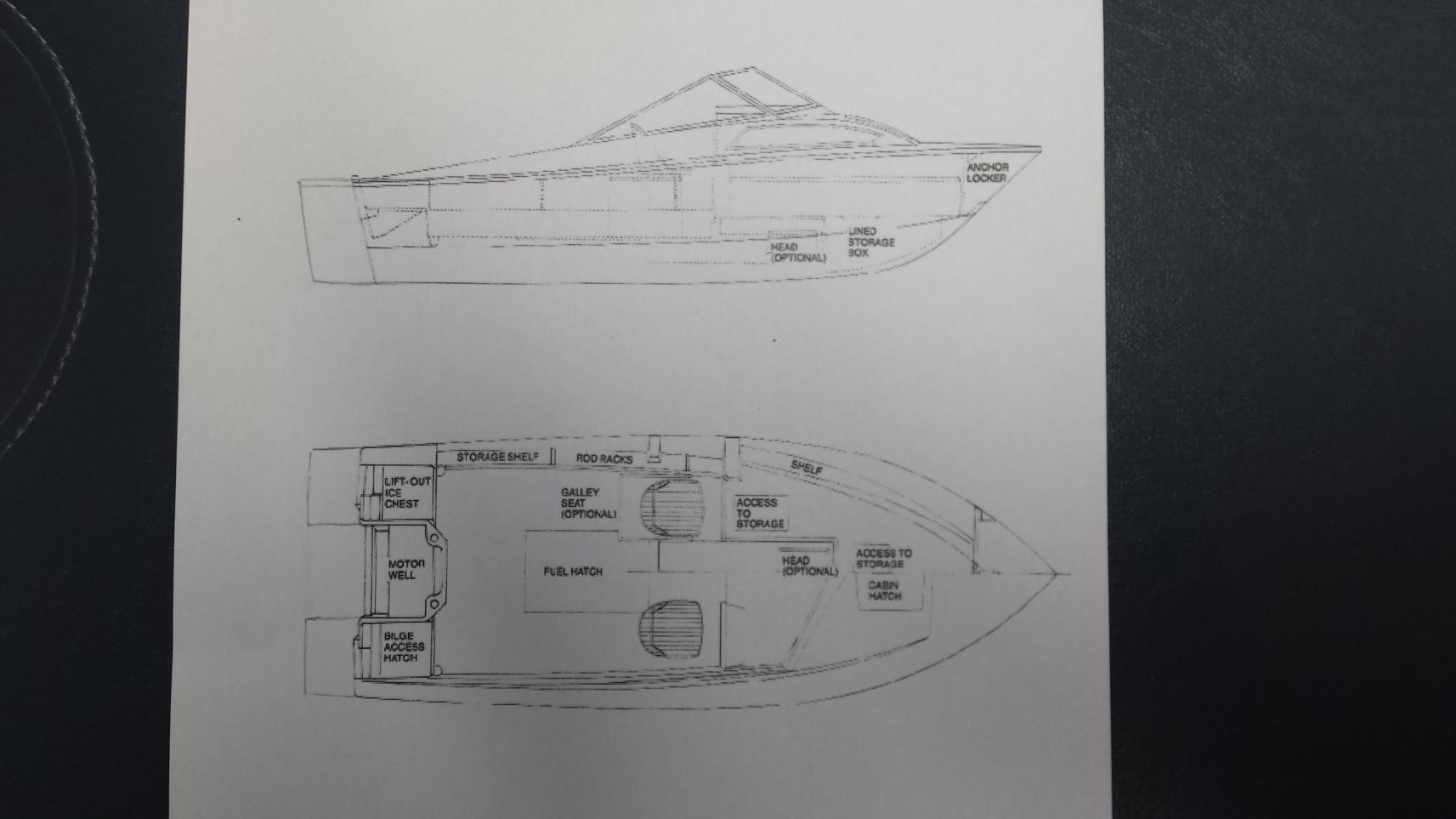

I'm thinking 2' longer. Boxes w/ sealed lower third or lower half for flotation. Upper part storage for light stuff: life jackets, fenders, etc.
Rough sketch:
Steve
