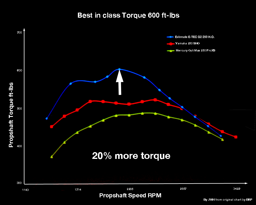

If they do make 600 ft-lb of torque, then they would make 250 hp at 2188 RPM at that torque. Unless that's prop torque. Which would be a bit disingenuous to claim.

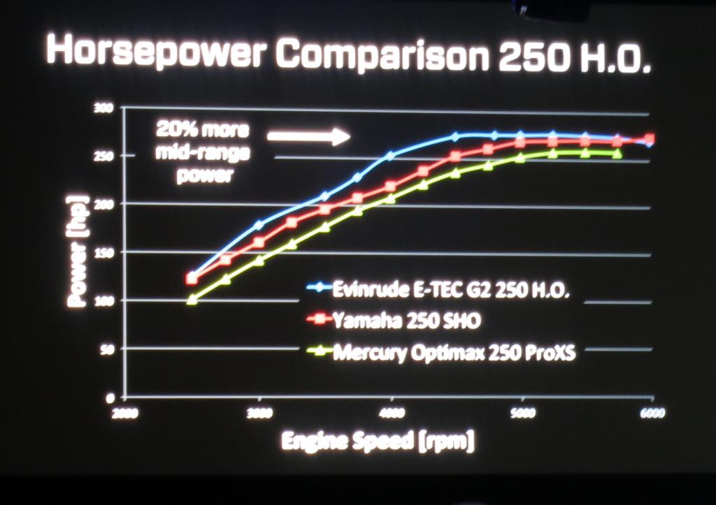

While beauty is in the eye of the beerholder, I suspect that a lot of folks will get used to the looks after they experience the mid-range omph of the new motors! (The propshaft HP/torque measurements from a calibrated eddy current dyno below speak volumes!)

Prop numbers.

I stand amazed, GFS your right as they would have us thinking. Interesting prop shaft torque huh? I'll buy that for a dollar. I think Dave Bush has placed the e-tec on the dyno and they are impressive, but not 600 lb/ft of torque impressive.. They are tractors from the looks of those numbers, midrange is what moves a boat from a standstill. I'd have one if the price was right. Beerholder here.. LOL!
As a staunch Merc Man I take note of the Big Three spanking Mercury on the numbers. Amazing that it doesn't translate on the water tho. HE HE HE!!

Very interesting graph! especially at the very low end, where torque is critical (planing slow in the slop). I'd like to see how that compares with a 5.7 V8 I/O.
And yeah, they are ugly as home made sin, but performance cures a multitude of sins.

I do so enjoy writing here. I only wish I could see Denny shaking his head whilst reading.
I`d like to see a cut away of the exhaust and the rave valve. I understand it is a gate valve which expands/ opens the exhaust as rpms climb. Note the first funny bump in torque.
It looks like they let me design the graph format re numbers.
So if the lower is 1.85, it looks like 570 ft lbs at 3,170.
600 ft lbs at 3,900 if I guessed well on my homework assignment.
Right where you need it!
Also note it holds 270 hp to 6k rpm.
Now you know why I chose yellow for the Merc curves...
