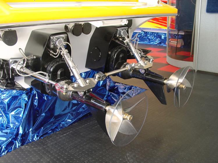

If I was to ever own a car engine boat it would have one of these.

Amen to that
