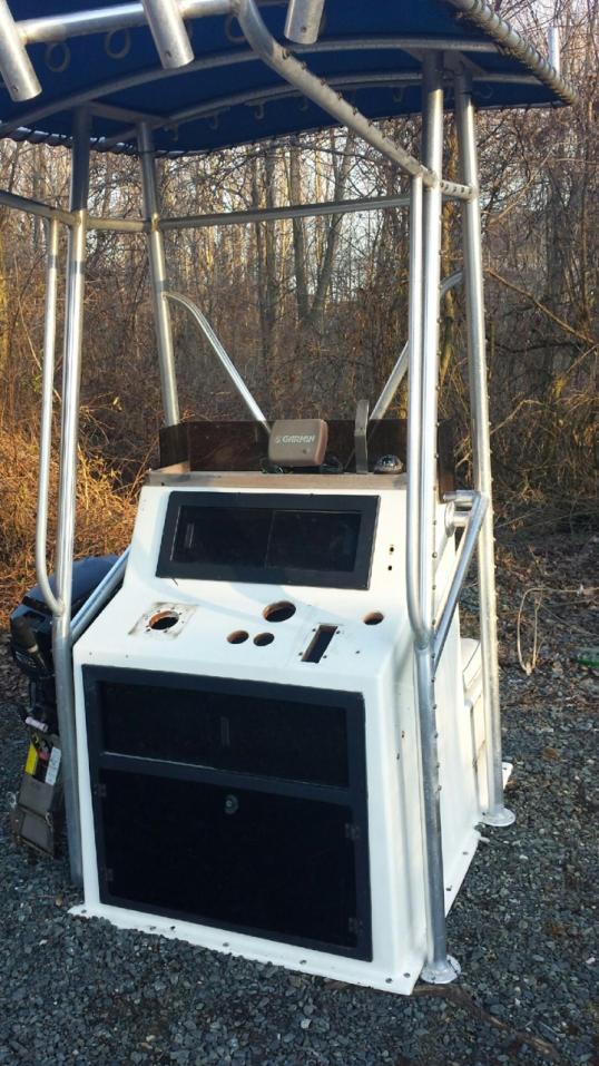

I picked up the console last week and got home about an hour ago with the t-top. Both are in good shape...better than I was expecting but will know more when I clean them up more.
I am open to suggestions on configuration. While the console is long on storage it seems short of surface real estate, which I didn't factor in with all my wants
The top storage slides right/left
The middle also slides right/left
Bottom swings out right/left
I was going to add the following:
  • Steering wheel/helm
  • Stereo
  • Trim Tabs (switch)
  • Key/kill switch
  • Binnacle
  • Gas, Tach, Speed, Trim, ?Volt? (would like others if possible)
  • FF
  • DF
  • Compass (up top)
Was hoping for a custom switch plate with ~10 switches including 12V & USB but this console has me scratching my head. I am probably going overkill but this is what I was hoping for. My past boats were already done lol.
Any ideas on where to put them? I could put them in one of the storage bins but like them where I can have quick access to. I could remove the doors I guess and starboard the whole top storage and remove the sliding doors which would probably work. All advise is appreciated to this Seacraft rookie!

Remove the sliding storage compartment and foam/glass that area and flush mount your stuff, looks like plenty of room on that console for what you want

I believe that is the only path and doesn't look too hard to remove and redo. Thanks!

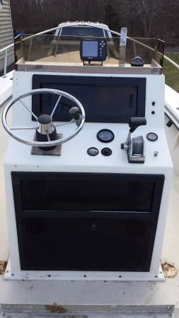

It will Be tight but you will find room for all of your stuff on that console. I have a highly modified stock console from a 70sf and have room for all of the stuff you want to mount. I sectioned a few inches out of the middle to make it narrower, added a few inches to the bottom to make it taller, and added an extension to the top for flush mount electronics. What I ended up with looks similar to what you have there but about 30" wide and tall enough to work perfectly with a leaning post instead of a flip flop seat or something. Tape it off and start laying things out with a pencil until you get something you like

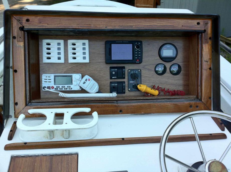

This is what I fit, and it wasn't too bad. I have a bit more area, but I put a fair amount of stuff inside the insert. I can lay the mic across the bottom for the insert, left to right, which is handy. Gravity always works.
If I had put the switch panels inside the console and not that insert, that would have been more roomy.
Some pics.
After, and before (but not done yet, but not so embarrassing):
Last one is in action. GPS antenna and 6 Watt solar panel atop console.
I am not saying I would do it that way again, but it isn't horrible. And an example to look at and learn from.
