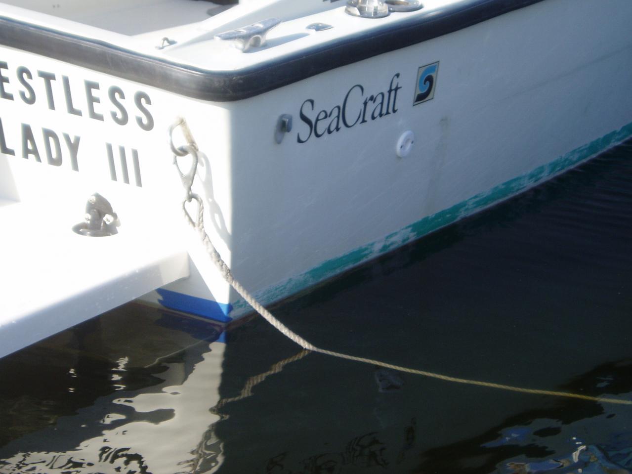

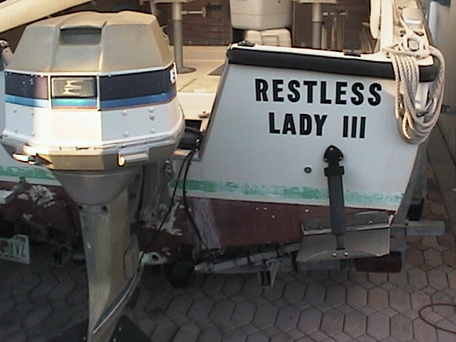

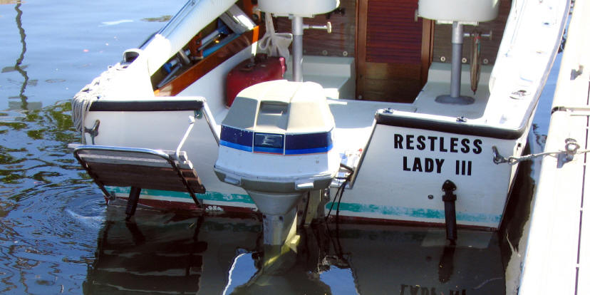

I think you'll be ok. My Seafari has the earlier lower deck and it still self bails (just barely), despite a 433 lb motor mounted 30" aft on a bracket, although the large flotation tank on the Hermco bracket provides lots of flotation. Water line is about 1" lower than when I had a 300 lb motor on it. Before and after pics shown below.

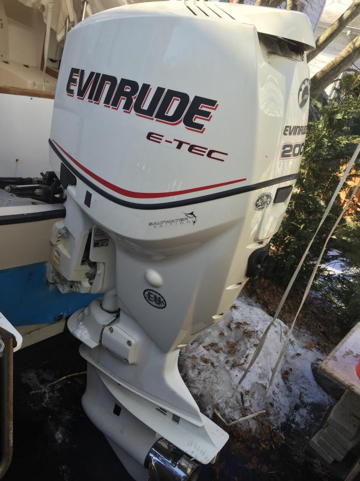

Well here she is, now gotta finish the 20SF.
Good news is the motor came with a boat to use while working on the SeaCraft.

Thumbs up Dont forget the modern H.P. sticker for the SF
Nice score -- better get some big as trim tabs to keep that lady from chine-walking
