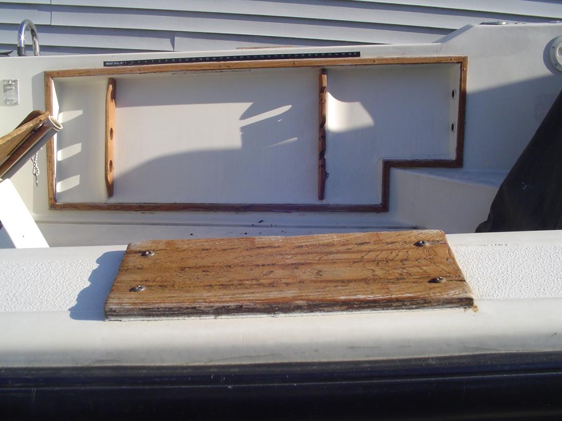

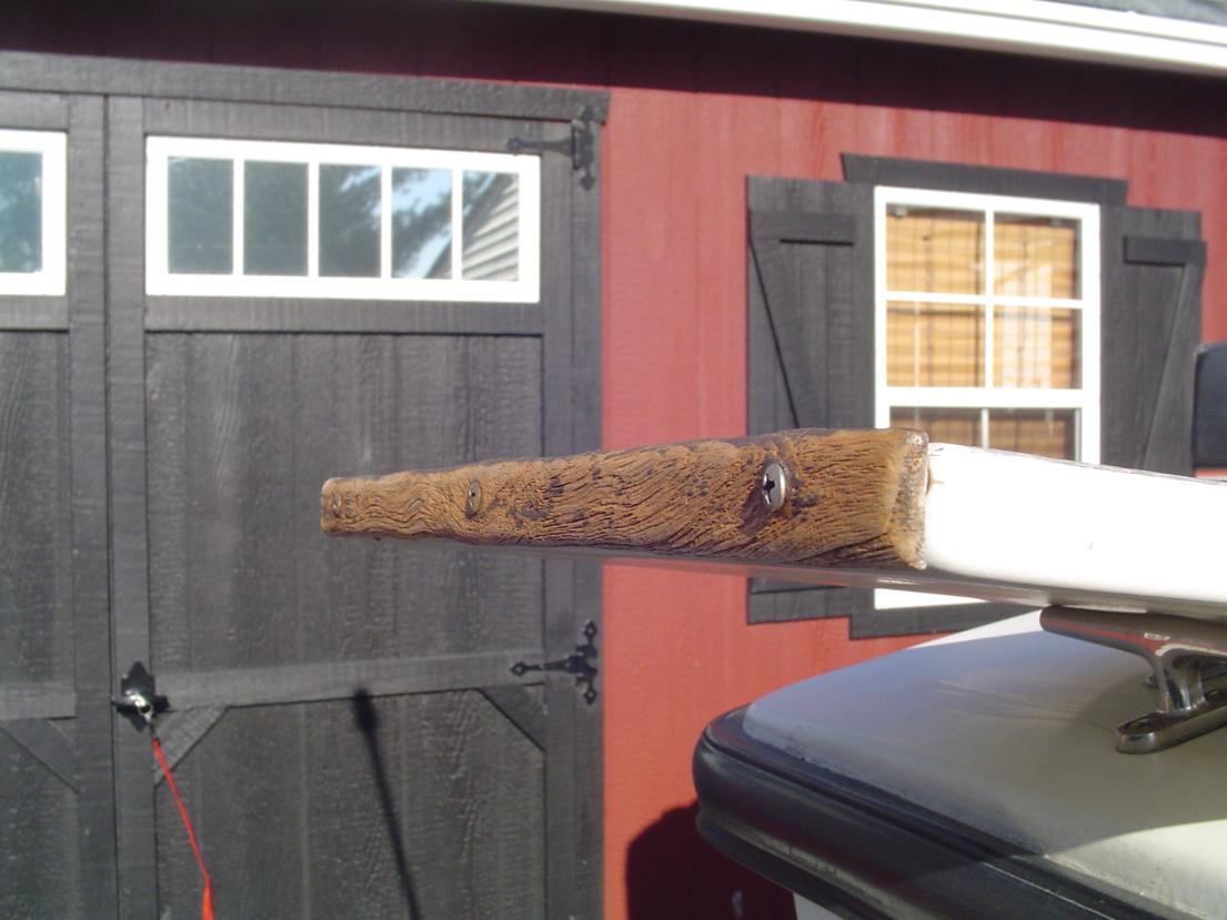

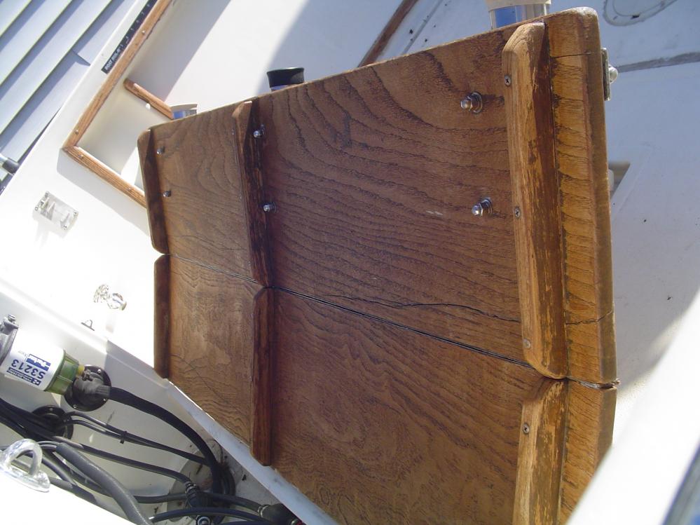

Ok guys, how do I prep the Teak? What weight sandpaper? I have always used the harsh cleaners, but never again.
Old 04-11-2015, 03:00 PM
If the soft part of the grain is gone, you may have to sand it a lot to get it smooth, so sanding with 60 grit is ok. Bare teak will quickly clog fine sand paper; I’d give it a final sanding with 180 grit before 1st coat of varnish. Follow their directions . . . thin first coat 25%, then thin the next 4-5 coats about 5%, allowing it to dry for 24 hrs between coats. No thinning required between subsequent coats. If you use Epifanes Wood Finish Gloss you won't have to sand between coats if recoated within 72 hrs, although if you get bubbles or bugs in it, I’d sand it locally with 280 grit. Before the last coat I’d sand everything with 320 grit or you can use a red 3M pad to knock off the gloss. I did mostly wet sanding of the varnish to avoid clogging the paper.
Old 04-11-2015, 07:25 PM
cdlong cdlong is offline
Join Date: Apr 2015
Posts: 80
I have a 1975 Cub Cadet garden tractor and on the posts they always want pics to guide you in repairs. I forgot, so here's some pics of the teak. I also have a pic of the stuff I put on it last. I am concerned about sanding because I figure I need to remove the teak to sand and th Po had a bad habit of using marine silicone sealant with adhesive to fasten everything. I have several spots near the rod holders where I had to remove them because they got broken into pieces.
