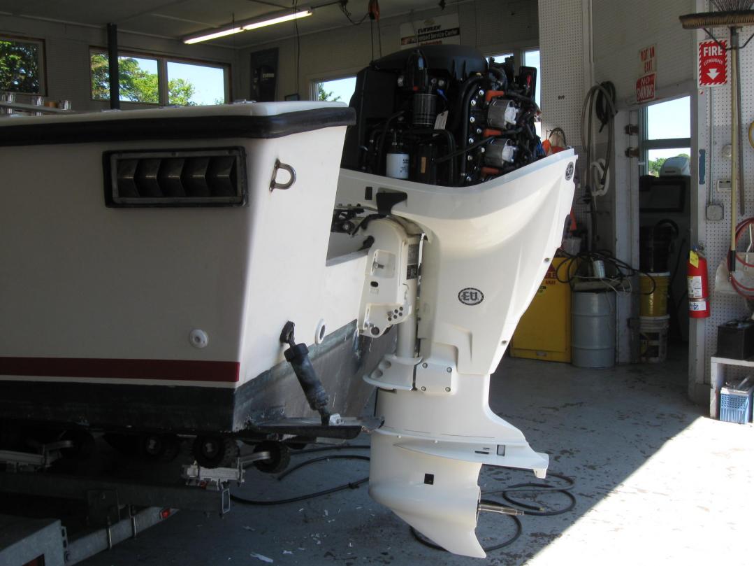

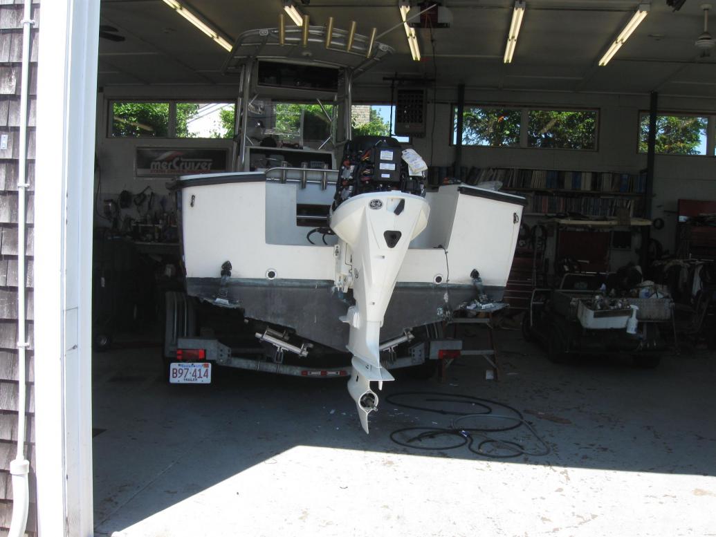

Getting close - should be in the water this weekend

Prop testing today - 47 gps mph with a 17p but 6500 rpm; 49 gps mph with a 19p but 6100 rpm; shop is getting a 18p to try for 6300 rpm. Started chine walking with the 19p. All props 3 blade. Engine height looks good. Boat was light - only 35 gallons of gas and two regular size people. Best it ever did with the 250 OX66 was 42 gps mph with 17p at 5600 rpm. I'm hoping it will be pretty economical at cruise.
Old 06-11-2015, 05:14 PM
Very nice!! I see you have it up on the third hole which looks pretty good on the cav plate. I tried to help my brother last Saturday raise his 200 HO etecs up two holes because his cav plate is way too low , the two more holes is a high as it will go. As luck would have it the two lower bolts were galled on the port engine. Rest assured the installer knew they were galled, don't ask us if we were pissed!!! Anyway I'm jealous of your setup!! Keep us informed how it's going!

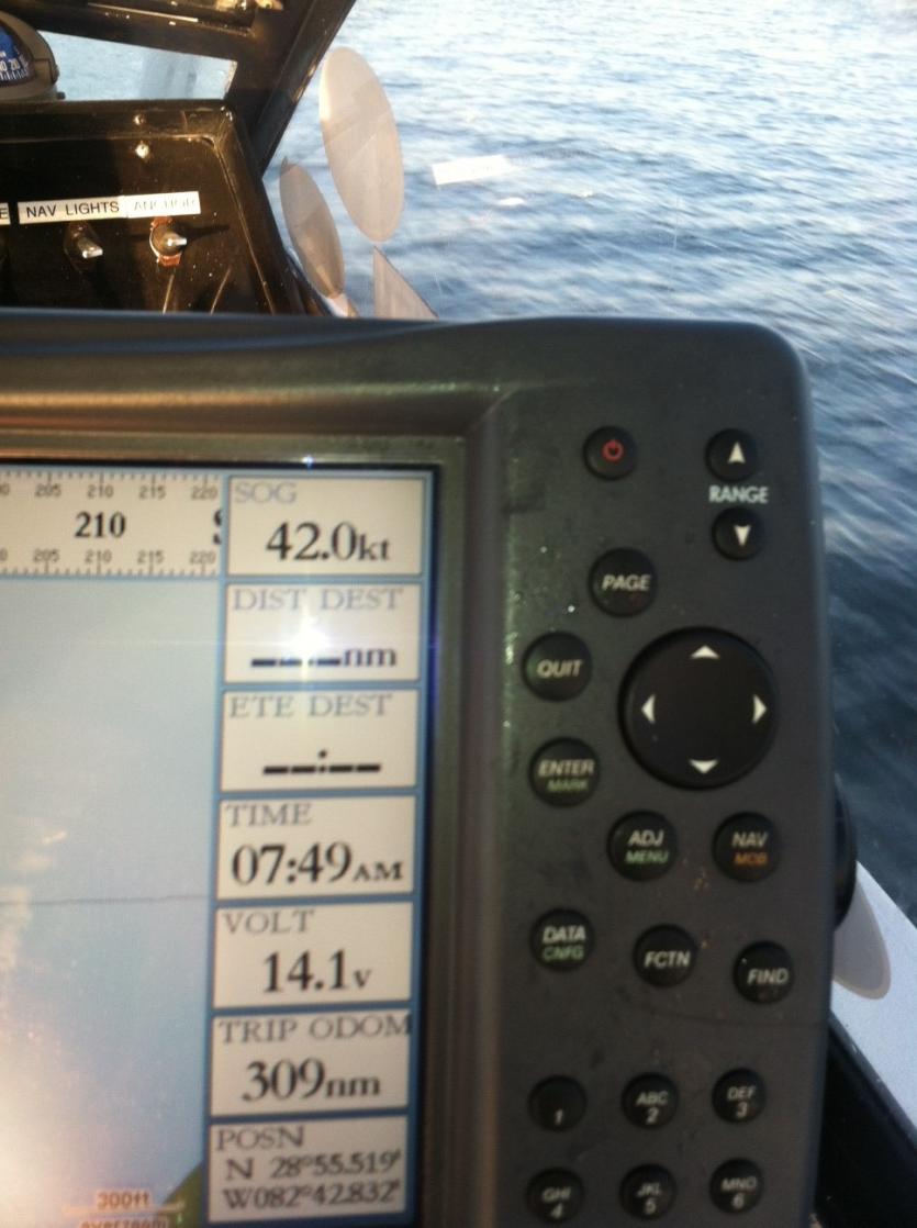

It those speeds are in nautical mph ..... That's rolling along pretty good! Best I've ever seen on my sled is 42 knots with my rattly ol 4 stroker.
Old 06-12-2015, 06:59 PM
Posts: 895
Quit "Jones'in" for a new motah, Kenny. Those mid 2000 Zuke 250's are the John Deeres of 4-S. People I know have 4800 hrs. on 'em and they ran them since new at WFO. They spool up just like your's and when they chop the throttle - the sewing machine sound. You'er good till at least '19 or '20.
Old 06-12-2015, 08:23 PM
I know, I know.... Mama said I ain't getting a new one til this one blows up. The only thing that's killing me is that Robert can get me into a new 300 AP for under $14k! Like I need 50 more ponies and fly by wire controls......But I want it!
