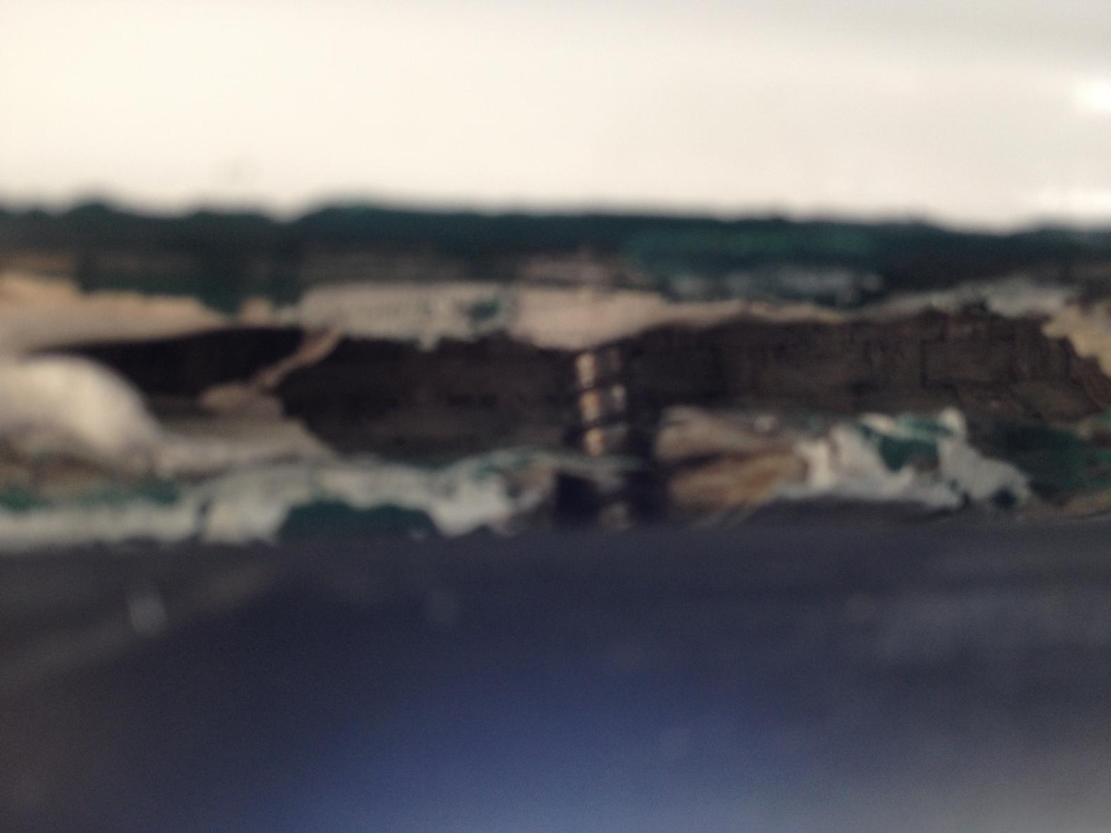

Pics
Old 06-24-2015, 10:13 PM
Still can't tell much from those pics. Is the view of the cap separation from the top looking down? Unless camera has a macro lens/close up setting, most cameras will be out of focus if you're closer than about 3-4' from subject, so maybe try backing up to about 4' from it and taking a shot from top and side to see if you can get some clearer pictures. Maybe it's just damage from a severe dock walloping incident it it's past life!

That picture is from underneath the rub rail and is about 3" away. So no major separation. Definitely no separation on the top. The picture that you posted is too small for me to see. So it sounds like you don't think that it is that major, correct?
