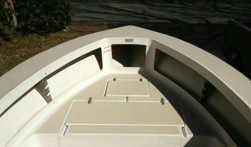

I saved your pict and was able to draw some lines

Default Casting deck
keep the peice cut outs so that you glass back into place...

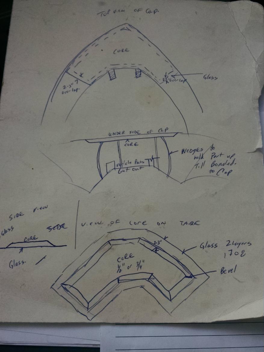

Make a template of ho much coring you want. Lay it out on visquene or layup table and bevel your edges of corelay an over sized piece of glass say 3" all around. Then add your core bevel side up.. Then glass over this and encapsulate it.. And there you go... Once cured pull it off your visquene ..and rough up the visquene side and trim and fit into place.. Make some flimsy but strong wedges to fit and hold the part ul to the deck cap.. Now that you have it all ready . get some bonding epoxy like six10 and put a nice even layer.and glue it in place. Take your wedges or deadmen and use them to hold in place till cured.. And then just go ahead and reinstall your verticle pieces..this should take about a good weekend.. Good luck sir

Question
Here's a sketch

If you were in Panama city Florida. I would definitely help you with your project. But since your not this is the best I can come up with.. Less evasive and tme consuming.. If you want to do it in three parts and not cut your verticle parts out well you can.. And then you don't have to fair or repaint at all...gl

Martin. Thank you. That is where I was going to cut but also across the cap itself 2 feet back from the bow on each side. This would allow me to remove that section from the boat. Right? Can you draw those lines and let me know what you think? Thanks. I'll

Sorry my phone is not accurate on getting them lines right on you pic so I could not do it. Per haps you could draw a sketch and post a picture of it with what you are wanting to do...but either way outrageous is right , it will be a PITA
