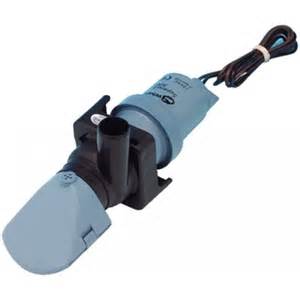

in my sea craft - I slid a whale submersible pump way back under the motor - they're great - low profile and they'll fit under the motor.this keeps water out of the bilge...

this is the whale pump - highly recommend these !
I've used these a lot on customer's boats - they're easy to mount - they swing around for mounting and the water outlet - fully automatic too
