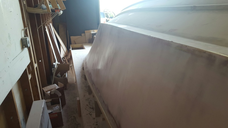

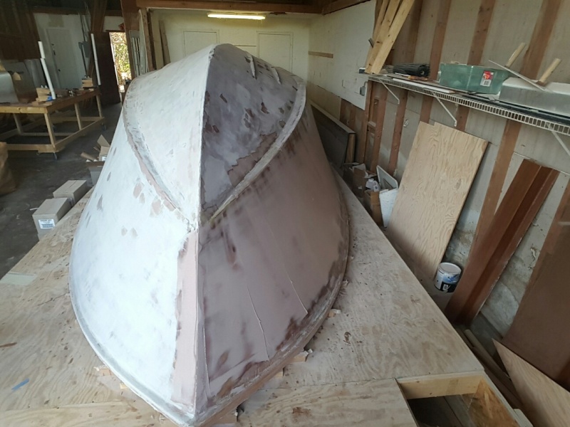

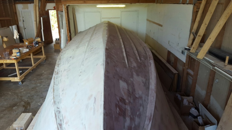

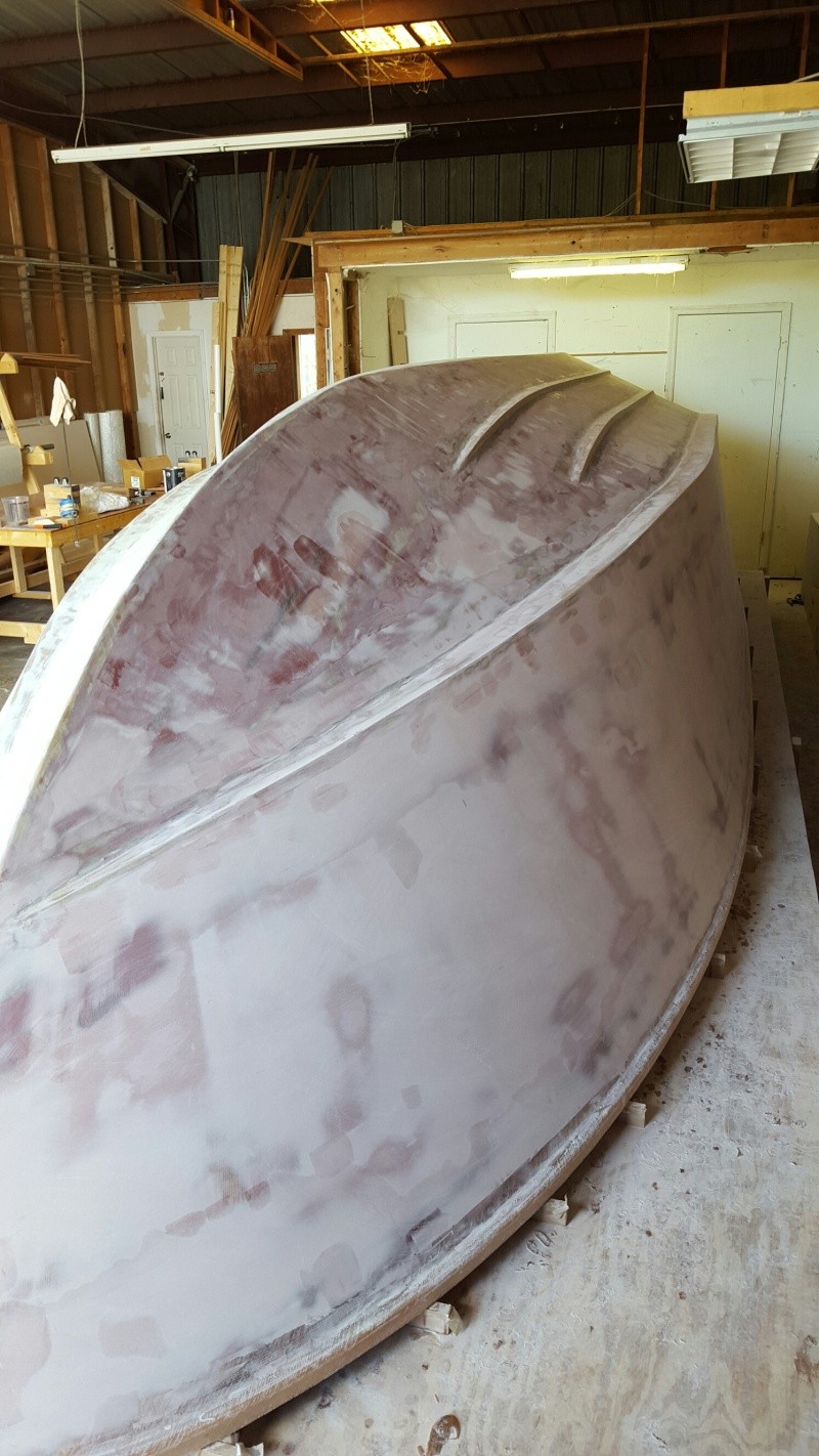

getting back to the 26, more fairing.
I got some rolls of 4.5" wide PSA sand paper in stock now. Was using regular paper with spray adhesive for the wide board, now I can use 120 and 220 on the big board.

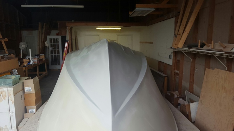

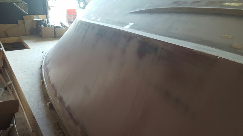

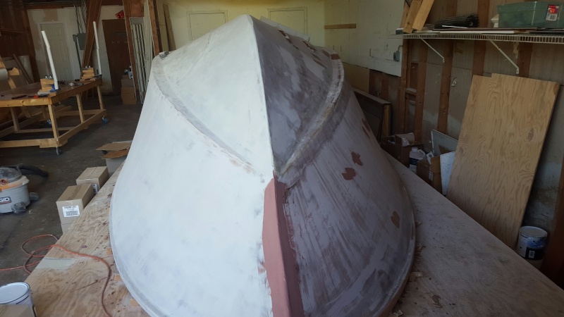

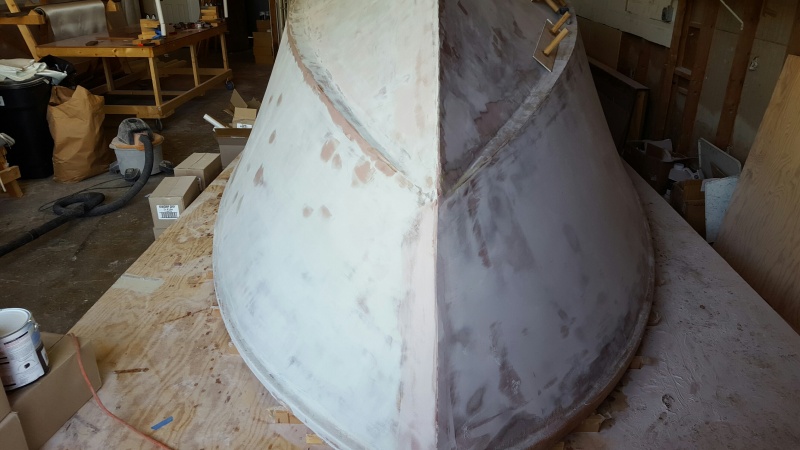

more fairing

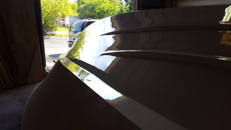

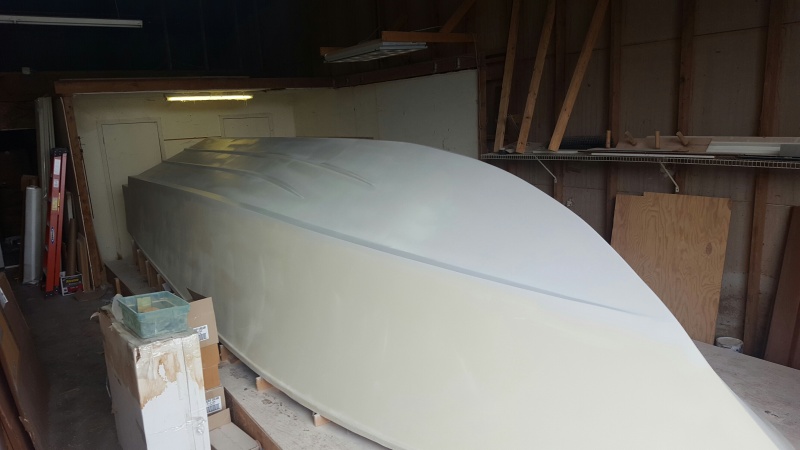

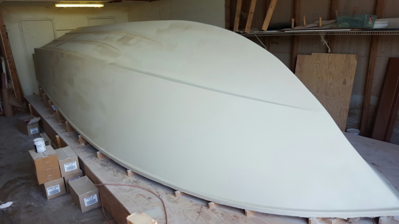

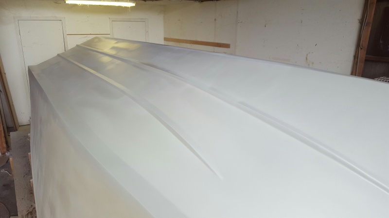

couple coats of high build epoxy primer (EMC Quantum) spayed. Just about one gallon of primer on the hull this afternoon. *Re-coat time for spray is only a couple hours, its nice to get it hammered on.
I can see a couple things to fix on the bottom before I paint. Will be painting the bottom before the flip, so I have to decide on a color. Im thinking I will do a two color hull, dark bottom color that will match trim color on the inside of the boat.

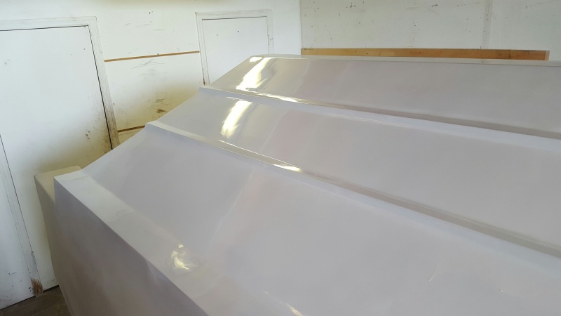

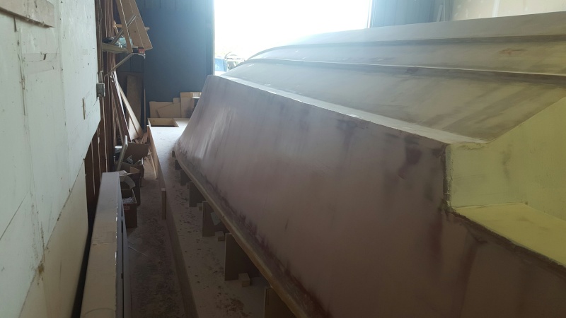

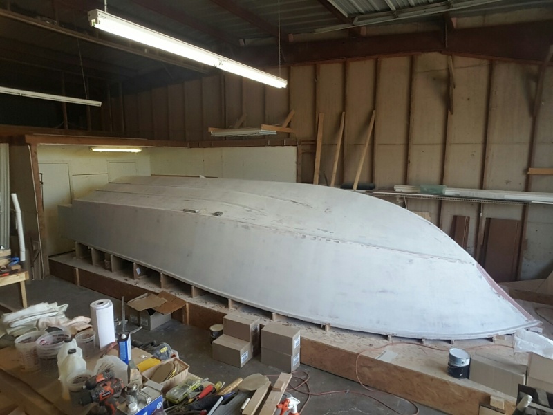

last of the primer, now lifting her off the jig/platform ......

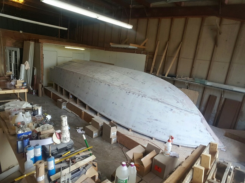

Posts: 597
Old 06-27-2016, 01:35 PM
76Red18 76Red18 is offline
Join Date: Apr 2007
Posts: 671
You missed a spot! Oh, that's a spec of dirt on my computer screen. lol
That is some craftsmanship to say the least.
