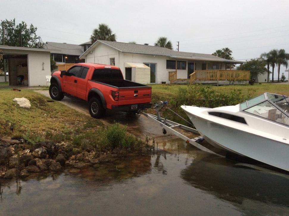

Hey Magillicutty, the dock is nice, but not exactly the reason I stole this foreclosed HUD home, haha.

Sheesus, Part II you're killing me - your own ramp too? and drive thru storage? I gotta get out of So. Cal... Is that at Hernando Bch?
