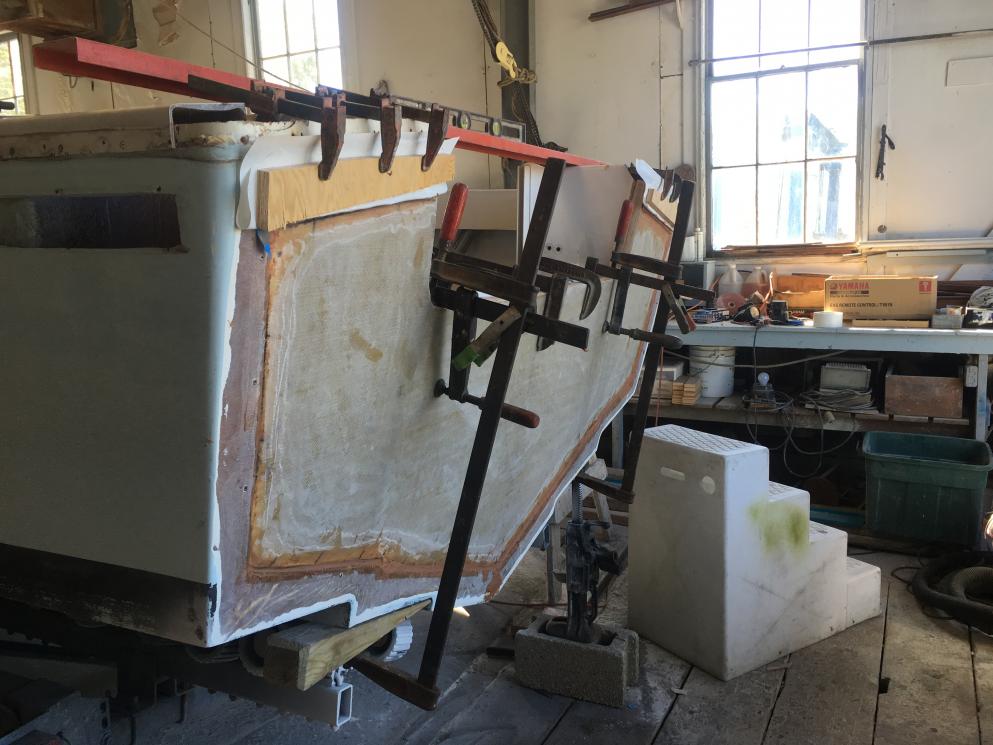

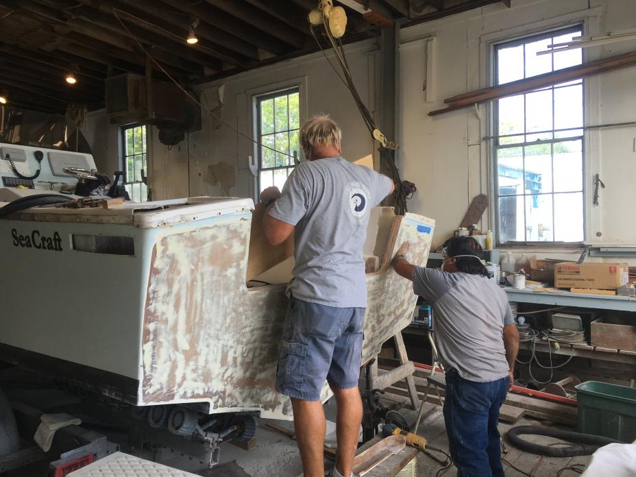

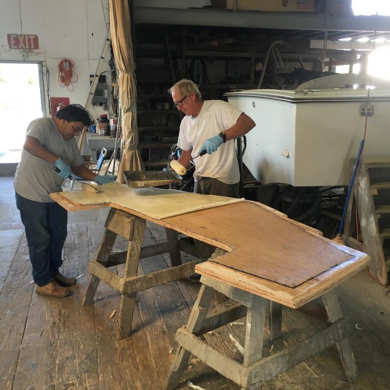

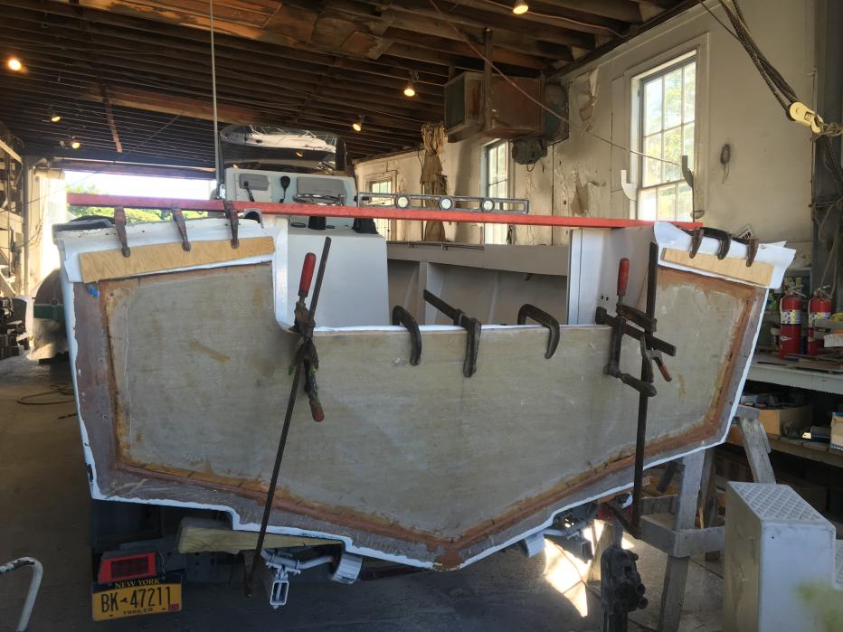

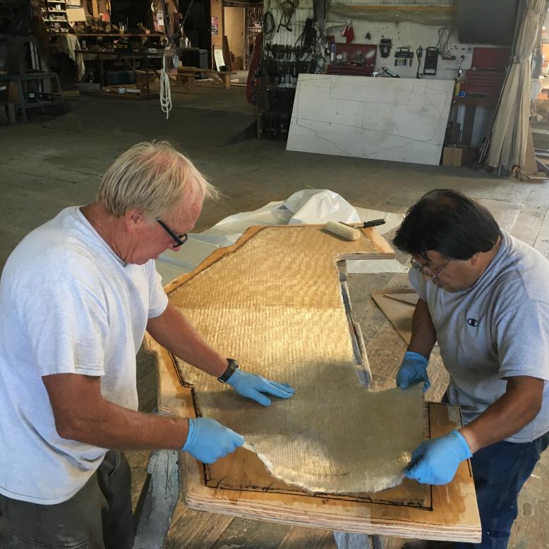

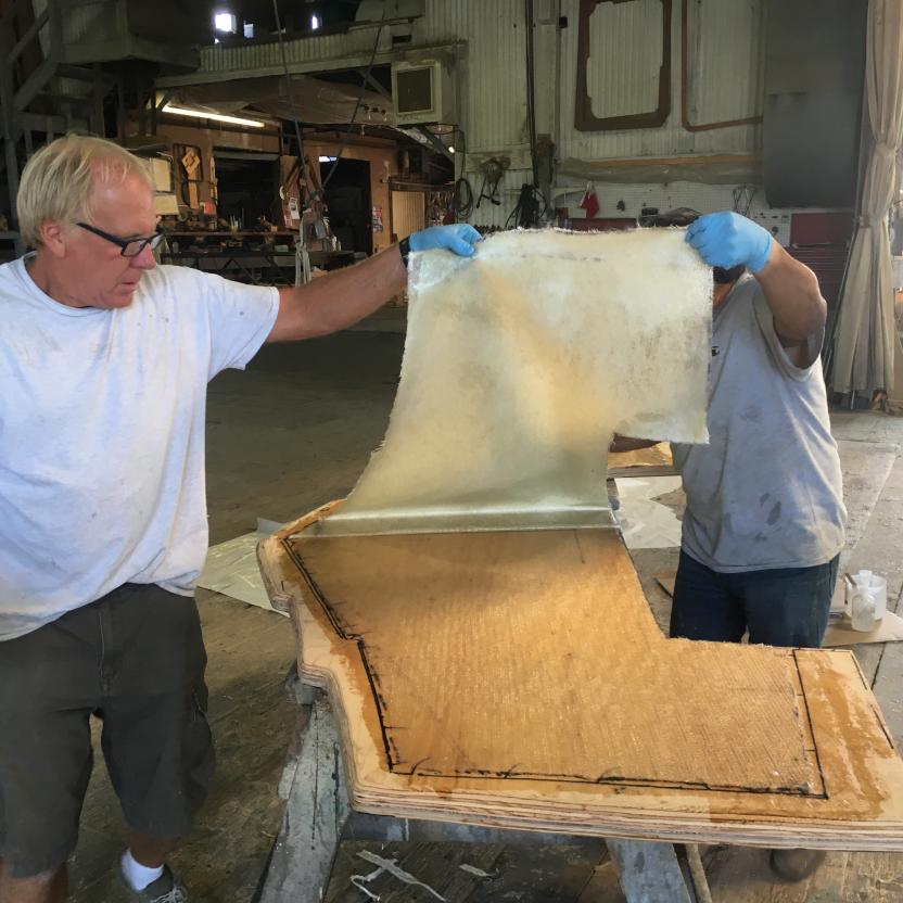

We're moving right along. Transom plywood was put together with 2 layers of 1708 in between the plywood. Then 4 layers on the outboard side and 1 layer on the inboard side. Everything was ground down and shaped and made ready to go into the boat. Today they put the new transom into the boat pressing it into a bed of thickened epoxy. Everything was screwed and clamped and left to set up, which it is doing now. It will be bulletproof when it's done. Can't wait!

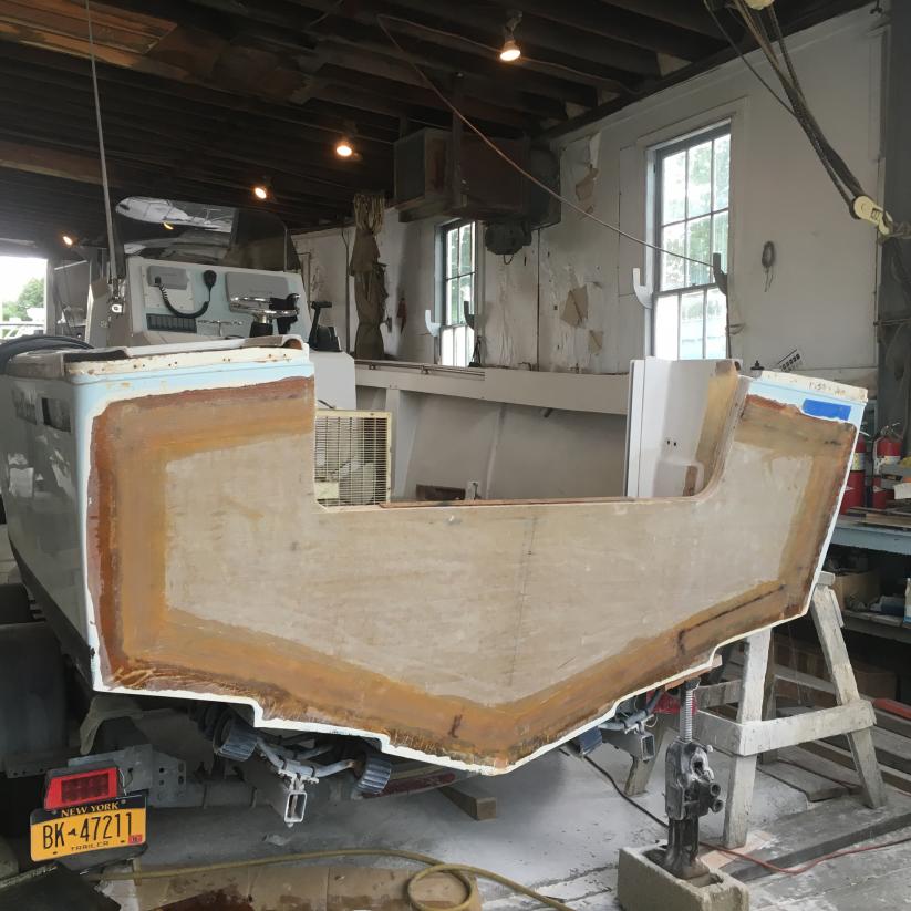

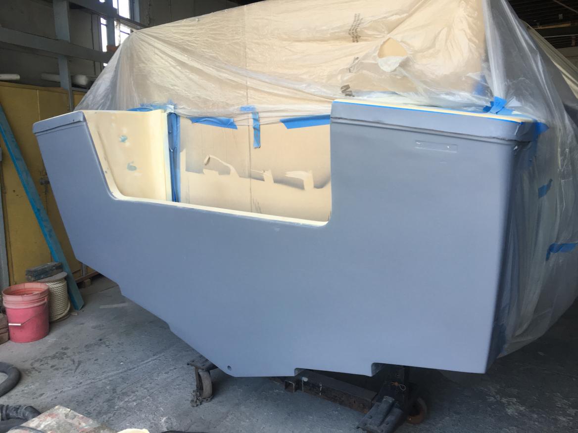

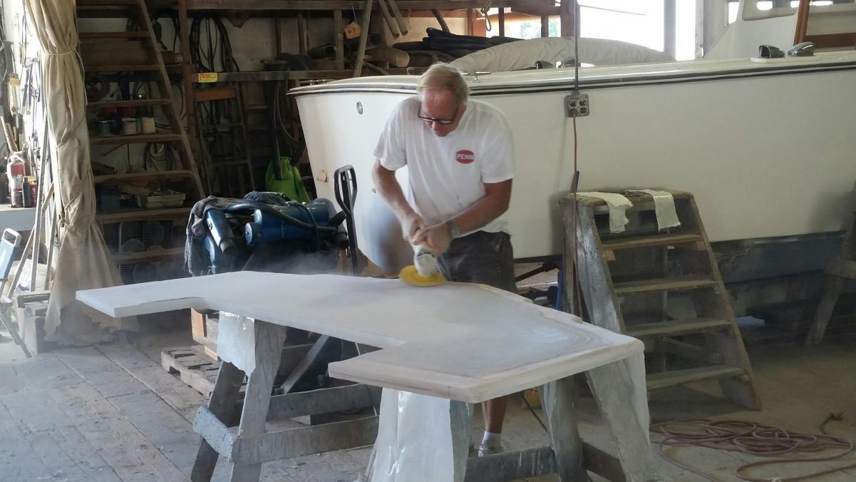

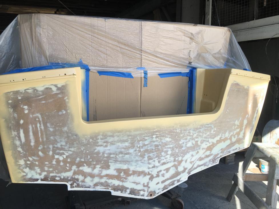

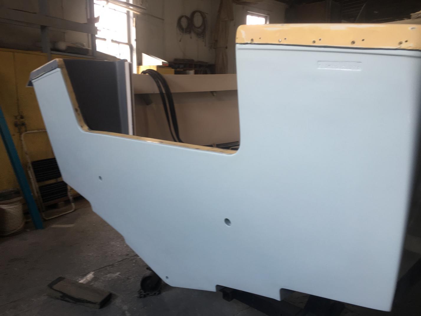

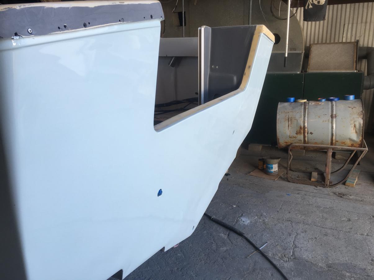

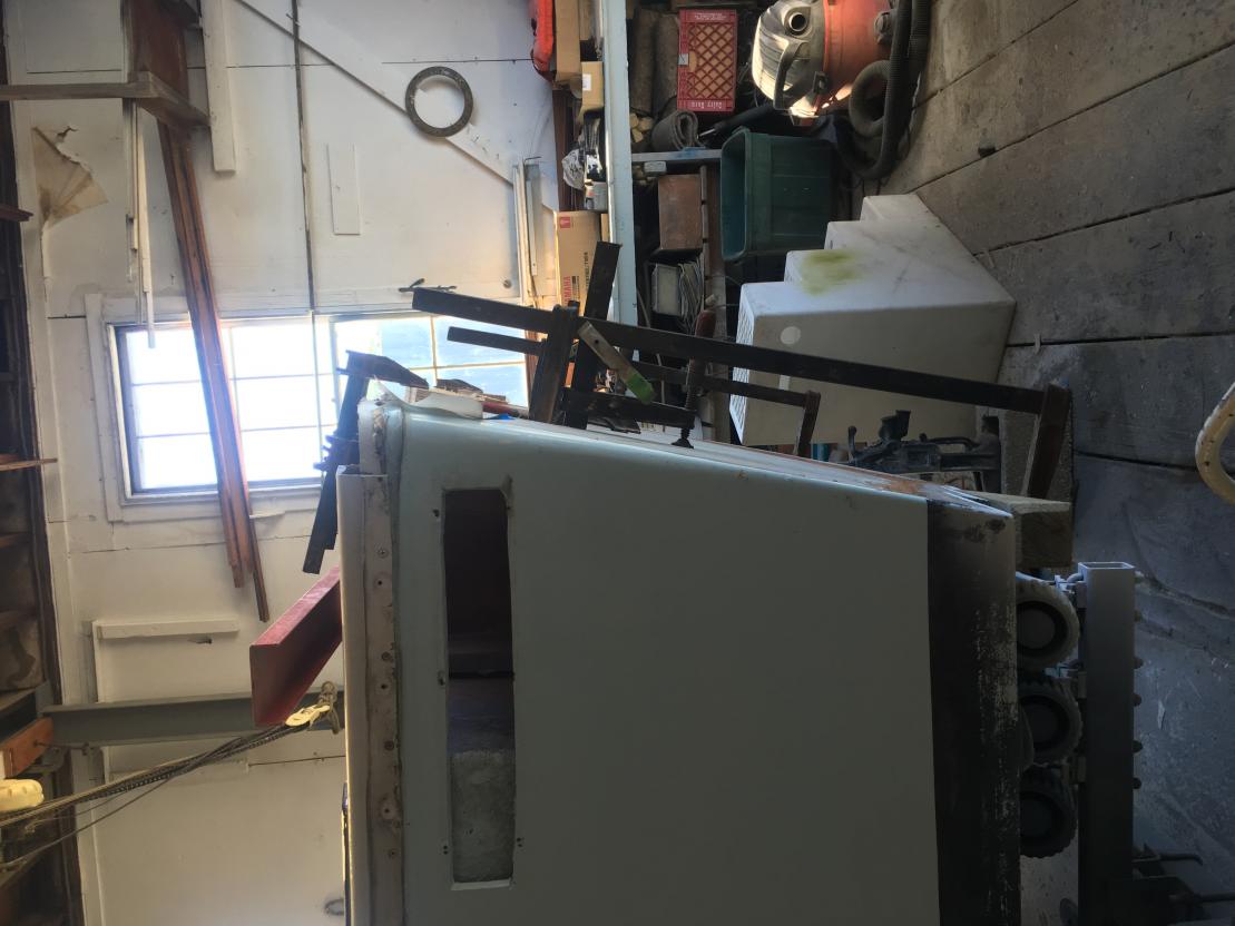

Here are some more pics of the progress being made on my Potter built 23 cc. 1st. one is more buildup along the edges with glass to smooth out the transom.2nd. more filler and laying up some glass on the inside of the motor well. 3rd. top cap reinstalled and glassed in place and getting ready for paint.4-6 getting closer to paint. Sweating the small stuff, literally.

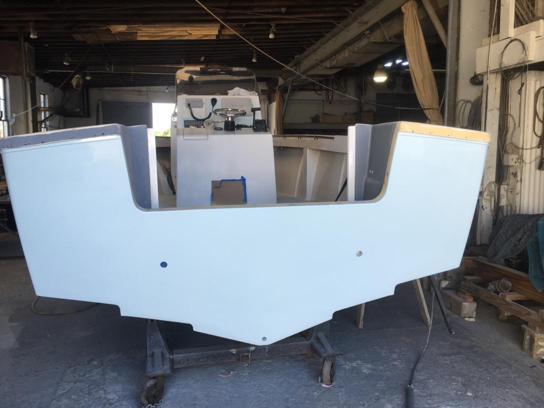

Transom paint on , needs tape lines buffed out on the sides. New vents installed. white paint for the well and transom caps to be done on Monday. Trim tabs on the table waiting for paint. "And the beat goes on"

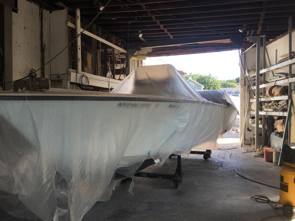

A BIG thank you to Freddy (FAS) and Pop Scop, Liz, Kevin and Louie and for putting up with me and my boat. The project went well despite the heat of summer and left the shop 48 days after the first cut. Now it's back to Remsenburg Marina to have the engine mounted with it's new 5" shaft extension for the new transom.With any luck i'll get a couple of years out of the the old '98 225. Bring on the Fall, can't wait!
