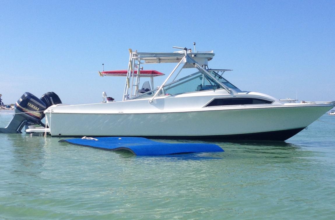

So, we took the boat out yesterday. Everything ran great, except the oil reserve pump which I knew was out, so had to manually add oil to motor reservoir. No biggie. After we got back I noticed a lot of water running from under the bracket. I pulled the plug on the bracket pontoon and it ran for about 10 minutes. Looking back at this picture I can tell the boat is sitting stern heavy. I tested it again by putting water into the pontoon through the maintenance hatch and found its slowly leaking between the bracket pontoon and the boat itself, not through the plug. I need to seal the pontoon properly and hopefully prevent it from taking in water, perhaps seal bracket bolts again? This was supposed to be done by the service in SC, but seems it wasn't done properly. Any suggestions on product? There is bottom paint around the bottom portion of the pontoon, the bracket is a Stainless.

leak through the bolt holes? or through a crack in the pontoon? A crack should be fixable with 5200 or epoxy. Bolt holes could be sealed inside the pontoon with good caulk, but what about where the bolt goes through the transom? That has got to be sealed to keep water out of the transom core. Doing bolt holes right probably requires pulling the whole thing off the transom.

It might be leaking through the bolt holes since its not through the plug. I didn't see any seepage on the inside of the transom bolts but that doesn't mean it won't happen. Is it possible to take out one bolt at a time and properly seal without taking off the entire bracket and motor? That's something I could do otherwise I have to pay someone to do it. I was thinking I would seal the entire pontoon properly which would, in theory, protect the bolt holes within the pontoon from any seepage. I can easily take out the 4-6 bolts running the length of the platform and properly seal those because they are easily accessible inside and outside of transom. Then, maybe seal the length of the platform also? Good thing is it's only been out for a few short rides but it's apparent that after sitting in the water for a while it gives it enough time to fill that pontoon.

Do you have access to inside of transom? If so, I'd pull the bolts, drill the holes oversize (like 3/4"), fill with thickened epoxy then redrill. That'll keep the water out of the transom core, but if they didn't put plenty of 5200 between flange and transom, you could still have water leaking into flotation tank. Don Herman uses lot's of 5200 on that flange and swears that after it cures, you don't even need the bolts! But you'll need lots of debond, a knife and some wedges to get the bracket off!

There's a very small inline oil filter on the discharge line near the tank. When clogged won't allow transfer. I used 5200 to seal my bracket.

Thanks gents. I will do all the above. Going to seal entire platform and float first and then seal bolts.
