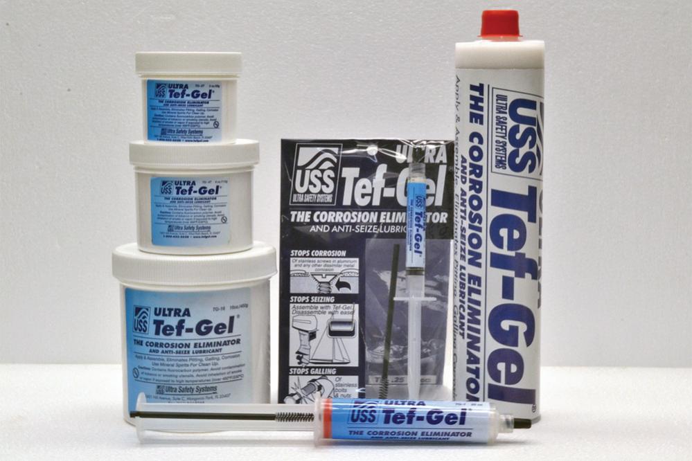

Now if you want to make that trailer Gucci and keep it long time, get yourself some "Tef-Gel". Back off all the stainless bolts and hardware that touch the aluminum frame and apply the gel as instructed

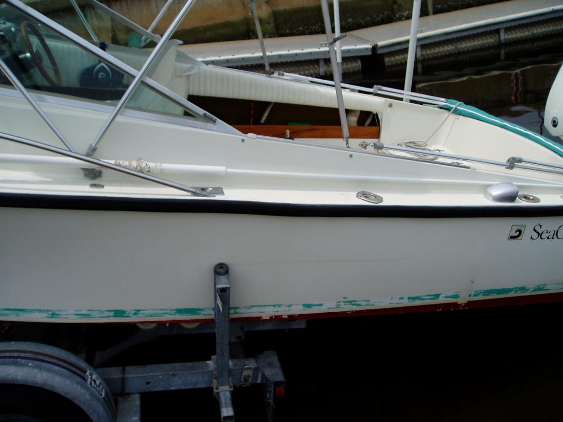

I used to have some side rollers (shown below) to force it on straight and even had 'em raised about 12" to contact the rub rail, but I took 'em off after discovering I didn't need 'em once I got the outer rollers adjusted correctly. However I still have those side rollers, so if anybody wants them let me know!
