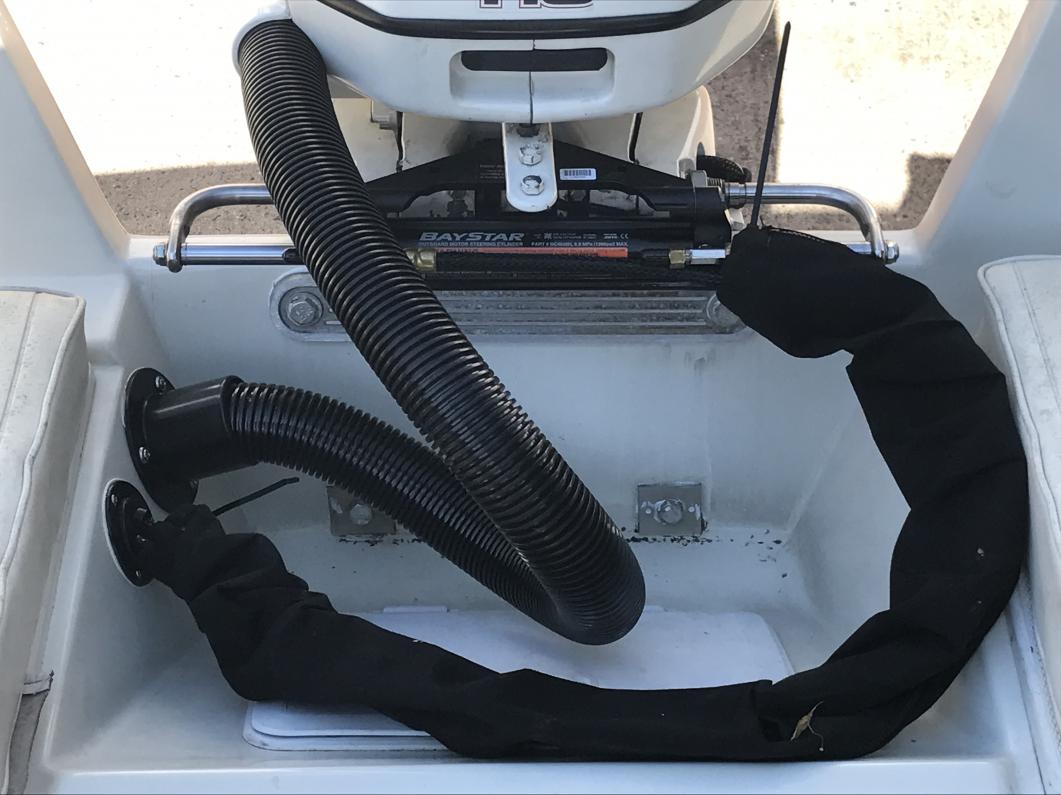

Here's a shot of my rigging loop on the '72 Seafari with 15' cables and a 36" loop. Just for reference. Michael - did you get the surging problem fixed?
