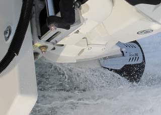

Don't know what motor you have, but the BRP Cyclone is an excellent 4B prop with lots of stern lift. The BRP Rebel is also a very good 3B stern lifting prop with lots of blade area and cupping. Pic below shows what you should see up on plane if your height is right.
