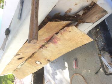

Yes Gents that is Cheap recycled plywood...
Lasted ten years with a lot of resin and cloth...

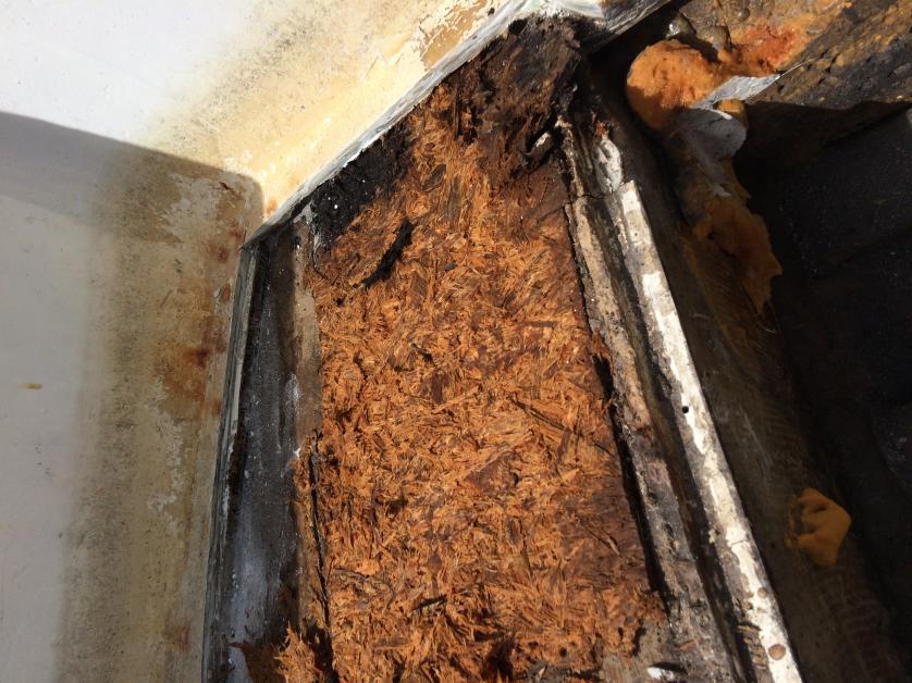

Ten or so Years ago I got this Hull for about Five hundred bucks...
-The Deck only had a few soft spots typical areas around console.
Sooooo not knowing a much about boat work.
I cut away the original skin and chipped out
The Balsa. Left the original bottom layer of Woven Roven
Or whatever it is and laid cheap wood with about 20 gallons
Of resin and I have no clue (The amount of Biaxyl and matte)
I used.
Then went fishing in the Florida Straights for a number of years...

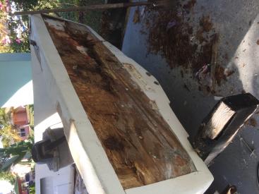

After a long layoff but still fishing and working I’m back at it again
Deck is ninety percent off but the transom is a mothersucker
Will be posting on weekends
Almost cut it up and hauled it to the dumpster
Thanks and I hope everyone gets a chuckle Good laugh

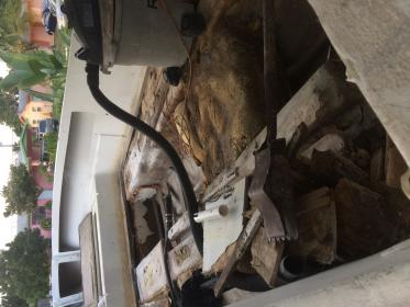

Old 12-31-2018, 07:21 PM
Deathfromabove Deathfromabove is offline
Location: Boynton beach, Florida
Posts: 65
Default Some more new year boat pics

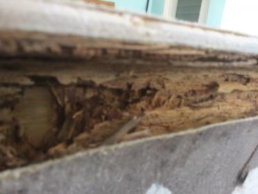

Well was really doubting myself and got a lot of verbiage from friends and out of my mouth grinding and cutting my neighbors said they think I made a new language and yes I know it’s only the beginning
Wth would you spend the money and restore it when you can buy another one
Good question would be my response.
The hull has been fished hard

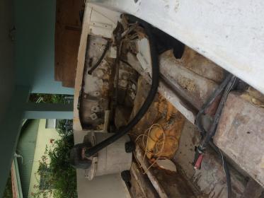

Old 12-31-2018, 07:34 PM
Posts: 65
Default Hank Williams and beer drinking
Not much of a drinker, if I have a three beers a year then that’s to many
Well I had a six pack and cranked up the tunes

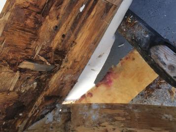

Going to lighten her up.

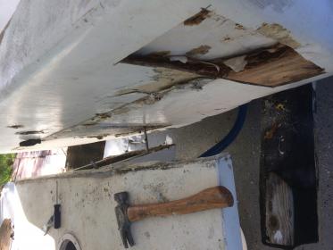

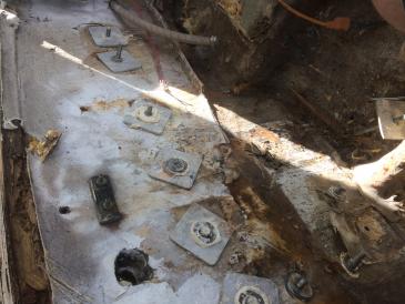

I removed the water logged deck which was a buck fifty and the original live well
Plus some grinding and three city garbage cans full of misc wood and wire etc
The original deck I removed like an idiot mainly because I found this site after the fact wayyyyyyyy after the fact. I never knew the hulls were this admired and this good.
The plan is to coosa the transom and deck and re pinstripe it along with redoing hatches but I’ll probably change my mind on deck layout and casting platform
Also I will give it The Captain Chuck Gucci touch eventually
Going to take my sweet time with it

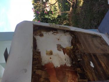

Old 01-26-2019, 07:39 PM
Posts: 65
Default Part Next Weekend Everyone’s Invited
You are cordially invited to my fiberglass grinding Partying
Hahahaha well still working on it the more I take out the more sins I find
Crap after crap

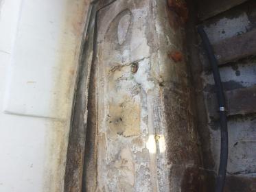

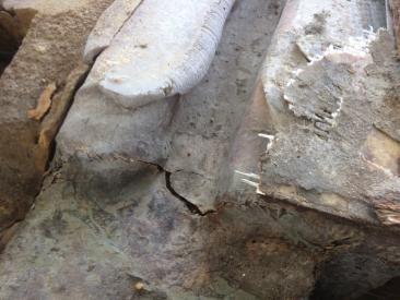

Cut out some transom and took it the publix to weigh
Eighty nine pound for this piece picture attached somewhere

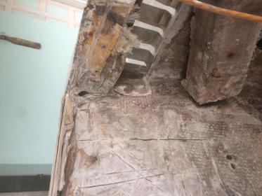

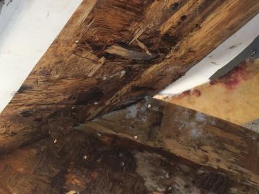

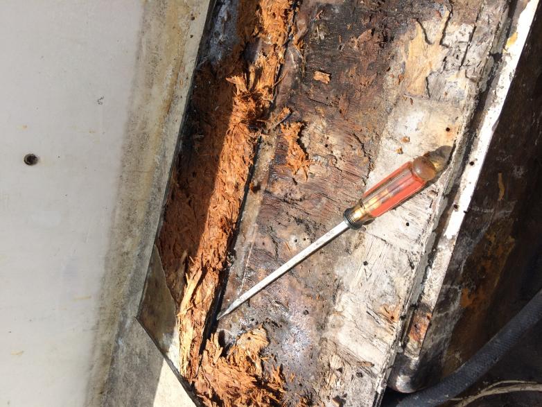

Old 01-26-2019, 07:44 PM
Posts: 65
Default Cutting the weight

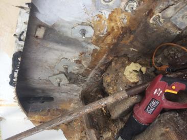

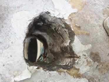

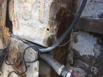

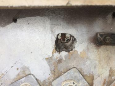

Guesstimated weight I’ve removed so far is about three hundred and fifty puonds removed so far but it’s probably closer to four after today grinding and chipping away rotted wood and everything else that was put in a five to seven inch transom
Stringers were water logged punched a hole in both of them and couldn’t believe the water that gushed out really disheartening lol
Potter’s putty unbelievable really unbelievable hardness and strength
