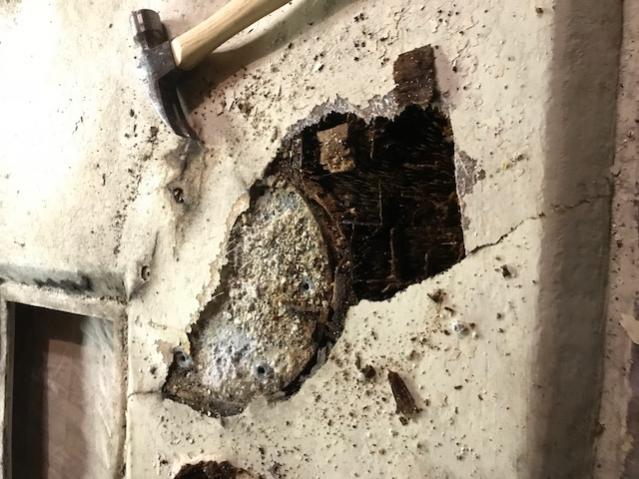

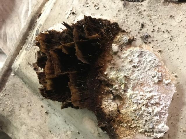

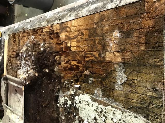

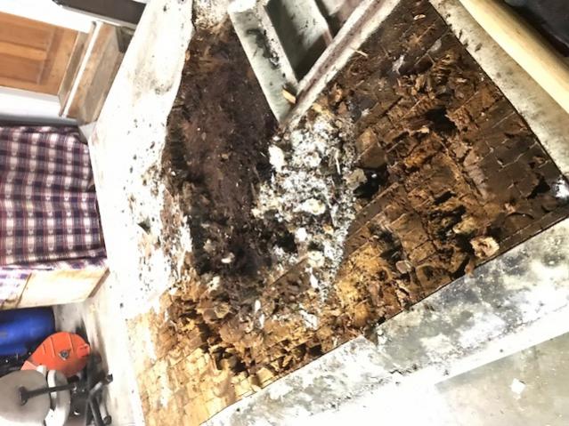

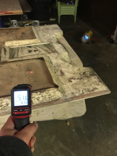

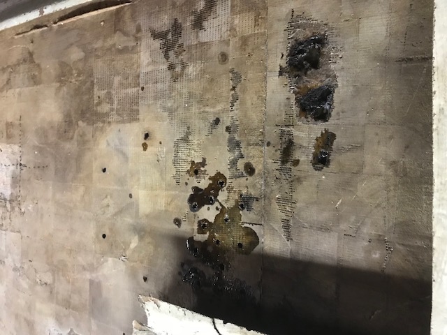

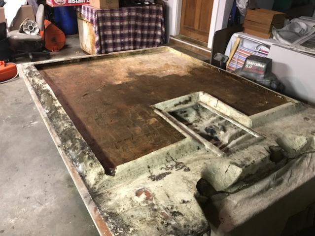

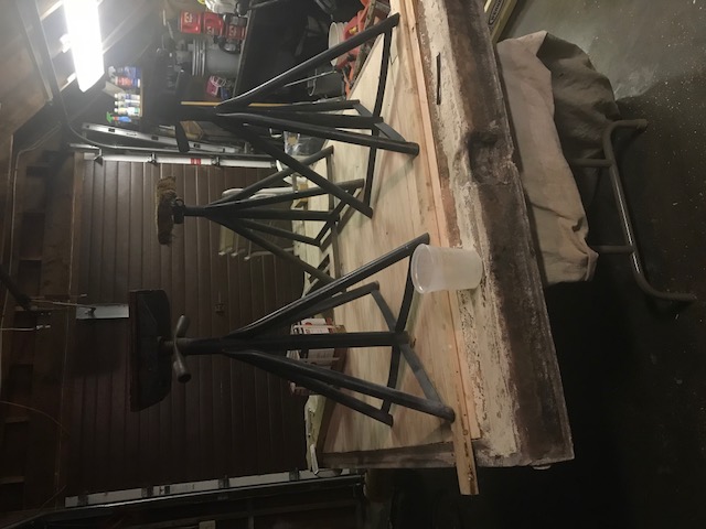

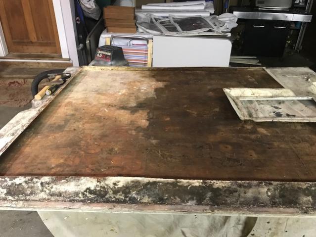

Beginning a series of multiple items on the to-do list this year for the SeaCraft. First on the list, I had to get the rear deck out to investigate what's underneath. Tanks look good, exhaust hose should be redone I think. Anyways, removing the deck lead to the first thing to get done, the rear deck core. I wasn't planning on doing it this year since the top seems solid, but since it is out and I have a free table, so here we go.

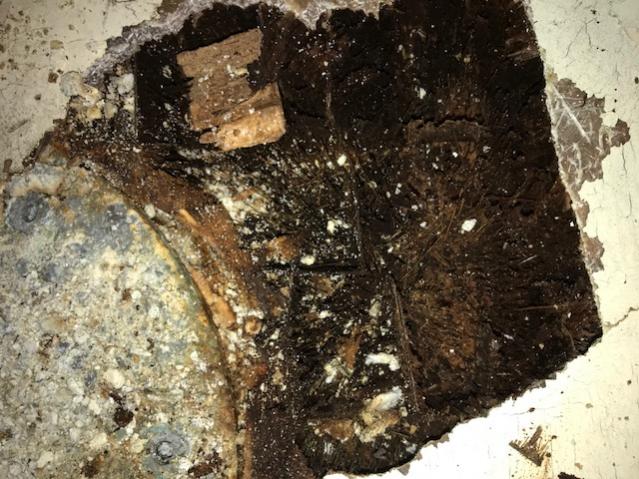

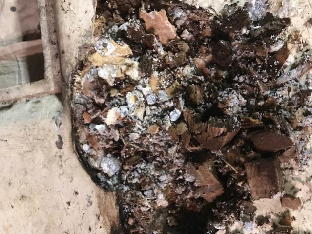

I cut a seem essentially around the core and dug all the crap out. It was all mushy crap, the wood was fully saturated and must have been for a long time. I am amazed that the top skin was still rock solid. I got all the crap out so far, and for the most part the "first layer" which appears to be 1/4 ply or matting is still solid except for a few areas.

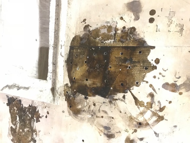

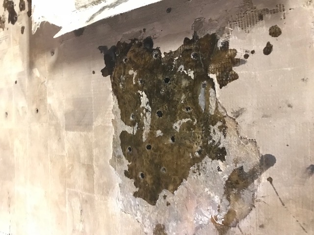

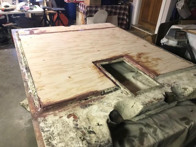

My game plan, is to counter sink a bunch of holes about a 1/2'' apart in the small soft areas that I now have exposed. Once that is done, I will replace the core with marine grade ply or maybe nida core?
Whatever the material is, I will layer resin, layer the core and put that in place. Then I will resin the core and cover with some commercial grade fiberglass mat I have.
Last, feather in the new core to the seem I cut. Sand her down, paint it up, and call it a day.
Any thoughts on the game plan? I have only done one of these before but I'd really like to get some insight from the forum before I dive into the repair.

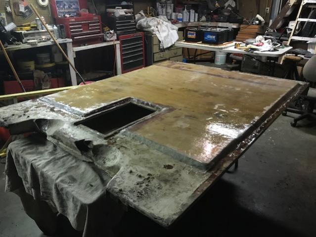

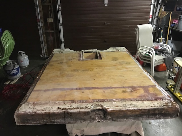

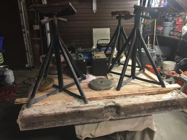

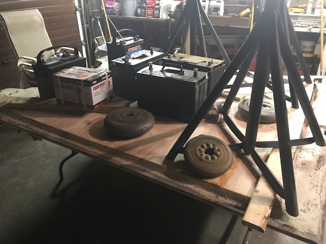

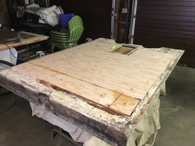

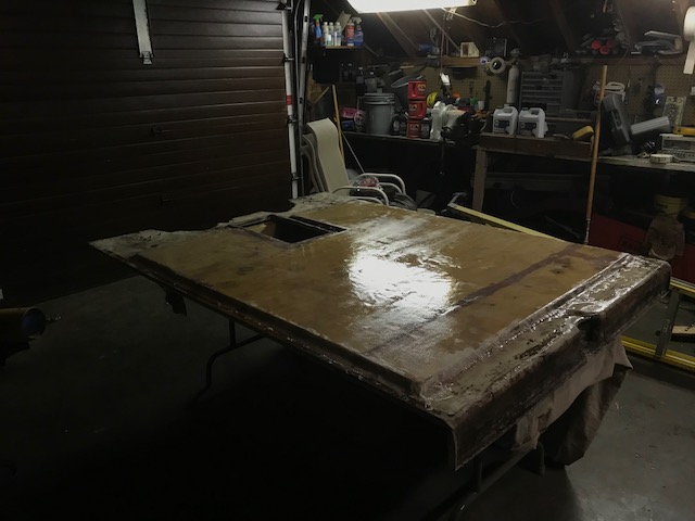

And, this is the progress about 3 hours later. Letting the decking dry out for now since it's still pretty wet to the touch from all the soaked wood sitting underneath it.
Hopefully it will dry out. I'll start sanding it down tomorrow or over the next few days to start preparing for the glass work and core.

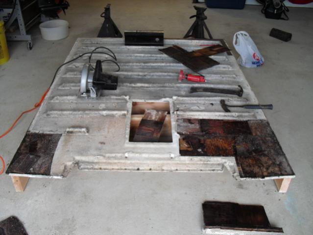

Hi John,

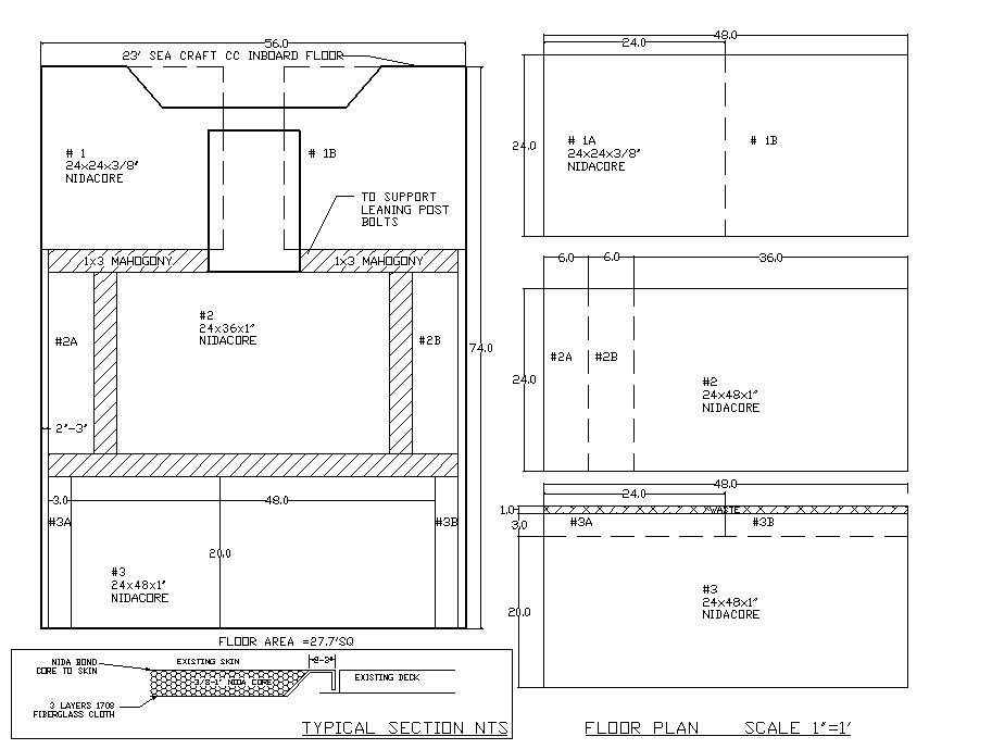

Did this a few years back on my 1976 inboard

I used 1" nidacore. The mahogony was a base for my leaning post screws.
I built a frame of 2x6's that would allow for the center of the floor to have a slight crown- (about 1/8") to shed water.
Looks like you have the hard work done. I would just suggest you plan where you will need to screw in your seats or leaning post, and a slight crown will keep you from stepping in water every time it rains. The nidacore will help to shed a lot of weight.
Good luck with your project.

Nidacore is much easier to cut and work with than plywood.
It's incredibly light.
Just make sure you bond it the top skin with resin or a bonding agent, and remember that it won't hold hardware bolts. Just plan ahead like I did with the mahogany.
