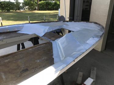

No This isn’t the red one with the top. I got this one in south Florida somewhere, can’t remember exactly. And I decided against the 350 just due to the fact I have a new steering system I already bought for the 300 and would have to go to the tournament for the 350. Just started to get more than I thought it was worth. Got the cap core all glassed in today, gotta glass over the top of it tomorrow. Almost done with all the glassing finally, hopefully be painting next weekend.

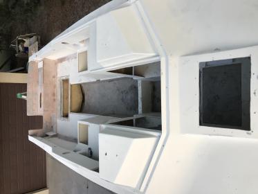

Got the cap all cored and glassed in yesterday, flipped it and put it back on today. I sanded it all and am filling some holes tomorrow then will sand those to be ready for paint. I do have to say that after about 60 hours of sanding if anyone says something about an edge or line I’ll have a blow up raft and compass to give them to get to shore!
