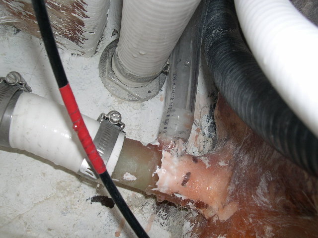

Deck drains = to hard flex tube = out to Gemlux Flapper scupper drains. I also tied in my transom live well drain out. Just some thoughts for you.

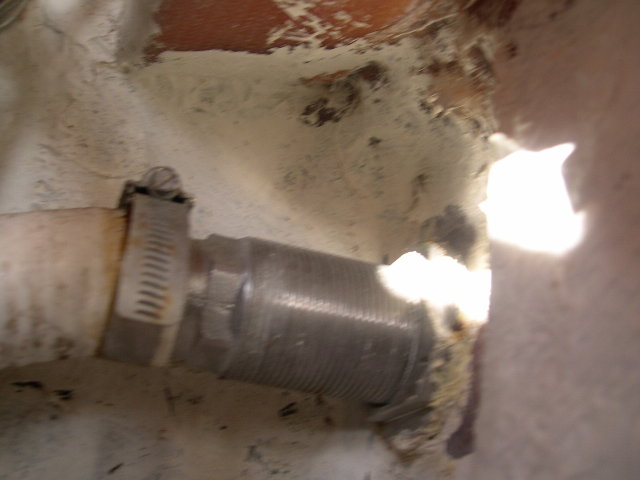

As I recall, they were 2" Bilge hose to the 1 1/2" glassed transom deck drains. I used a glass exhaust reducer.
The same size hose as the Jabsco Macerator Pump.
The Gemlux Flapper thru Hull Suppers were 2" Barbed. If you heat the hose a bit it goes on & off easier, then hose clamp.

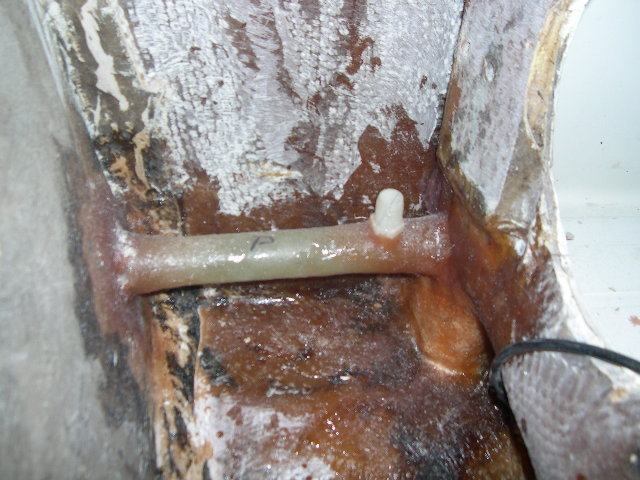

I ordered some 2" ID fiberglass pipe from this website and glassed them in from my cockpit gutters out the transom. very strong, fast shipping, and cheap. Not even my camphor trees can clog them up.
Attached are a couple pics before glassing them in.

I did try that route first, but got nervous about the stress on the tube considering I was altering its circumference strength with adding the rod holder drains to it. Also the flex with the bracket & the motor weight on the transome. The angle also was not right from the gutter config. I wanted the Gemlux Flapper Scuppers which would not work with the solid tube. I hate water in the bilge. You can see what I'm talking about in the picture.
