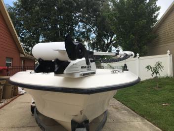

I have the batteries mounted forward under the CC seat. I glassed in a piece of marine plywood that spans the width of the console, anchored battery boxes there along with the breaker and the on board charger. The starting battery is up there too.
The nose on my '73 isn't as clean as yours is. I have a permanent bow light forward of the puck. I pulled off the starboard cleat to allow for the mount of the quick release bracket. It's the one that just leaves a small rectangular puck on the deck when the motor is off. I've always intended on installing pop up cleats set back a bit but, for now, I just come in port side to.😏
The old Riptide you see in the pic requires months of strength training to deploy but comes up easily. We have a newer Terrova on a Javelin that is a piece of cake to deploy. We fish in some decent chop up here in Minnesota and never really felt I was hanging out over the bow bringing the motor back in.

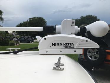

Use a heavy duty “quick release” bracket - use the rubber bushing that come with the motor under the “puck”,when mounting it.

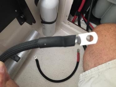

Plugs - the cheap “twist” style will not hold up. Junction blocks are not a bad idea, to avoid the common plug corrosion. Attach and heat shrink seal the connectors on the trolling motor power cord , attach these to the junction blocks below the foredeck. Easy enough to undo, when you want to remove the trolling motor.

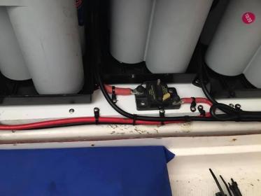

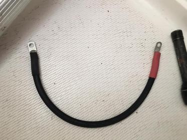

You need to power the trolling motor correctly, do not use a small guage wire for power and ground - the volt drop will be a factor and the amp carrying will to. Use 6g marine grade tinned thru out . “Jump” wires to series the batteries, and power to 70a breaker. Use a quality breaker, not the cheap ones.
Run your cabling in a chafe resistant weave - see attached pics.
Owner of this rig - he opted for orbital batteries,long wait for lithium he wanted to fish.
Note the pic of the cheap breaker ? This boat was factory rigged for a trolling motor. The rigging wasn’t used ! Boat was 2020 and the connectors were not heat shrink sealed, the cabling wicked moisture and the cheap automotive cabling was corrode internally.
That breaker in the picture, it was in the bilge,midship.those breakers fail on a regular basis.use a quality breaker,sized accordingly.

The “jump” cabling - its color coded, this avoids confusion when redoing connections.remember, batteries are “series” connected, to increase voltage

I left a few things out , like the head support , you want one of these, it supports the unit when it’s not deployed. Get it !
Be sure and fuse the heading sensor - I’ve lost count of the I pilots I’ve seen with the heading sensor infused and in the wrong location. The heading sensor needs a clear view of the motor to operate correctly .
