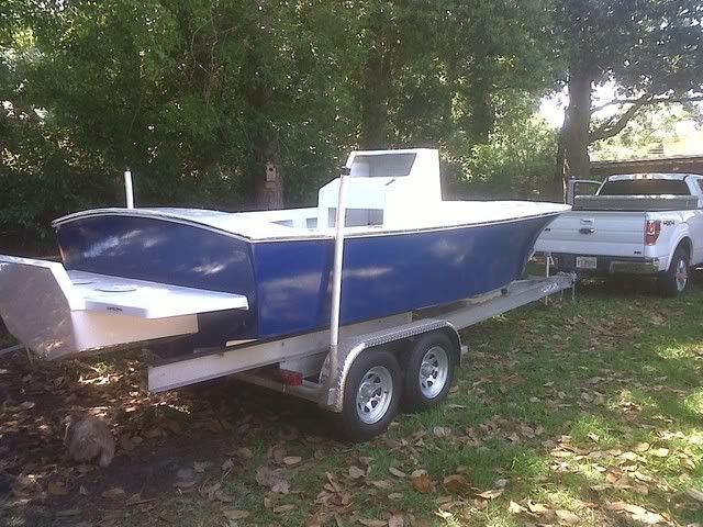

  #210
Old 05-12-2011, 02:38 PM
wtenglish wtenglish is offline
Join Date: Feb 2009
Location: Jacksonville, FL
Posts: 211
Default Re: 1978 SF restoration, my first one.....
For the first time in two years the boat is leaving the backyard! Going for a T Top. Motor and electronics to follow......
