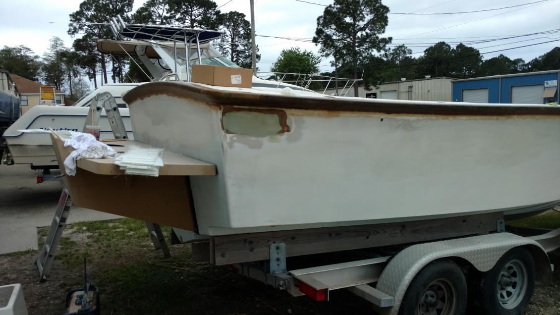

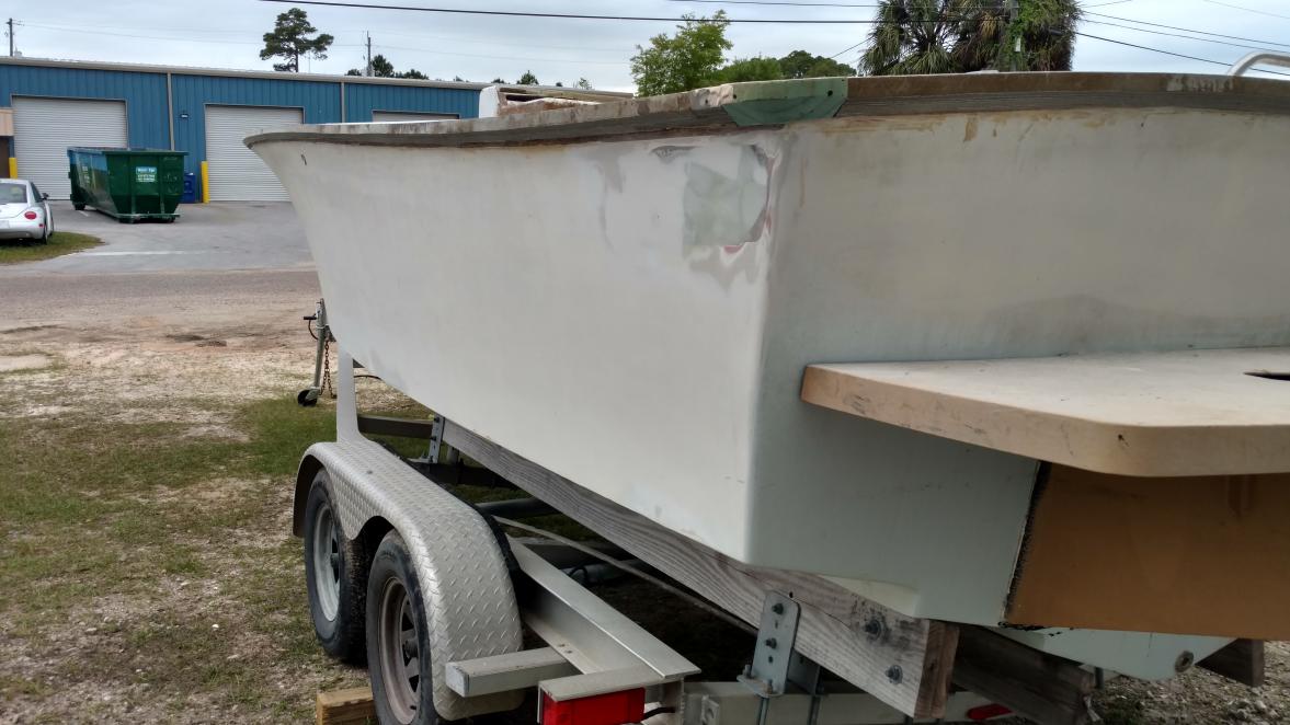

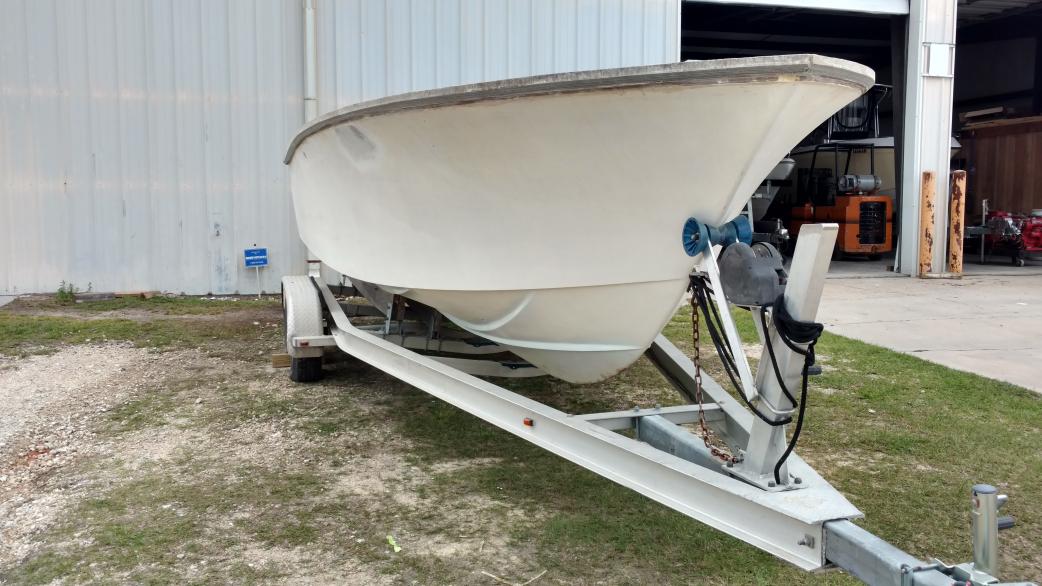

Rubrail ,forward hatch,

starting to look like something there. Cant wait to see it all one color

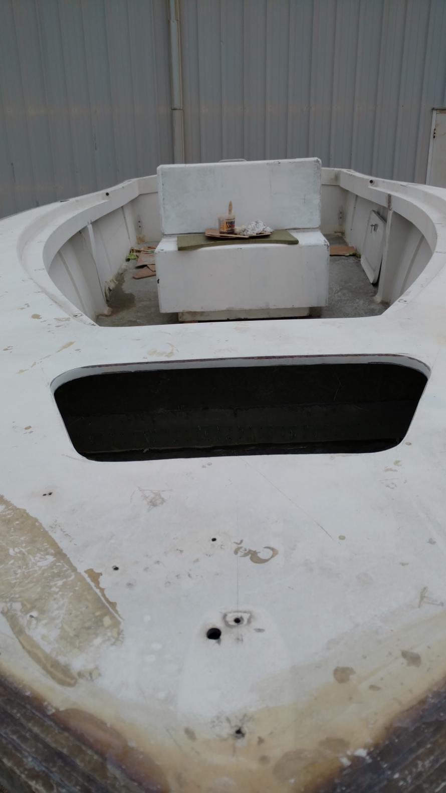

Thanks Frizz. Yea I just ran outta steam. Now.I spend my time with kids and wife fishing ,instead of sanding.. Plus Steve is not playing around. He has pulled the console off now and is customizing the console...hope fully have her rigged by end of summer...

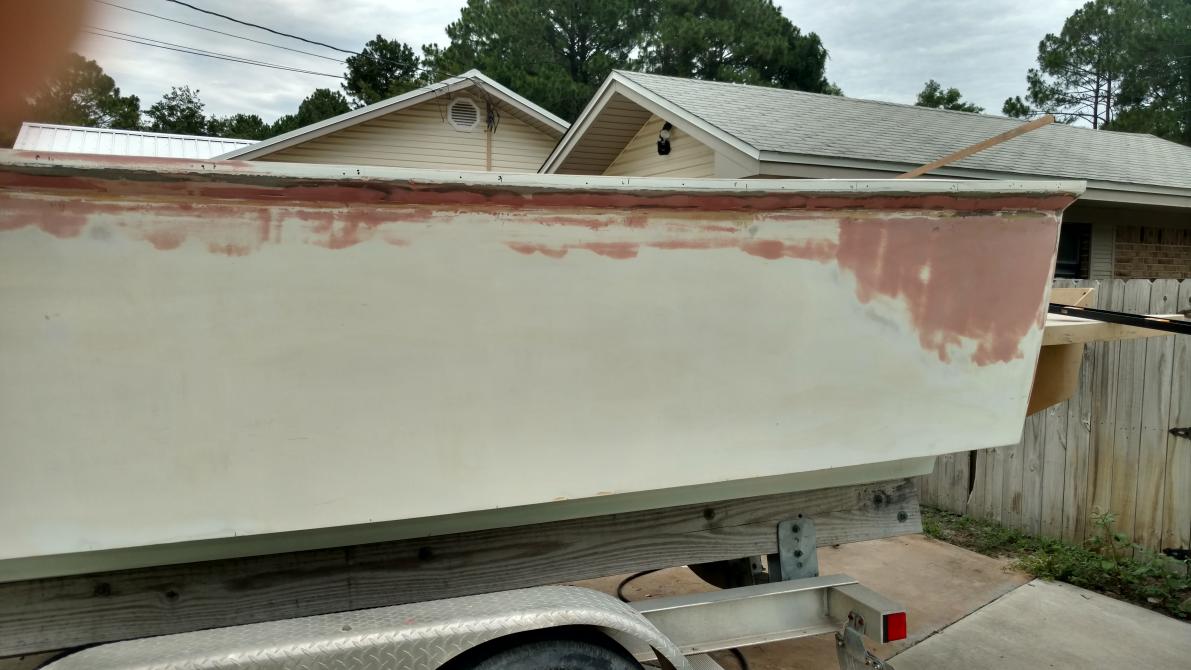

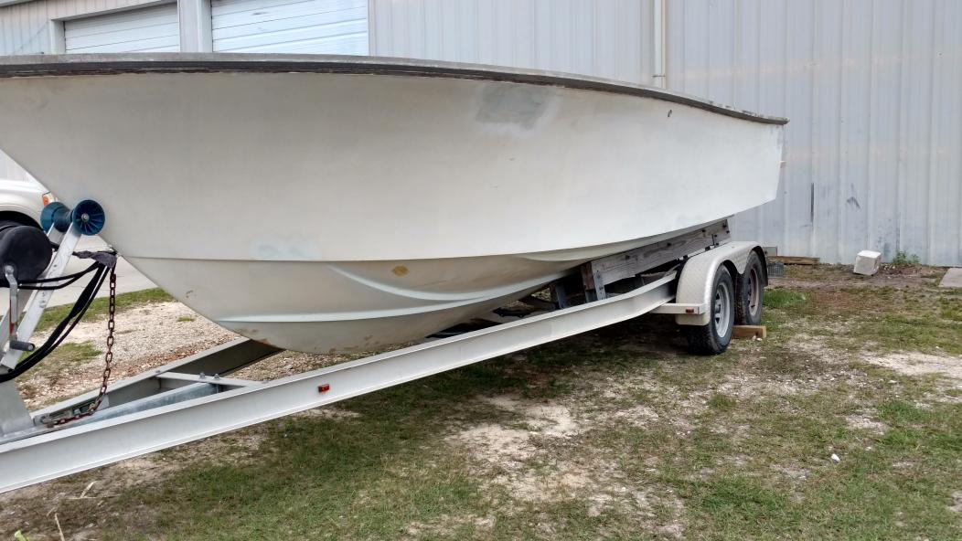

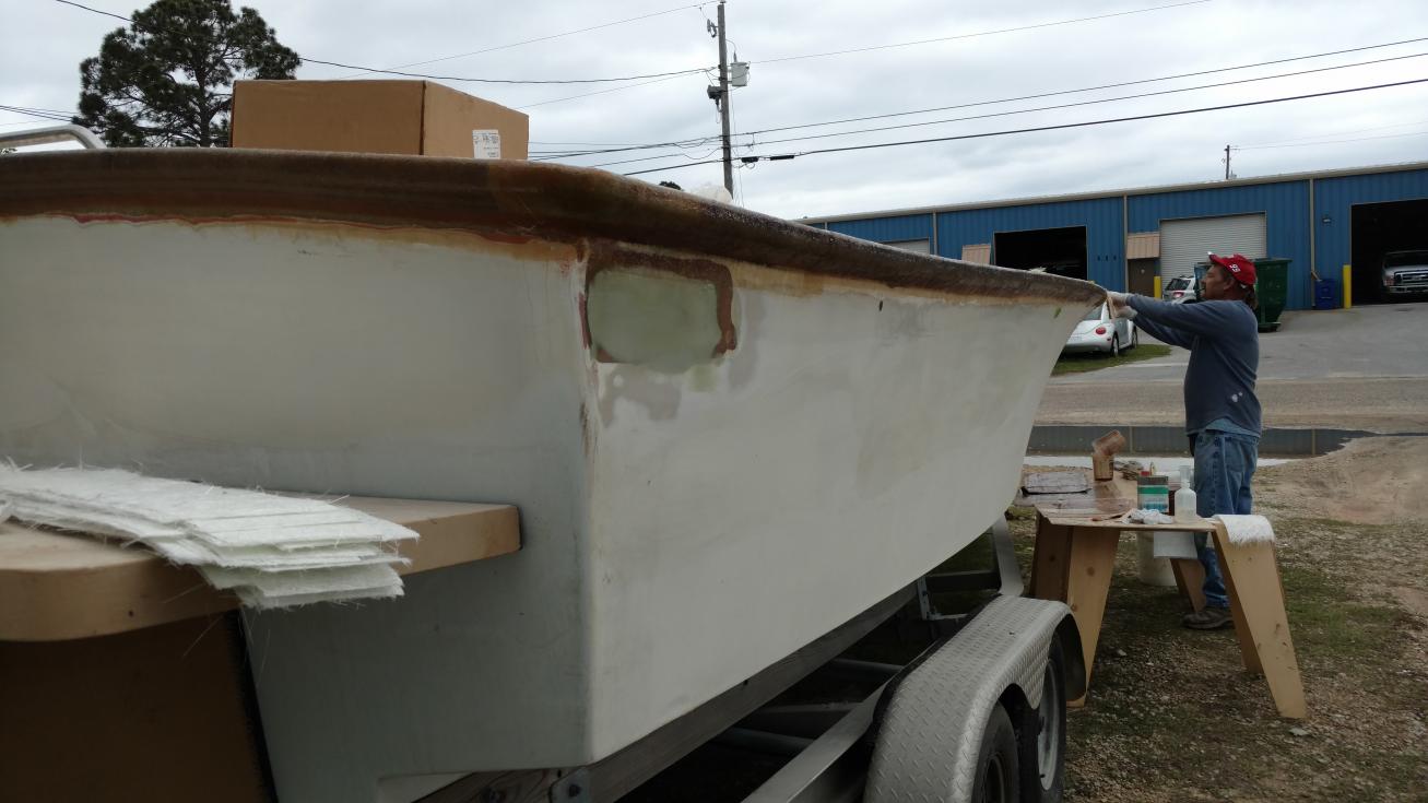

Well the rain stayed for two days. But they were able to get the console out and cut down. Also the rubrail was glassed in today. Should be fair next week I hope to have her done by next week

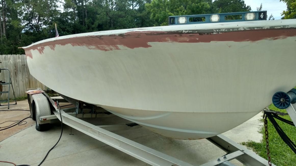

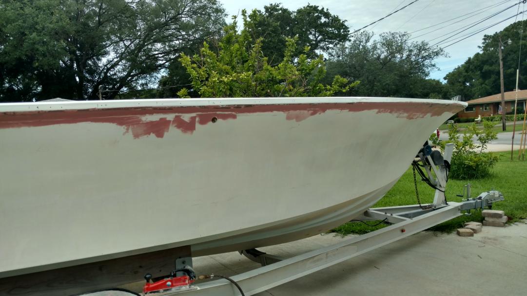

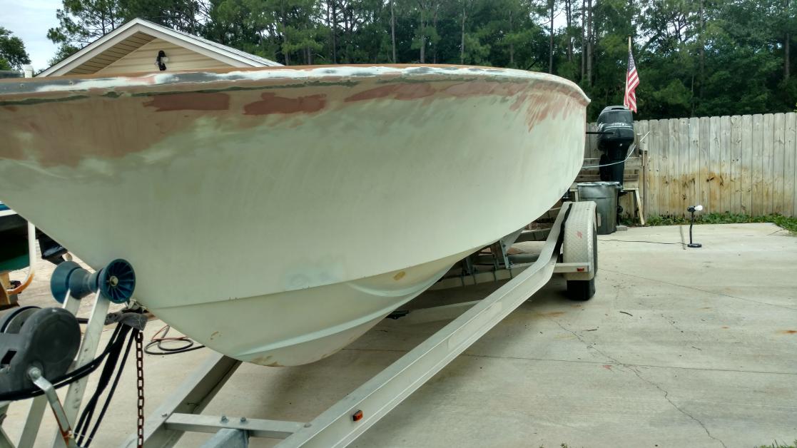

Started faring the rubrail out. Got the port side pretty close. Now to do the starboard side. I measured Frome the chine forward and at the top of the rail. Then I measure From the chine up to the bottom of rail..write that measurement and record..so i can transfer the same numbers to the starboard side... as long as the are within 1/8" I'll be happy...

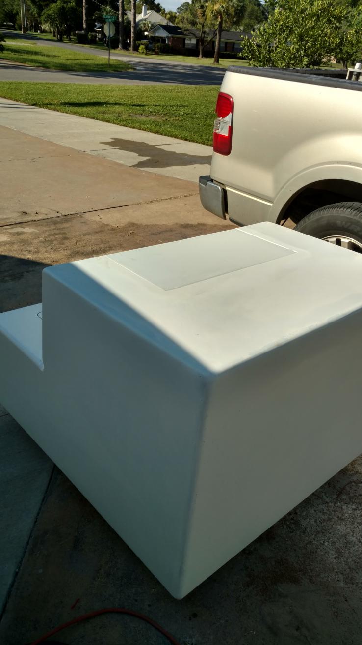

Default Console is primed

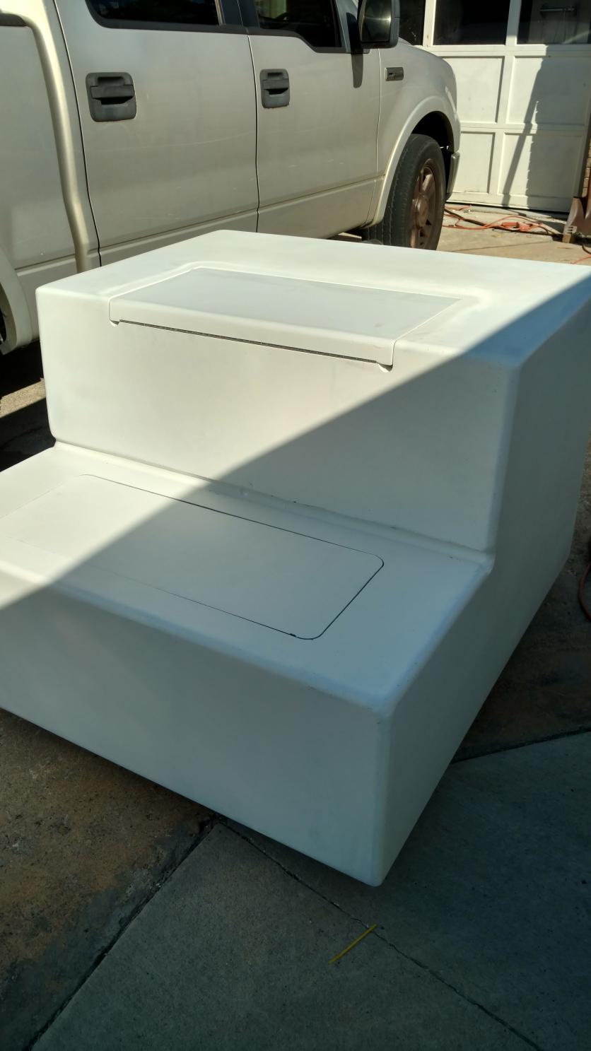

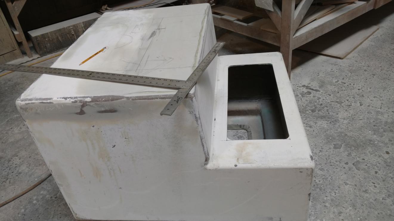

Finally picked up the console..I'm very pleased with the way it turned out...will be picking up a load of mahogany to build the steering pod...
