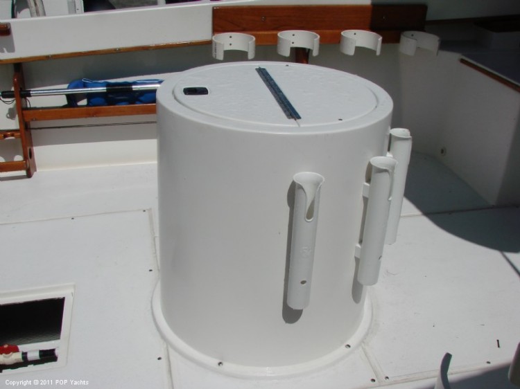

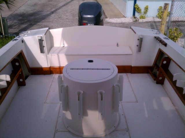

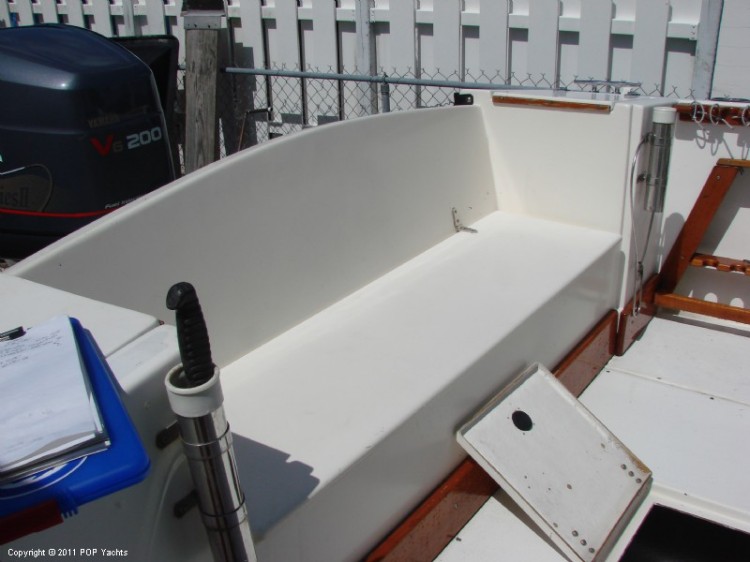

Strick,
Here's a couple of pics of a Tsunami I was eyeballing a while back. May give you some ideas for your 23. Personally, I really like the bench seat in the rear.
John
  #250
Old 02-18-2013, 09:18 PM
I would think it would be pretty LOUD back there. At least when running on a plane...
