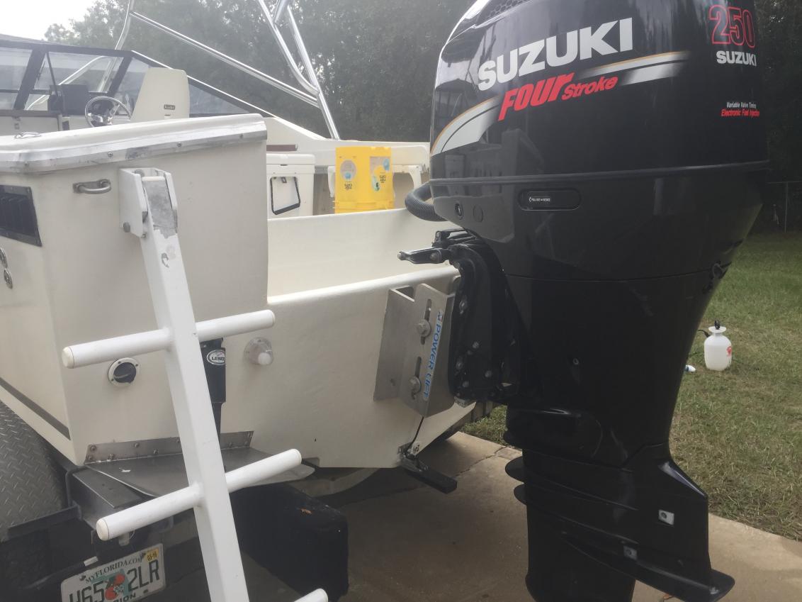

Not as big as it seems in the pic. It's right at 2" in height and 2.5" wide, very hydrodynamic and has proven itself to be no issue in the past. Before my bracket I had a transom mount GT 51 mounted dead center < 10" directly in front of my lower unit with zero effect on performance. Now it is 5 feet in front of it.... not an issue. Think of the fact my motor feeds from off a 5" step 30"+ behind it. With a ramp fronted ducer 26" farther ahead I don't think there will enough turbulence created to be measurable, especially from the keel.
Here is a pic of the previous install I ran for a year with the 250 and after the repower as well.
I'll know for sure after Saturday as she is going offshore for a full day and I will report back.

Thanks for the pictures was wondering if it would interfere with the trailer / or cause turbulence

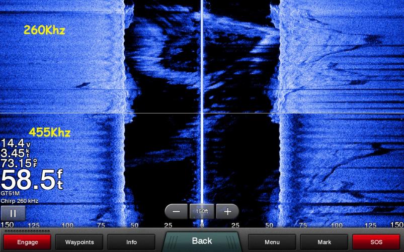

Not an option for this transducer as it functions as a sidescan ducer as well as a traditional medium chirp and down view ducer.
I need the braille setting.
  #259
Old 08-10-2017, 07:54 AM
Looks like images from the Mars Rover !
Show me some Grouper
  #260
Old 08-10-2017, 09:09 AM
