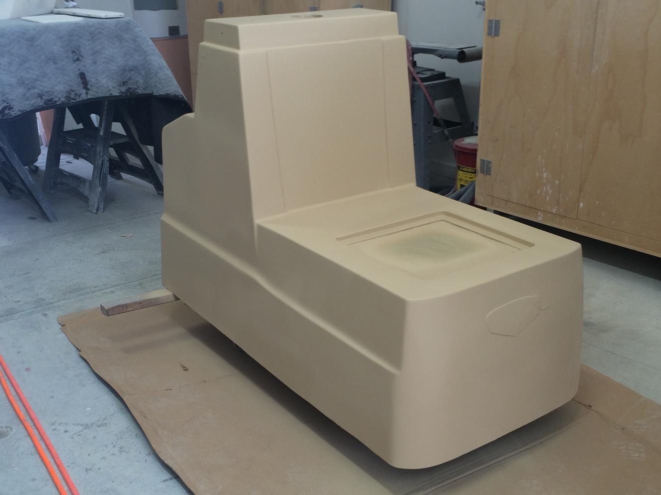

console has been faired and primed

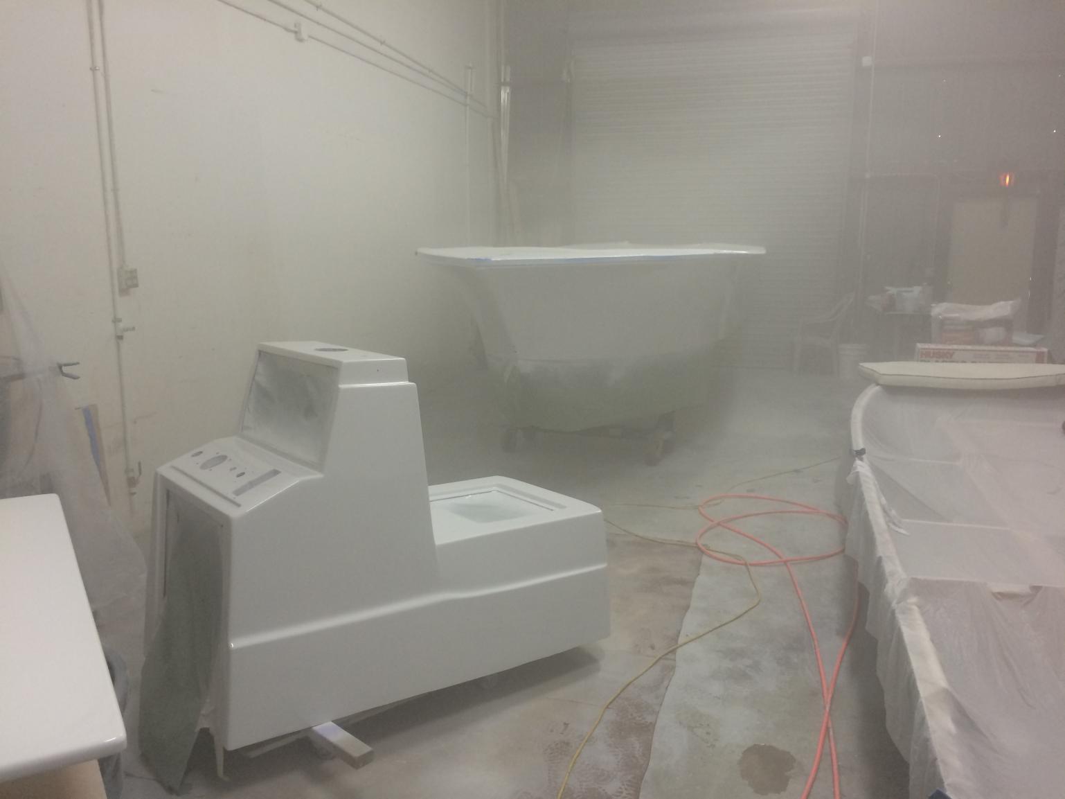

alright the boat had its final sanding and went to paint. First after all the 545 was sanded the boat was sprayed with dykem print fliud in purple to see if there were any imperfections left. after that any small voids were filled primed and then it was time for paint. the boat gets sprayed in different sections. first was the hull, then was the gunnels, then the the inner hullsides along with the console and the engine shroud. the gutter rings are getting done today and non skid on the deck and gunnel cap are tomorrow. in the last pic you can see the engine shroud placement and side profile.
here are some pics enjoy

and a side profile of the hull painted
