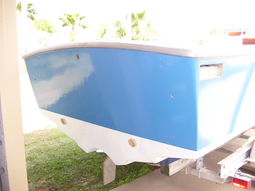

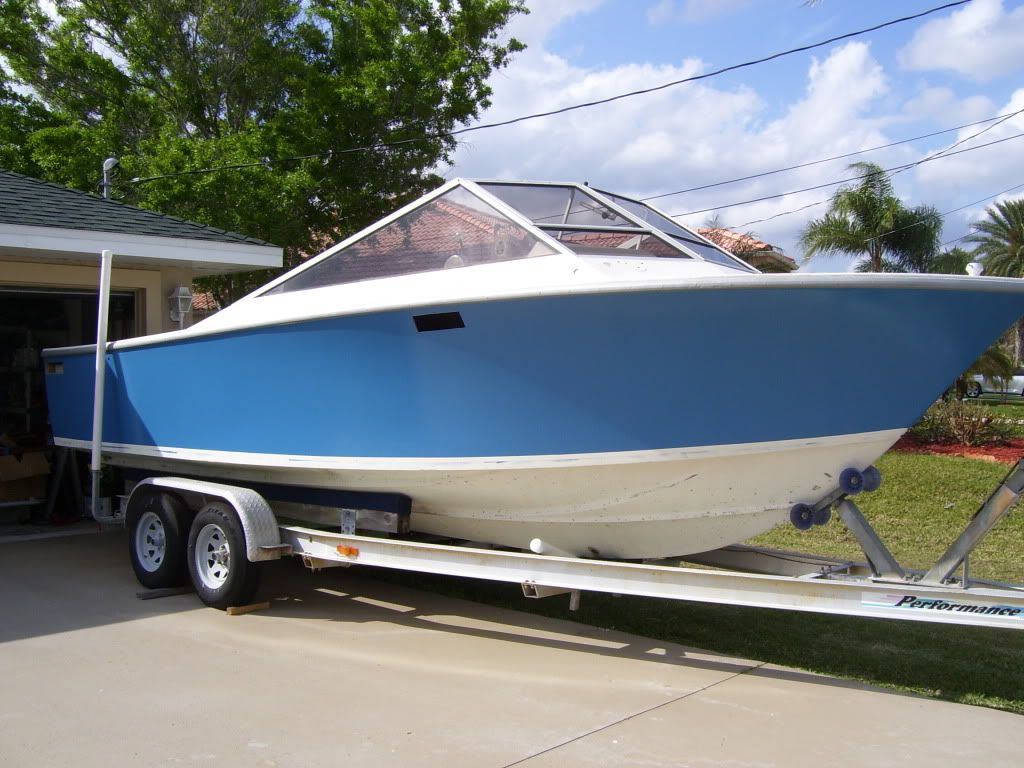

Got the final coat on--2 seems to be the ticket. I used about two quarts of paint. Had to thin it today..guess due to humidity and got a couple of runs in the paint
Some questions for anyone to answer..greatly appreciated
1. Will this Pettit Easypoxy buff out... if needed for imperfections.
If so what grit for wetsanding and type of compound, also what type of buffing bonnett (sponge/wool?)
Also...
2. Can anyone suggest a reasonably priced brand of bottom paint to use for a trailered boat.Wont be in water for extended periods of time... Vivid is out of my budget. I will be using black.
Here are pics..have to touch up below rub rail..my tape job was not too good but turned out ok for Driveway paint job..next is bottom or might jump to topside..to get crap back on boat and out of garage.
-Fred

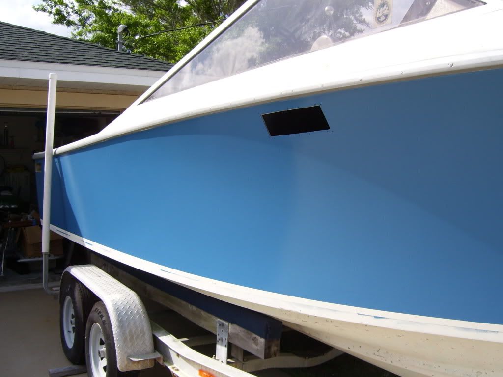

Chuck..I will take you up on your offer. email me with your telephone number at fdheld@bellsouth.net. Hopefully you are available this week after 5:30 PM sometime.(yes I have to work).and can make it up. I am going to call Tom this week for paint prices etc. ..hopefully you can come up and can give me some tips on my hullside finish too..here is my problem..
I have two coats of Easypoxy on hullsides already but I noticed some streaking from roller..mainly in front bow area. Looks ok .(but its bugging me!!)..might sand again and apply third coat..or sand all off (dont really want to!!!)..and bite the bullet and go with Tom's product and three step process Need your opinion when you see it.

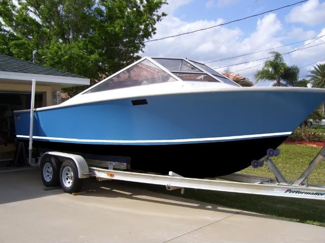

Here is one option for the bottom paint...black with white boot stripe...Any suggestions and ideas etc. appreciated.
I was going to continue the bottom paint top line even from stern to bow to keep in line with bootstripe..instead of having to tape waterline on bow bottom-Fred
