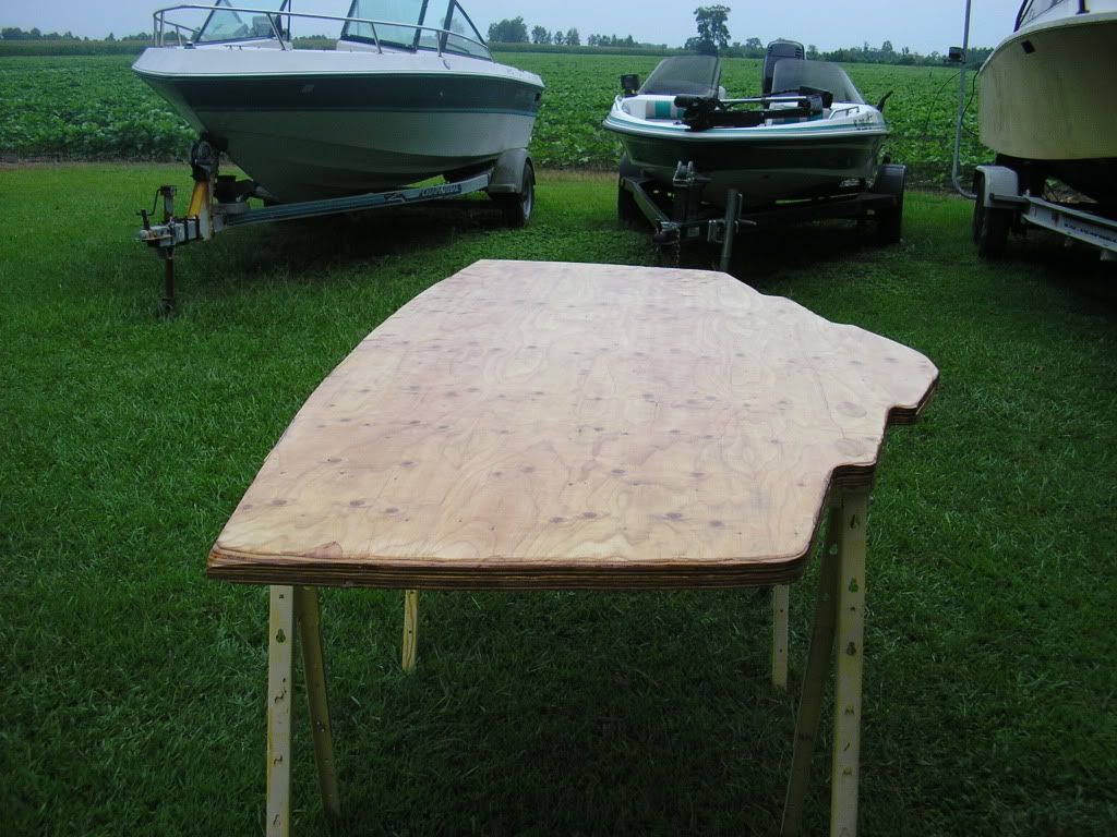

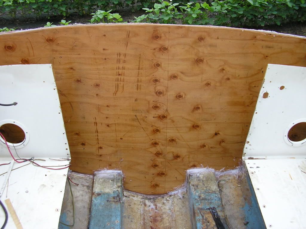

We got the transom core in today, laid on 1 layer of 1708 facing the outer skin and while it was setting up we mixed a bit of cabosil and epoxy and throughly wet the outer skin, set the core in and used the drywall screws to pull the core to the skin....added the weep holes and will start the inside layup sometime next week (hopefully)! Going with 1708, 1.5 oz matt and then another layer of 1708, does this sound reasonable??

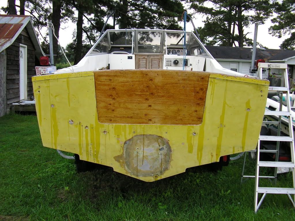

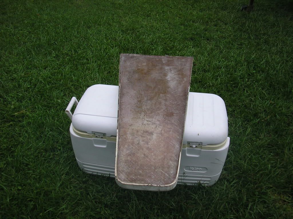

Here are some pics of yesterdays fun....
