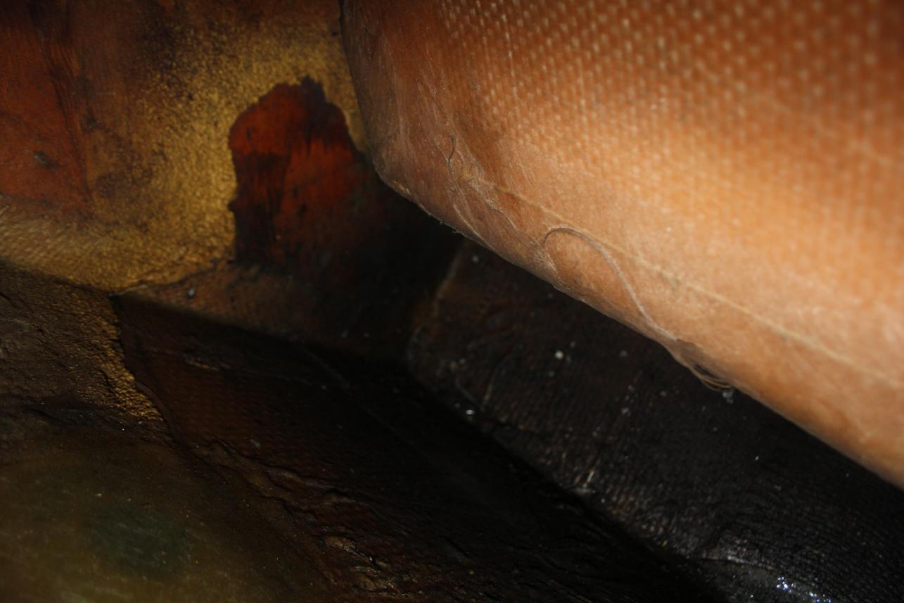

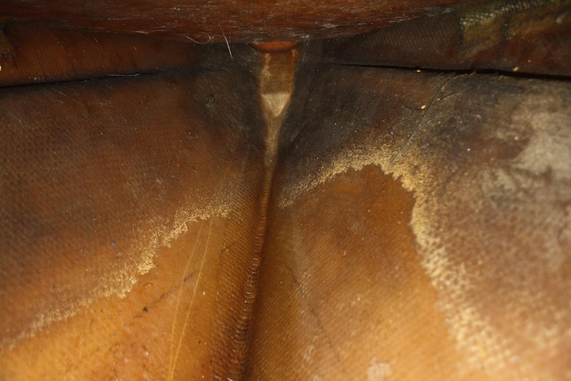

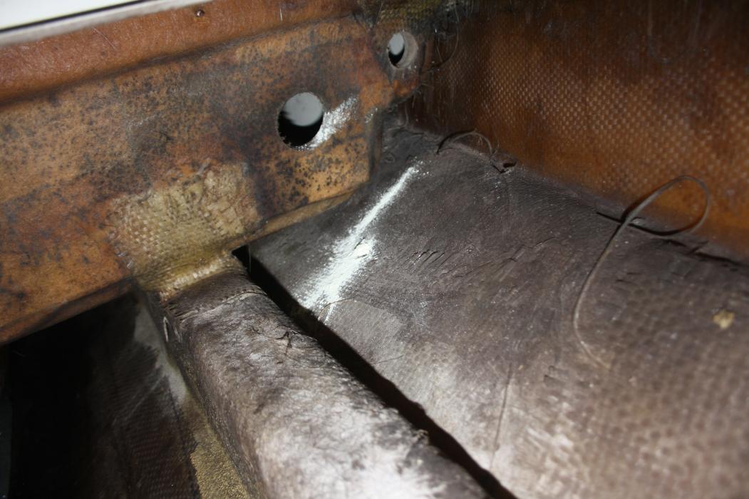

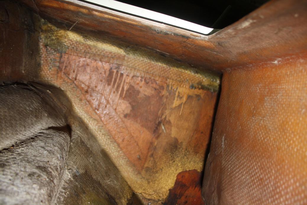

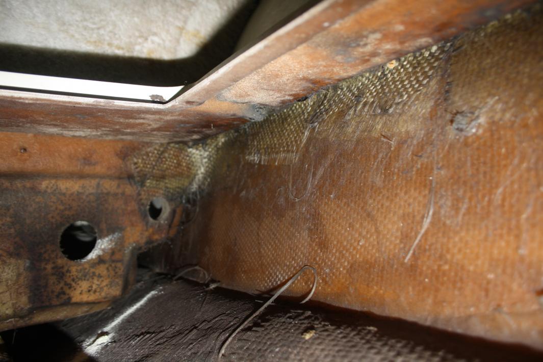

Sounds like I should cut thru the storage bin under the starboard bunk and have a look at mine. It has been a trailer queen for about 10+ years, so I am hoping it is ok so far. The port side looks fine, of course.
A view inside the hull, under the port bunk facing rearward. Then forward and down into the vee, with the last being one compartment forward.

FishStretcher,
I don't see anything in any of those pics that would make me want to start cutting access holes. If you're concerned about the boat's structure, I would do what Connor suggested in your thread, pull the fuel tanks so you can check the bulkheads. I believe Connor had his stringer problem because his bulkheads were no longer supporting them.

4th photo down you can see where someone glassed over the old thru hole. I'd make sure that is sound as well. There is a lot of black in your bilge... Oil? or just dirt? That bulk head for the forward storage compartment looks a little rough on the bottom. May want to make sure that it is not rotten. Although it would be hard to get to that. There should be a drain hole on the bottom of that bulkhead? I'll have to check mine.

In mine, the drain hole in the forward bulkhead was very small and easily plugged. I don't see one in yours at all, needs one. The bulkhead itself looks ok so far, might be a little wet, but no sign of structural problems. You can also access it from the forward hatch under the mattresses, much more access. You might take a battery drill and put a few small holes into the wood at the base of the bulkhead. That will tell you if any rot is present. Just seal'em good when you're done.
Ditto on cutting holes and pulling the tanks. You can get a very good look at the two main bulkheads in the boat. The aft fuel bulkhead is a high probability for rot. Also look very closely at the outside of the hull where the bulkheads meet the inside. Look for hairline cracks that suggest hull stress. If present, they will probably be parallel to the bulkhead.
Did you see any foam in the bottom of the hull under the bunks? Mine was near full and IMHO part of the problem.
