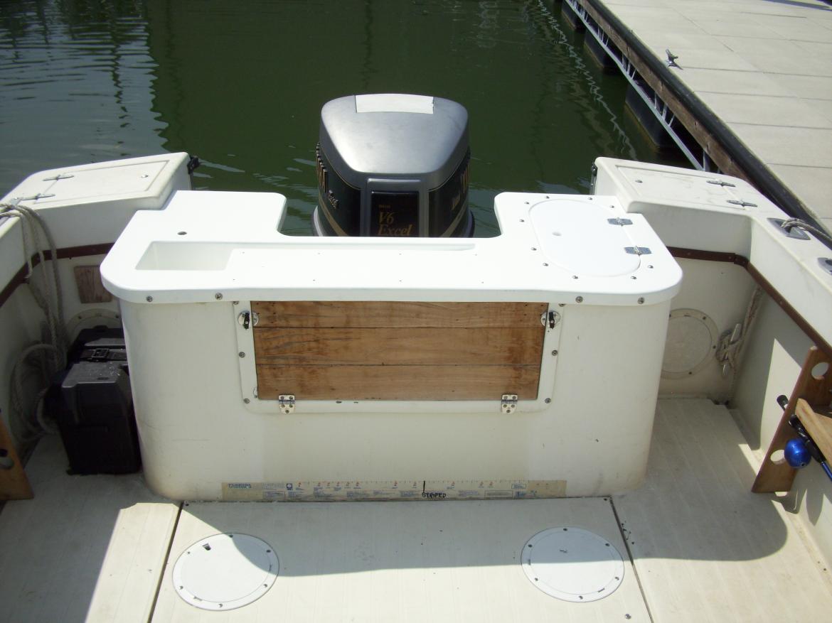

What are your plans for the fishbox in the splashwell since it won't be accessible.
Actually, I designed the size of the livewell to be small enough so that the door/hatch to the large fish well is still accessable(see below pic). The teak door thru the motorwell wall will still be operational too.

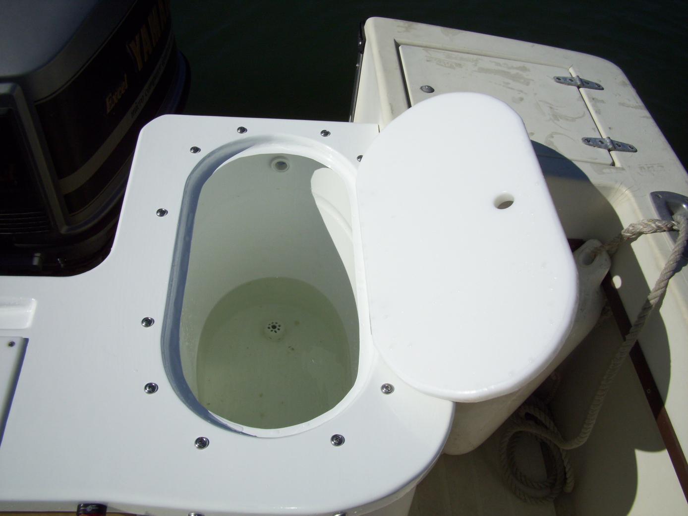

Old 09-21-2011, 11:09 PM
Default Re: Motor well Bait Station 2011
Thanks Boo!
Tonight I completed the door to the livewell and the cutting board. Both are made of textured Starboard. The door is 3/4" and and the cutting board is 1/4". Also added a sprayer in the sink/wash down area. Completion of this project is getting closer and closer.

Old 09-24-2011, 06:08 PM
Final trial, Everything fits nicely. Now just have to put a top coat of paint, screw down the cutting board, and plumb the wash down area.

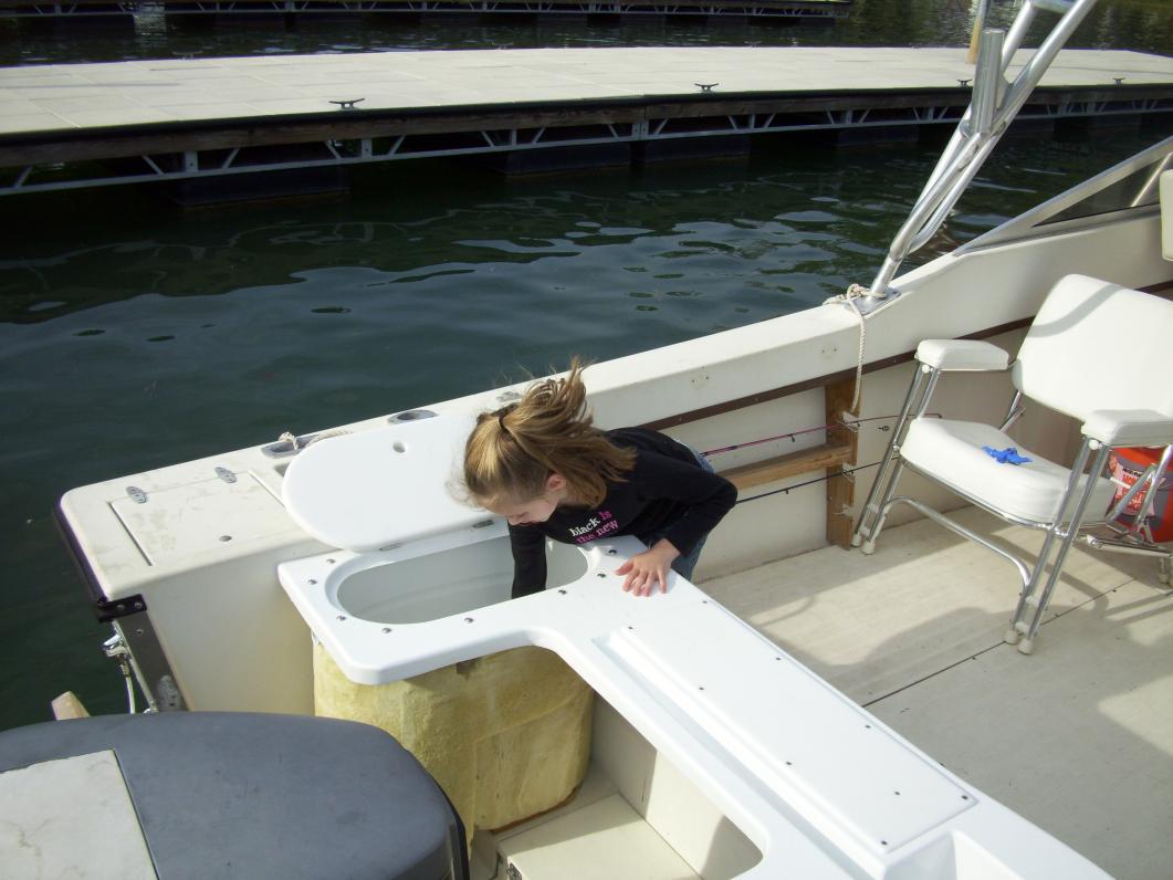

Old 09-24-2011, 11:25 PM
Side view of the Bait Station

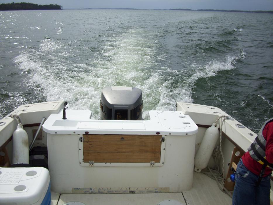

Old 10-01-2011, 02:12 PM
All Done...ready for action!!
  #28
Old 10-09-2011, 08:11 PM
Finally got to try out my custom livewell/bait station today. Worked great, the expandable 2lb foam insulation around the tank keep the live bait (herring) cool and frisky. The kids loved to look at the "bait". Caught a few small striped bass, no keepers though....maybe next time.
