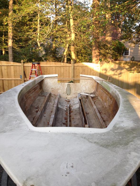

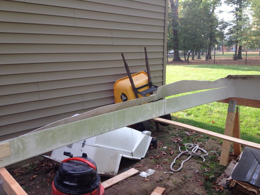

Got some more work done today,

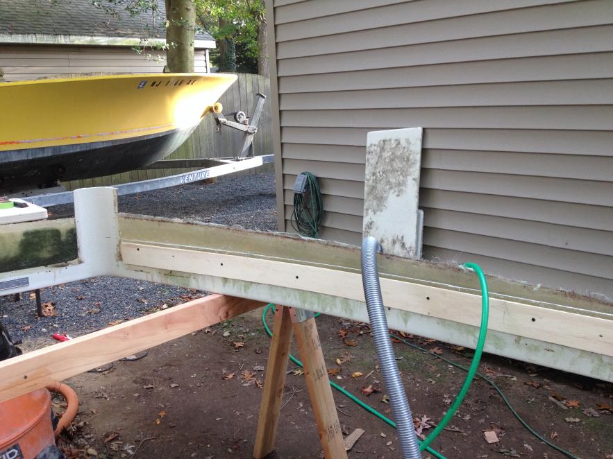

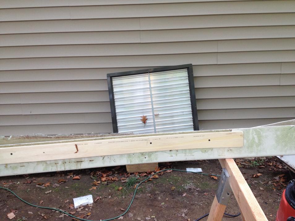

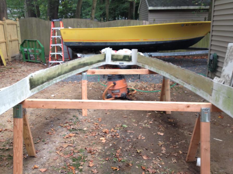

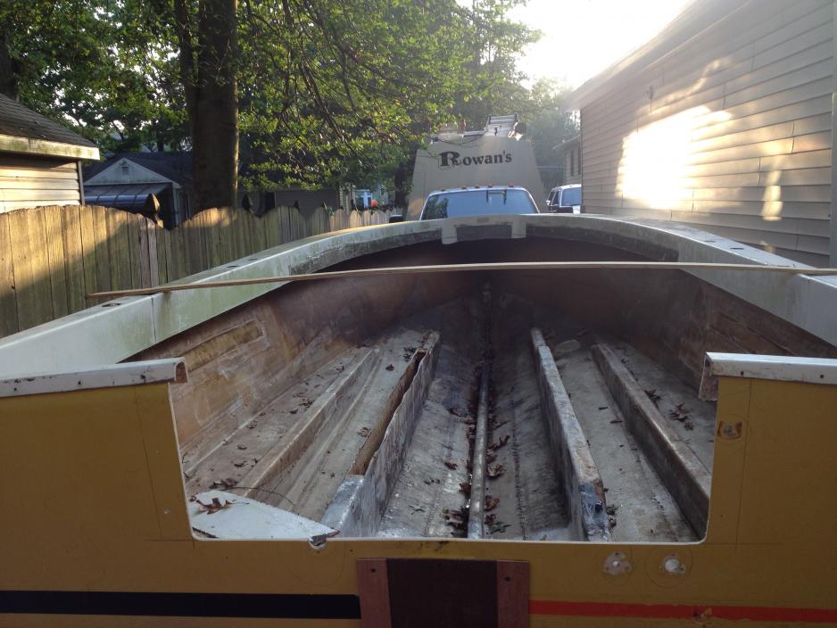

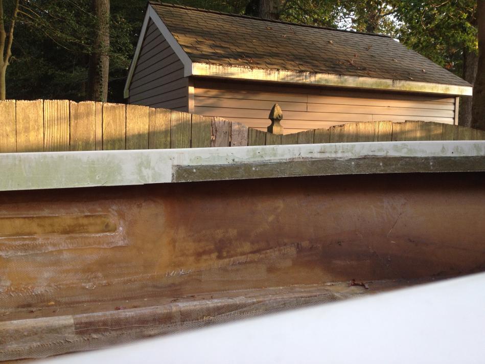

I popped the mdf off the cap and decided to cut the gunnels. I first screwed a straight piece of plywood to the liner a 1/2" down from where the cut would be. I then grabbed my trusty diamond cutter and Fein Vacuum and off I went slicing all the way around except for the bow as I wanted to get it straight and the old anchor locker has a funny angle on it . So I trimmed it close until I am ready.
I lifted it back in the boat by myself which proved to be interesting, I wanted to see how it looked as I still need to core the underside. The hull had spread a little and I had to muscle it into a place.

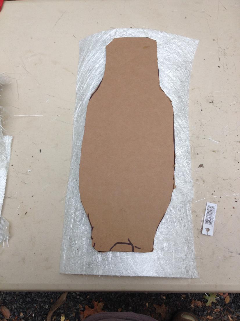

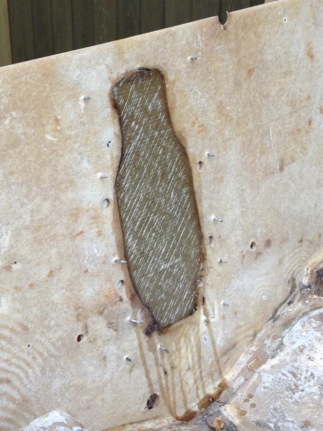

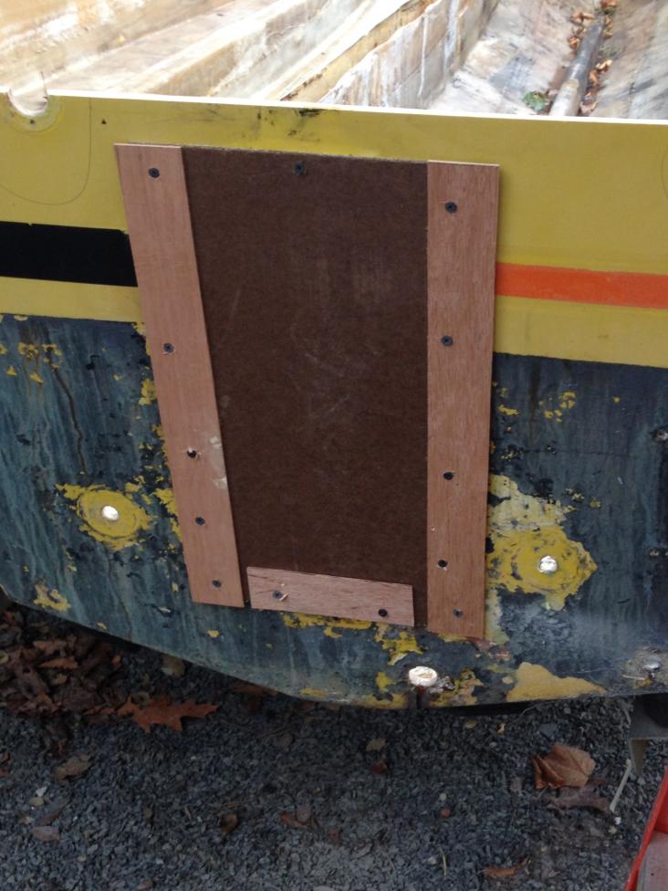

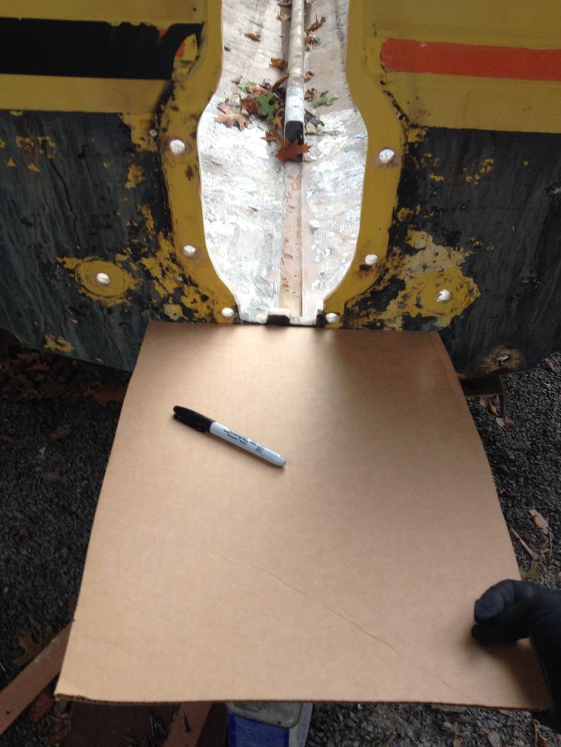

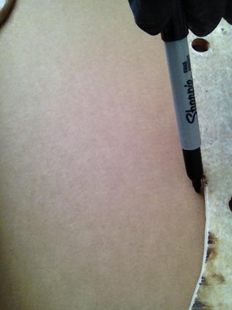

Before I cut the cap I wanted to get some glass in the old outdrive hole. I took the air grinder and cleaned the old hole up and wanted to make a template for the glass, So I took a piece of cardboard and traced the hole to apply it to the fiberglass. I did 2 layers of mat 1 layer of 1708 2 layers of roving mat and 1 last layer if 1708. I cut everything and got it ready. I followed suit as I did with the gunnel cap and screwed some mdf and wood to it to laminate against.

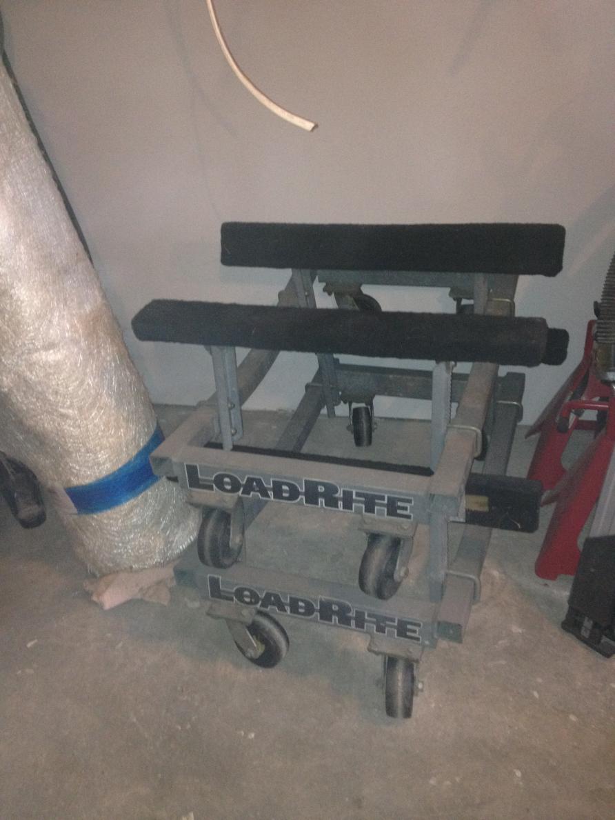

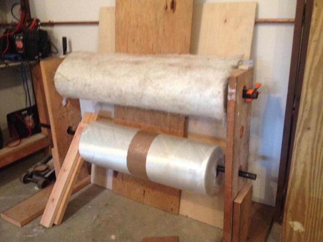

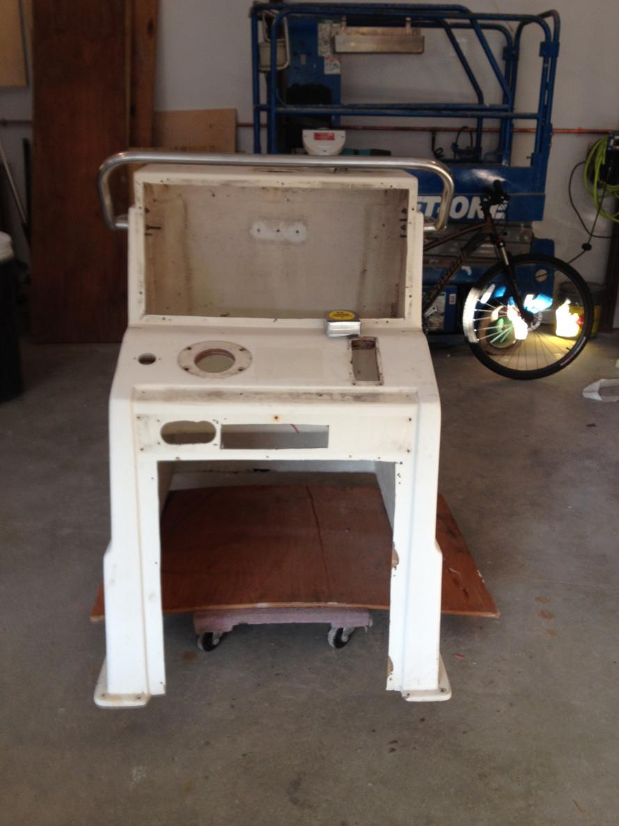

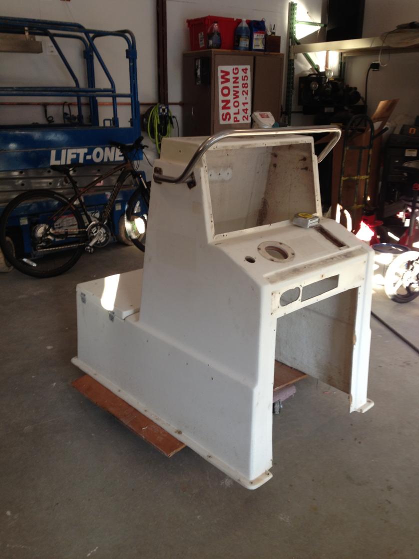

I have been collecting stuff like a hobo over the past 8 months to prep for the project. I got a console out of an 18 that I will lower and add a lefty kreh like coffin box to the front. I got a bunch of fiberglass rolls 1708, 1808, mat and some 38oz stitch mat. I still have some hose, wiring electric connectors left over also. I got a set of load rite dolleys for the garage that I will put the boat in a few weeks.

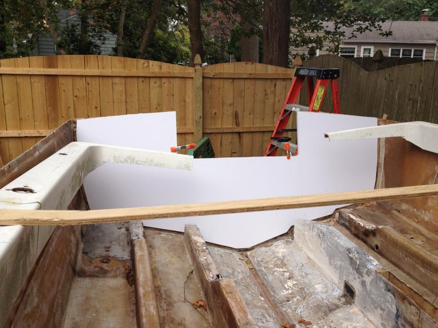

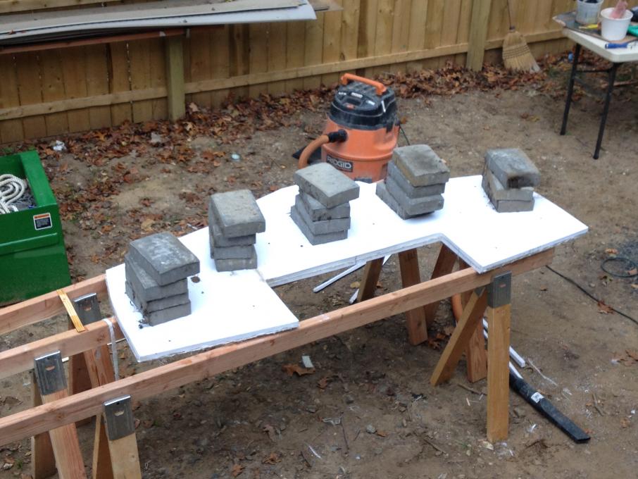

Picked up some material yesterday for the transom and the inner hull. I decided to use a product called Corelite for the transom, It was recommended by a friend who has done a lot of restores in his time. Its about the same weight as Penske or coosa board, But it cuts a lot easier. It looks like Azek and almost cuts like it, but you cant compress it like azek. It is rough on both sides.

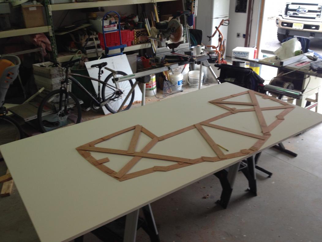

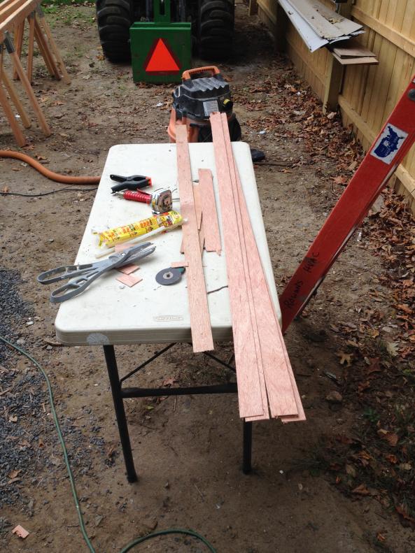

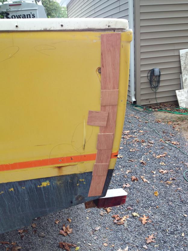

I ripped a pieceof 1/8 Luan down to use as template material, So out came the shears, heat gun and pencil and off I went making a template.

Old 10-19-2013, 09:29 PM
Location: NJ shore
Posts: 485

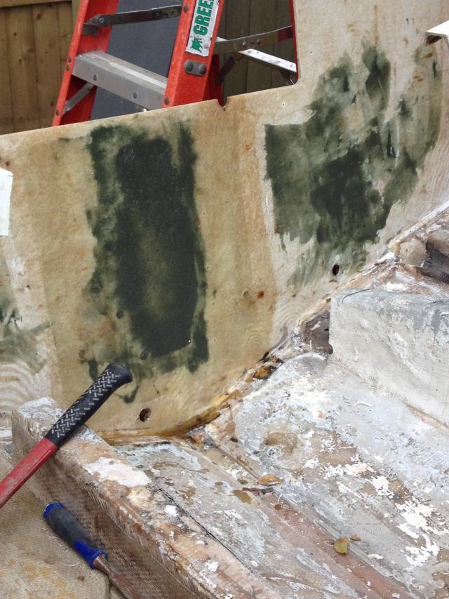

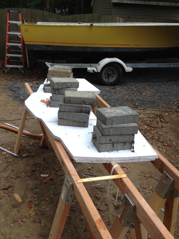

After I dry fitted both pieces, I cut a piece of mat for between both of them, I mixed up some poly and layed it out, dropped the second piece on top and put a couple screws through it to hold. Then I grabbed some weight laying around to samich them together. (samich is from duck dynasty if you don't watch it)
I also grounded down the boogers on outdrive hole and smothered some dynaglass to smooth it out and layed a layer of mat over it to finish it off. I also layed some dynaglass in some of the gouches from removing the transom.
