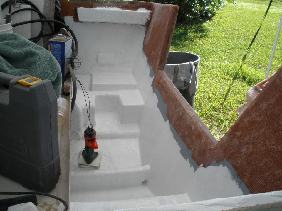

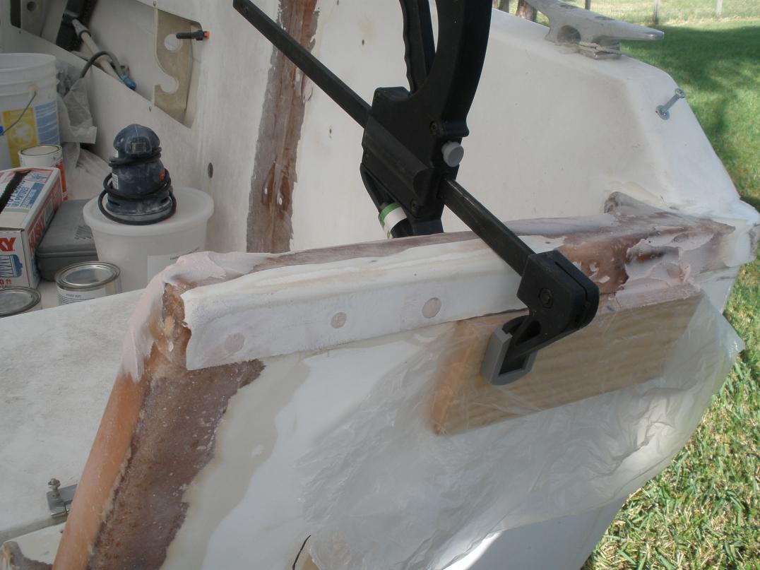

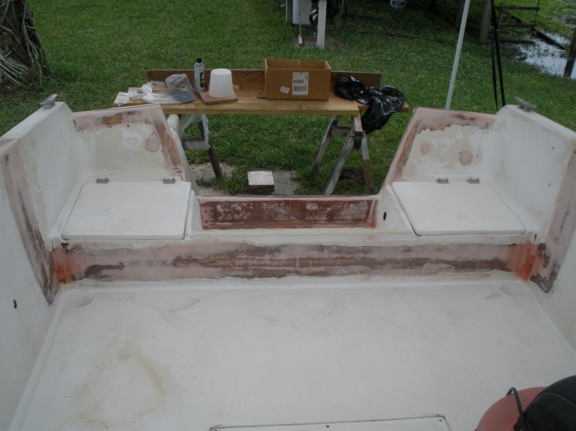

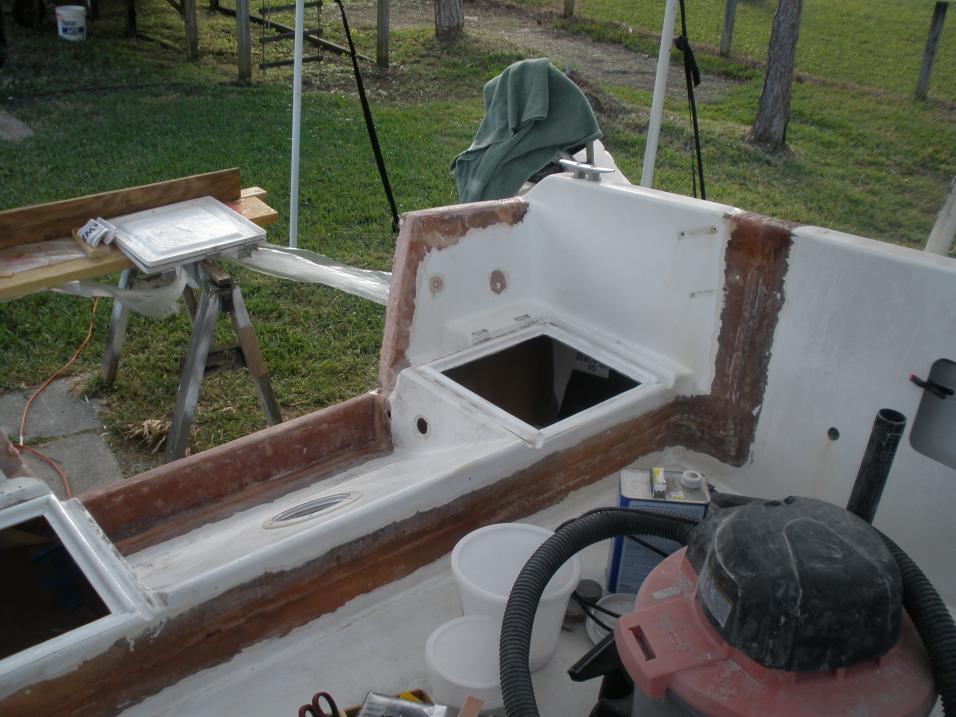

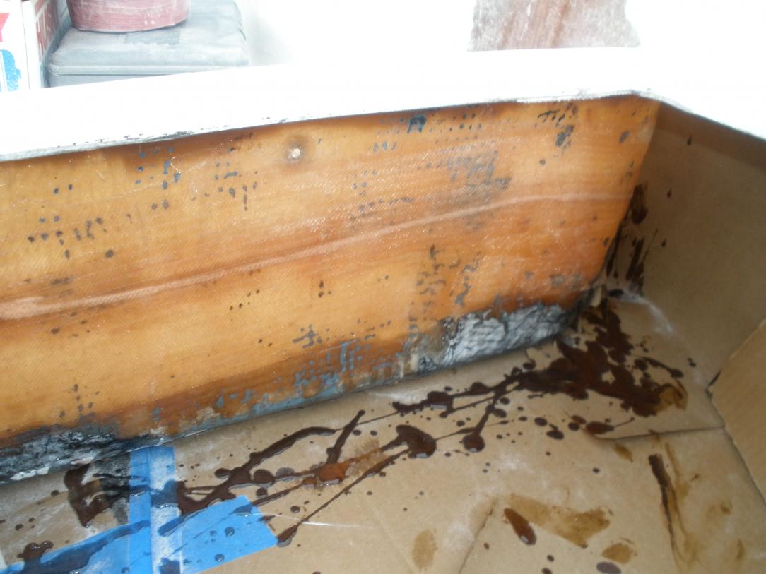

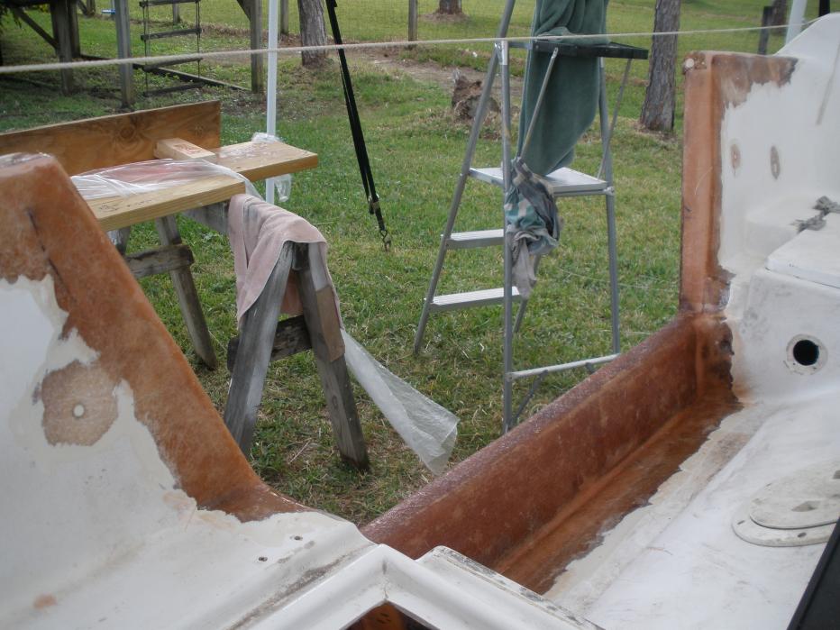

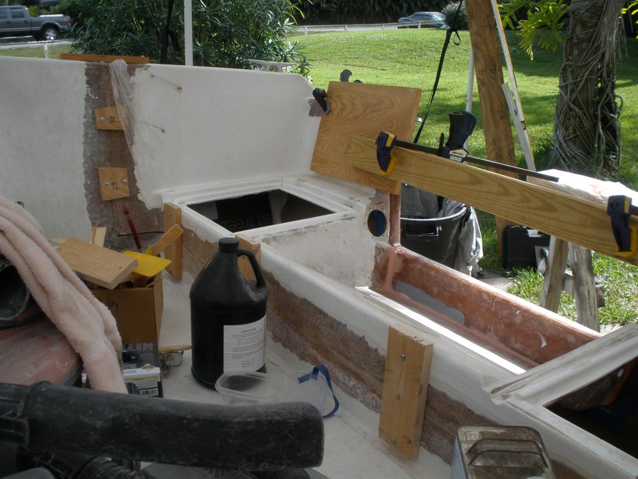

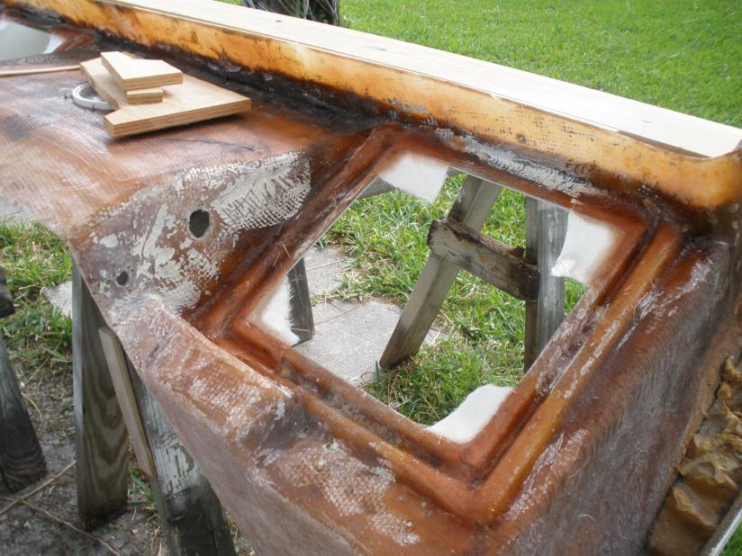

Some progress pictures:
- Fixed some corner cracks on rear hatches
- Glued the vent boxes in with cabosil thickened resin
- Primed with Interlux InterProtect 2000e and topped with Bilgekote
- Glued on cap back sheets to transom with thickened resin
- Added tabbing

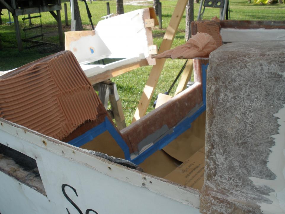

Looking ahead at the fairing and sanding job, anyone have any tips for how to best sand the fillets, especially where three corners come together? Is there a sanding tool with a ball tip?

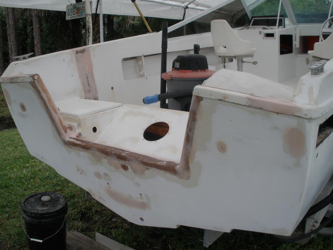

Cap is glassed in, with two layers of 1708 on the backside, and one layer on the exposed side. Started to putty fairing work, and took some time off for Christmas. Getting close.
It may be too late now, but does anyone suggest doing anything to stiffen underneath the motor fasteners? I recently read how some repairs drill large holes in the transom wood prior to laying the fiberglass, fill with thickened resin, then glass over the top to create a stiff cylinder for the bolts to squeeze. I could still do something like this from the outside...

Finally finished the putty /sanding. Day job has been getting in the way.
I've bought Interlux epoxy primer and perfection topside paint. Anyone have an opinion on whether to drill motor mount holes and thru hull drain holes prior to painting? I was thinking I'd prime and paint inside the holes for a little extra protection against water intrusion. If the edges are rounded, I figure the paint will hold.
