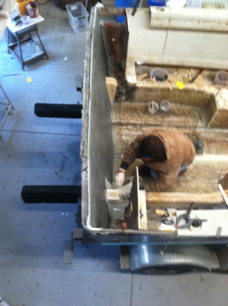

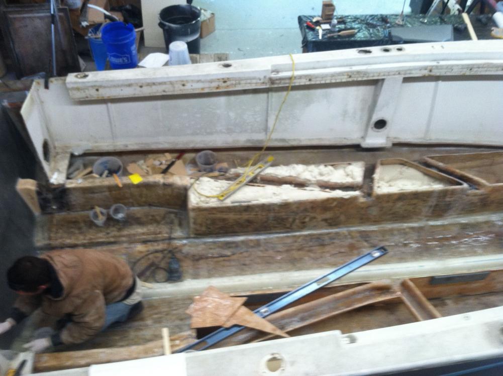

Well I see I did not make pictures of the stringer repair where it went into the transom. Will get some more when I get a moment. Here are two showing Richard glassing in the new nidacore (yellow foam) linking the transom to the old stringer we cut out to remove the transom. He glued together 5 pieces and shaped it with a surefoam file.
He actually did this before he did the pour foam on the stringers. You can see where he brought the glass around in the corners of the transom. The corners (sides) near the transom are pretty shaky, so we beefed them up some with 17 oz glass and epoxy.

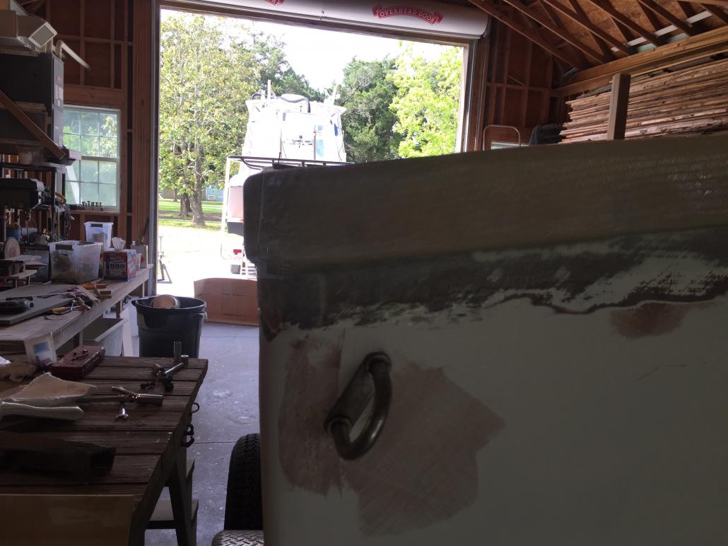

After soda blasting We noticed a few wet areas in the hull based on a moisture meter and we noticed what looked to be many gel coat blisters. We were told that the only sure was to get it dry was to remove the gel coat. Since we were going to bottom paint anyway, we removed the gel coat. It tore up the shop and a month later we still have the dust around.
Two pictures show the after sanding off the gel coat. It turns out we found several damaged areas that we might have missed had we not done it.
Within 2 weeks readings went from as high as 22 down to under 7. We divided the hull up into grids and wrote on the bottom so we could follow the moisture levels.
We will eventually flip, repair, glass/epoxy. Then Interlux barrier coats, topcoat (maybe) and then bottom paint.

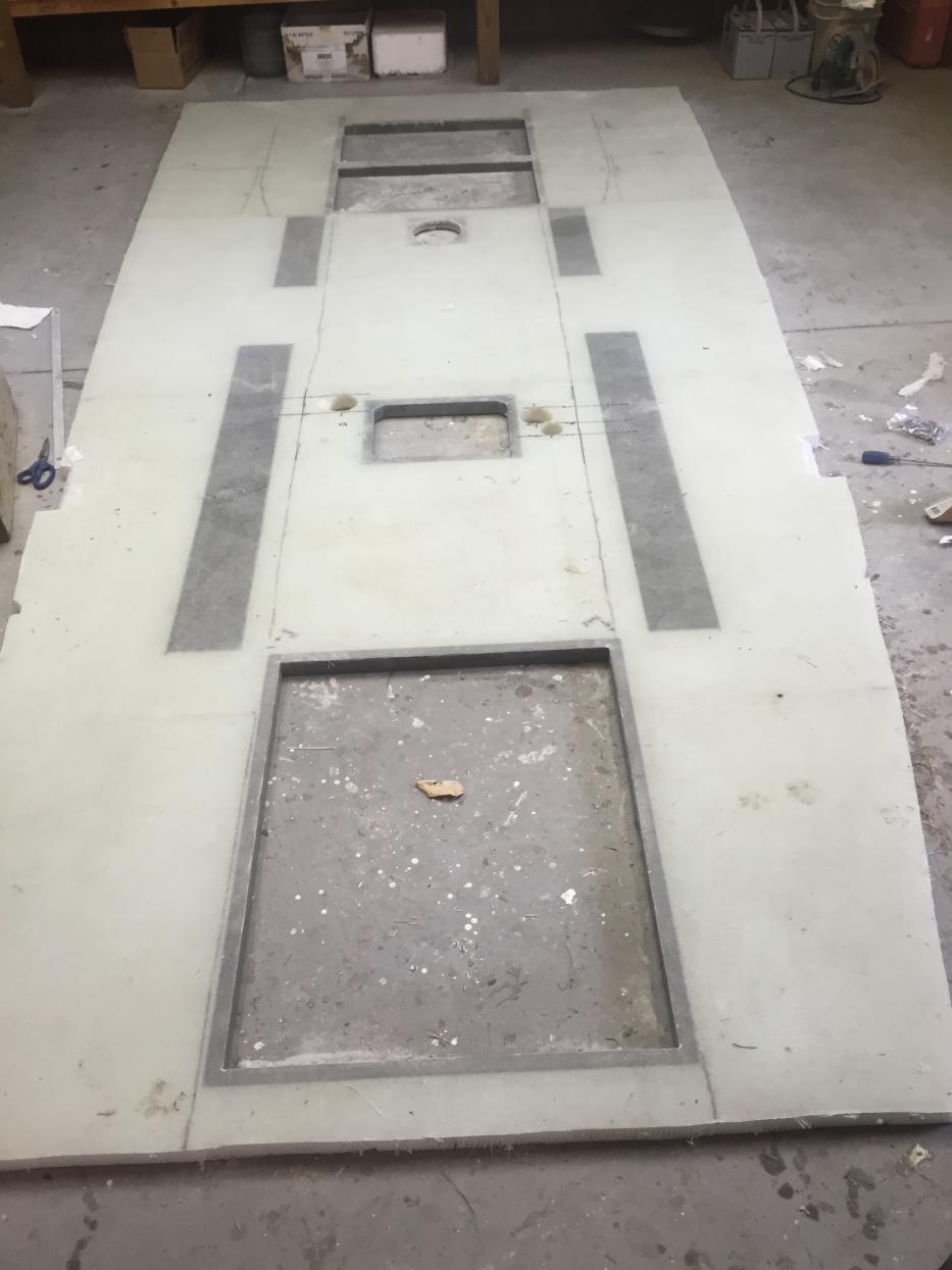

Honeycomb deck construction. Using advice from Bill at Lightning Yachts (who has been such a great help and source of advice) we made the deck from 1.5 inch Plascore and Coosa.
Shown is the bottom of the deck after two layers of 17 oz cloth. The Coosa shows where the hatches are going and or reinforcements for console/T Top and leaning post. We are going to put in SS T nuts to hold T top.

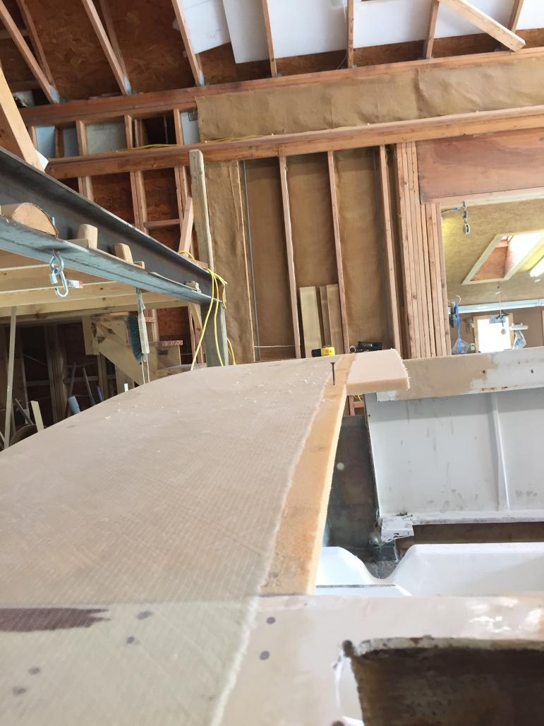

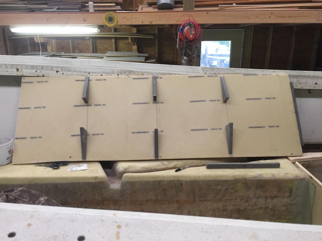

Stern construction was using 3/4 H80 Divinycell. Before I cut the old transom, I made a story board to replicate the curve. That is what we used to cut the top of the coosa transom. In the first picture you can see the story board held up. Well to get the front of the transom right, we cut the ends off the storyboard and temporarily mounted it at the front of the foam. We screwed it down and voila, it was perfect. Sorry to say I did not think of that myself, but ingenious Richard did it. Very intuitive guy.
