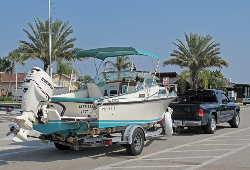

One other thing improper support on a trailer will cause this too, specially with a bracket hanging in the wind.....
You're right - the vertical "G" loads when the trailer hits a bump can be significant way back there! I use a "transom saver" to support motor from aft keel roller on trailer if I'm gonna trailer the boat very far..

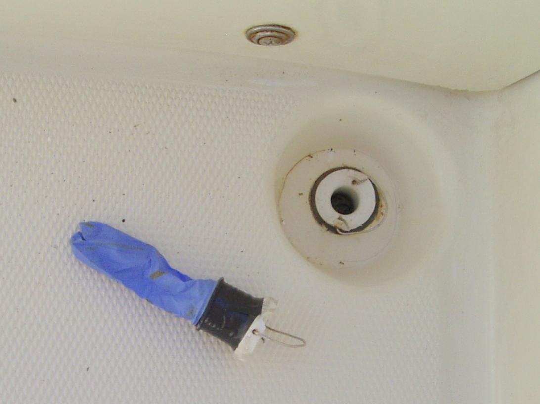

Regarding your scupper position relative to waterline with a Hermco bracket. there's no way to predict that unless we know what you currently have on there, so post some pictures of it! (How much setback do you have and what is submerged volume of the flotation tank, if any?) All I can tell you is that on my Seafari shown below with original deck and transom, the waterline sitting at the dock is just below the bootstripe, which is about 5.5" above the chine at the transom, measured vertically. Now the Seafari has more weight forward than most CC models, unless you've moved your console, batteries, gas tank, etc., so it's a little more tolerant of heavy motors. It's just barely self bailing at the dock, with the waterline just below deck level. I normally just leave the plugs in or use Forum Member Fellowship's "Vortex" PVC check valve invention (last pic below) when diving when the deck's gonna be wet anyway.
