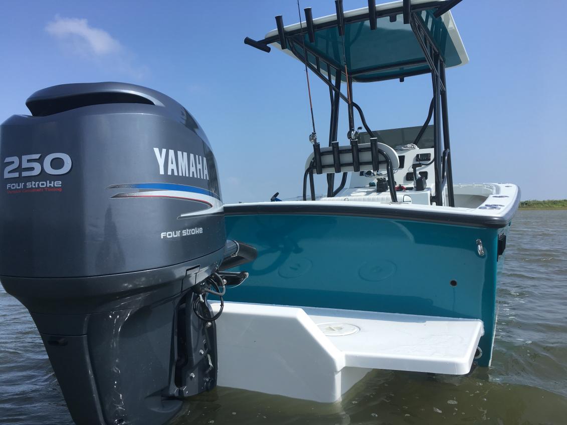

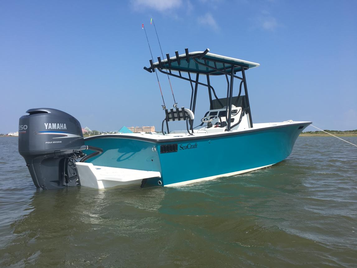

45 hrs since re-fit. Cruising at 26 kts fuel flow is approximately 12 gph. Top Speed is knocking on 42 kts. Low speed handling is outstanding also. I am very happy with the old SC's ride and performance.

Sweeeeet!!! I like the matching color under the top. VERY nice looking boat!

Beautiful!!

This is a beautiful setup. What company made that storage/access for the stern?

Beaut what part of Texas coast?

that came out great , I saw that boat in Signatures shop when he was into it..was hoping to see it when it was all finished...thanks for posting , enjoy and good luck with her

Nice boat! How did you reinforce the console at the base for the t top?

Sorry guys, I have been engrossed in a frame off restoration of a 1976 F 350 Ford to tow the SC with and have not been on the SC forum lately.
The tackle drawer system was custom built to my specs by Boat Outfitters in Orlando. I had to pay the design and engineering fees. They still have that on file so if you wanted one it would probably be less $$ now without the added design fees.
The console is fastened to the Deck with a lot of #14x1.5" screws and 5200. The T top attachment points were beefed up with glassed in marine plywood doublers.
T Top only weighs a little over 100 lbs.
I am located in Galveston, TX for the gentleman who ask back in April. Sorry for the delay in response.
