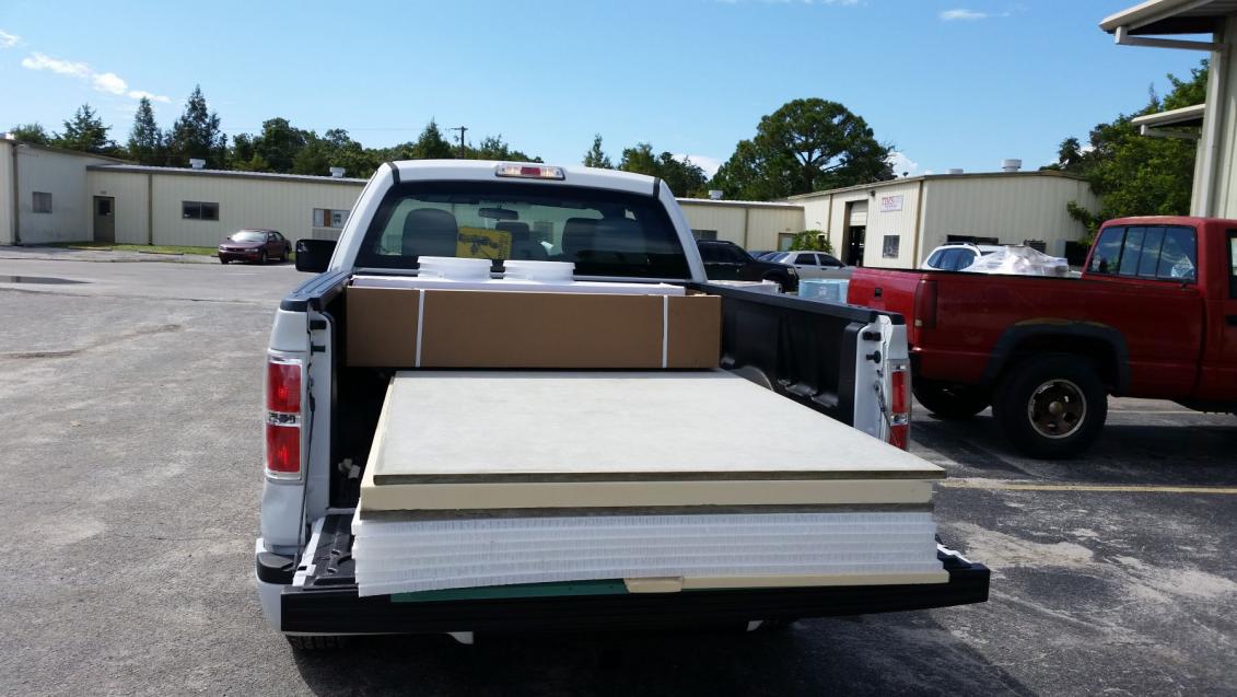

Chose to go with Fiber Lay in Sarasota. Ryan, my contact has been a great help.
Was a bit disturbed when I arrived to pick up the order, had condemned all pieces 3 hrs. be4 arrival and nothing was picked and ready to load. Looks like they are under staffed.
Total order: 2 cossa 26, 6 nida, 1-2" foam, 1 divinicell and 1-1" foam. All the boards are 3/4" for mix and mathch reasons. The 1" foam was at near their cost because it was damaged. Also on the load was peel-ply, 2-#5 iso resin, 1700 and csm rolls. A bunch of miss. stuff like mek cabosill etc. and a few tools.
Bottom line-----still happy, Ryan kicked it up a notch and likely $1000 off retail ____ don't have time to do the math.

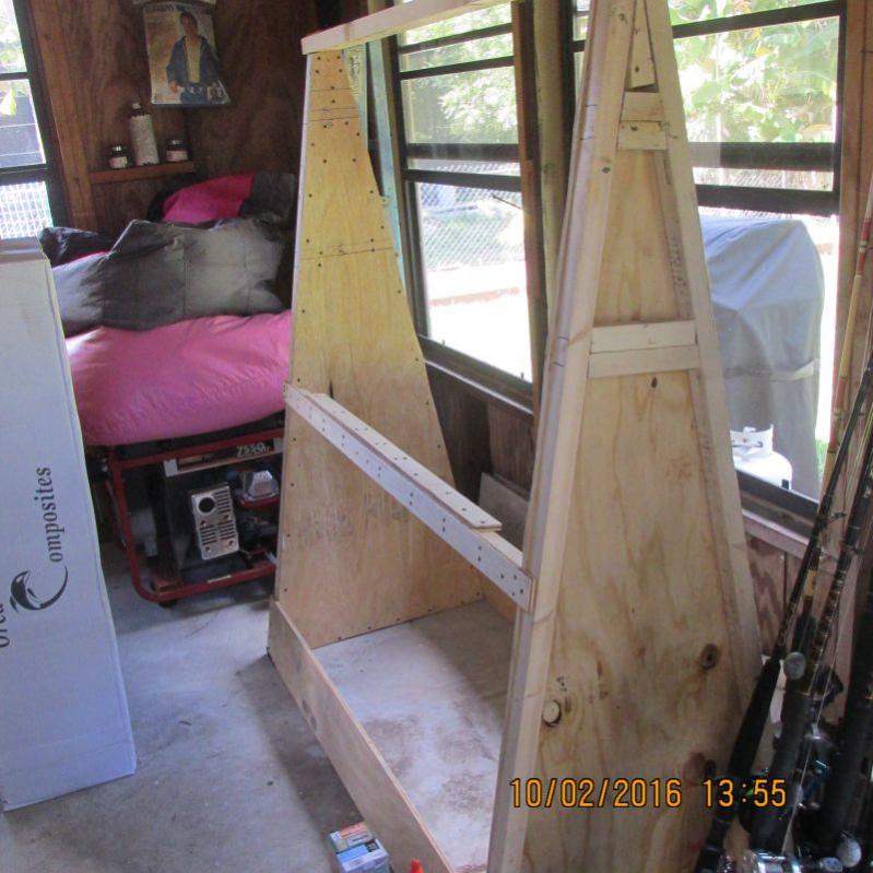

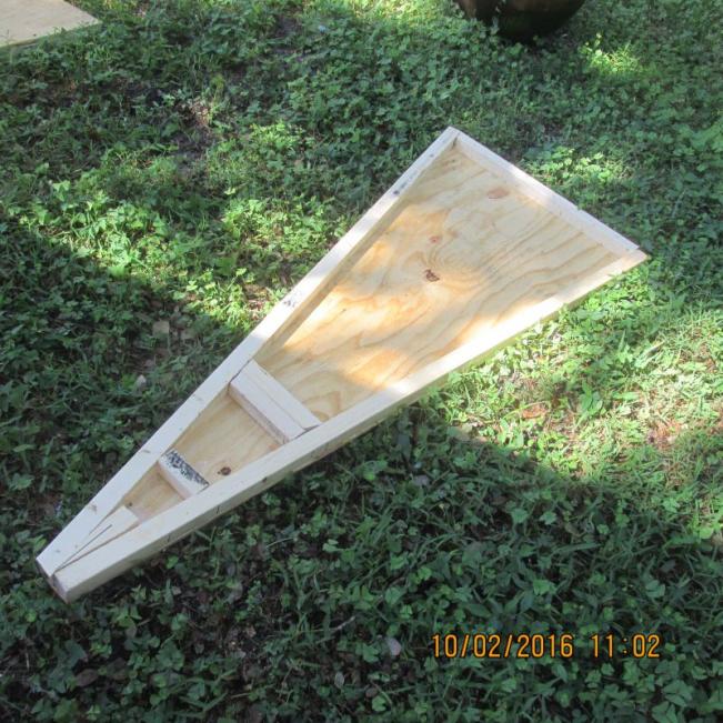

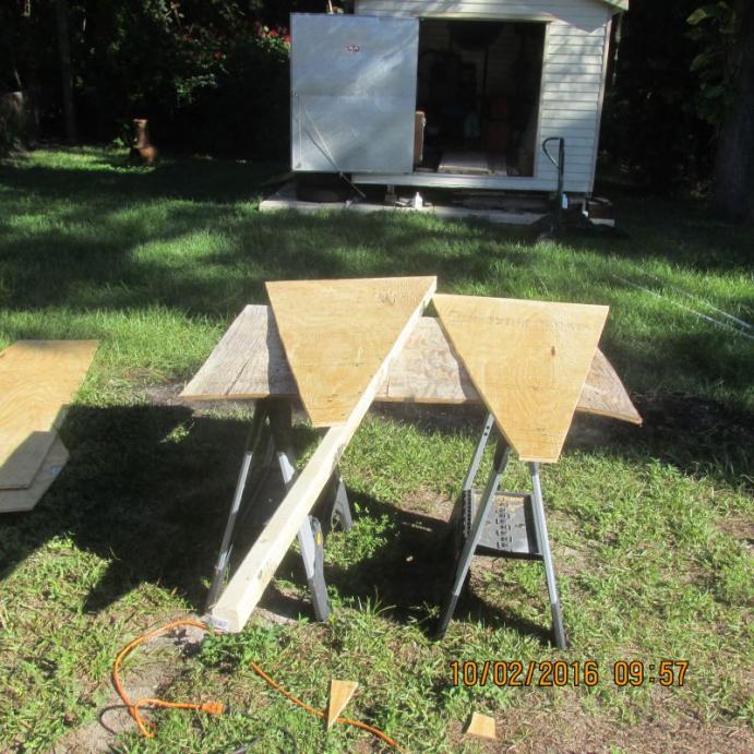

Got most of the cloth dispenser done. Just need to install the feet and PVC to hold the roles.
