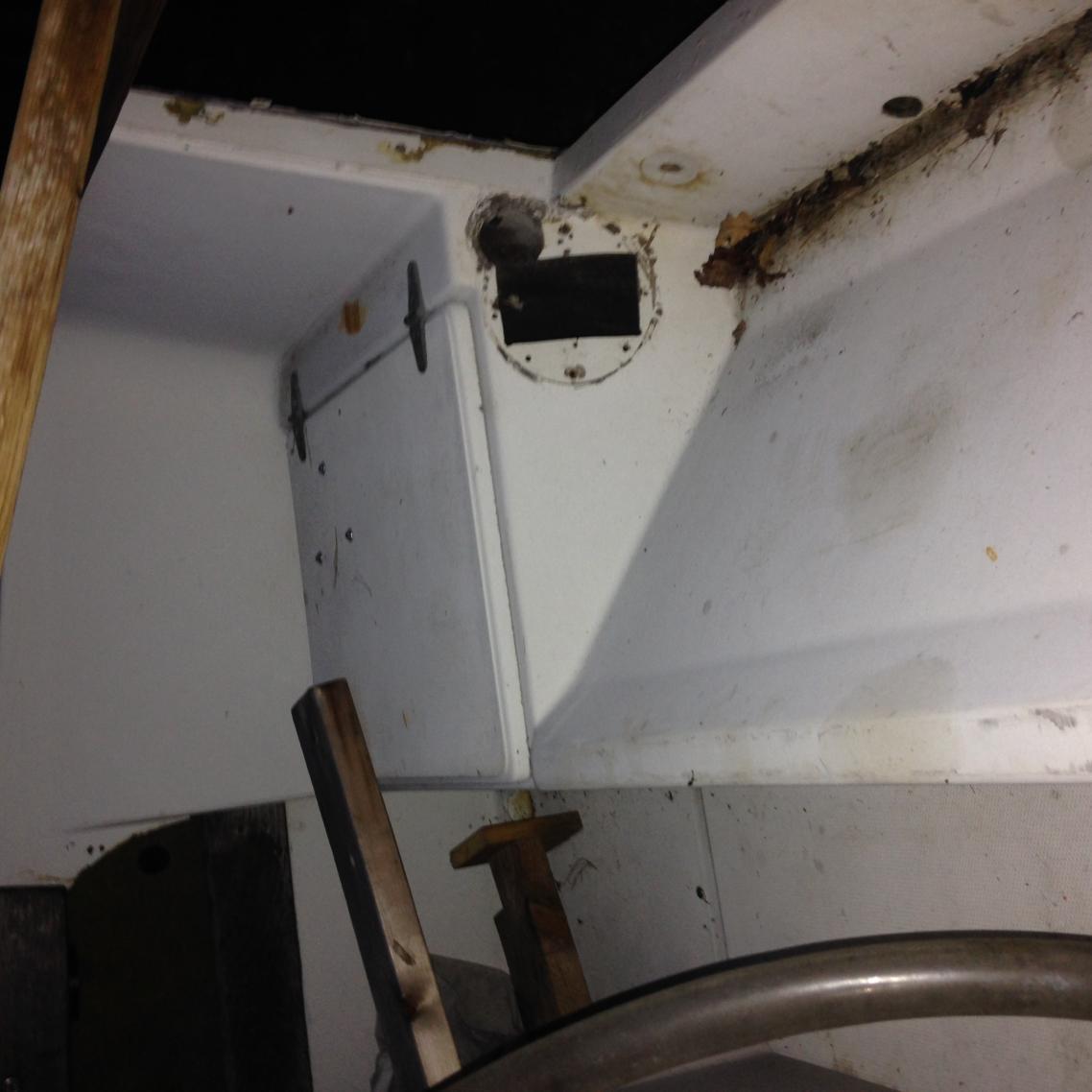

I rigged the engine and am running into issues with steering cable routing. The obvious solution would be to cut out some fiberglass to enlarge the rigging hole on the starboard side of the splashwell. To get it at the right level it looks like I'll have to cut right up to seat level. I don't see any way around it, so I think its time to pull out the sawzall and grinder.

As far as the steering cable goes a lot of these have been butchered to some degree. max flex cable might help. some models have a little lump on the edge of the of the stern locker and splashwell designed to make that easier but some were not conducive the driver's preference of throttle shifter placement.

Now that I look at it closer I see that I can't even enlarge the hole enough to get clearance. I need to cut a second hole where the starboard seat bottom meets the transom about a foot away from the steering tube on the engine. I'll arrange some sort of clamshell to cover it for now. I imagine this cable routing would be an even bigger problem on a raised transom.

I cut the smallest hole possible in the seat, and will put a clamshell over it. I was able to get it so there are no tight bends in the cable. Your hydraulic steering looks great. I don't know how long this motor will stay on the boat, so I'm not going to go overboard right now, this is a bare bones setup. I want to raise the transom, which will mean a different motor. I'll post a picture once I figure out how to use my Dropbox.
