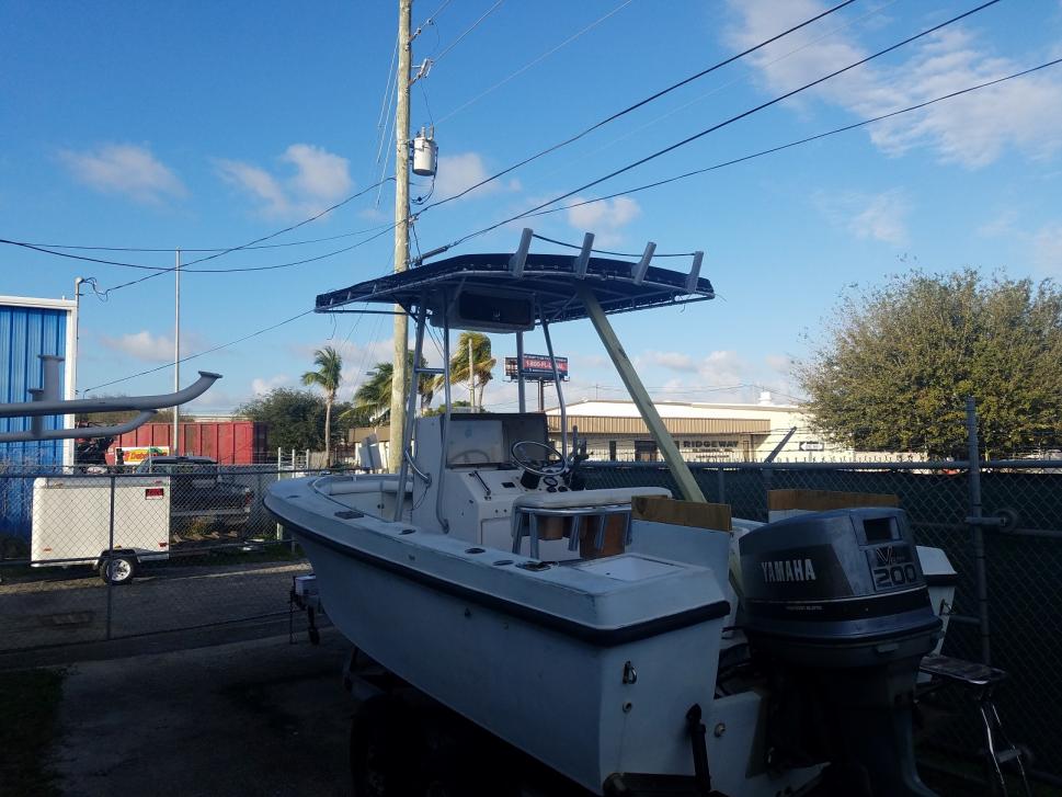

Ditched the other t-top. It was too small for my tastes plus would really have needed too much to make it fit right. Found another one yesterday the will give plenty of shade

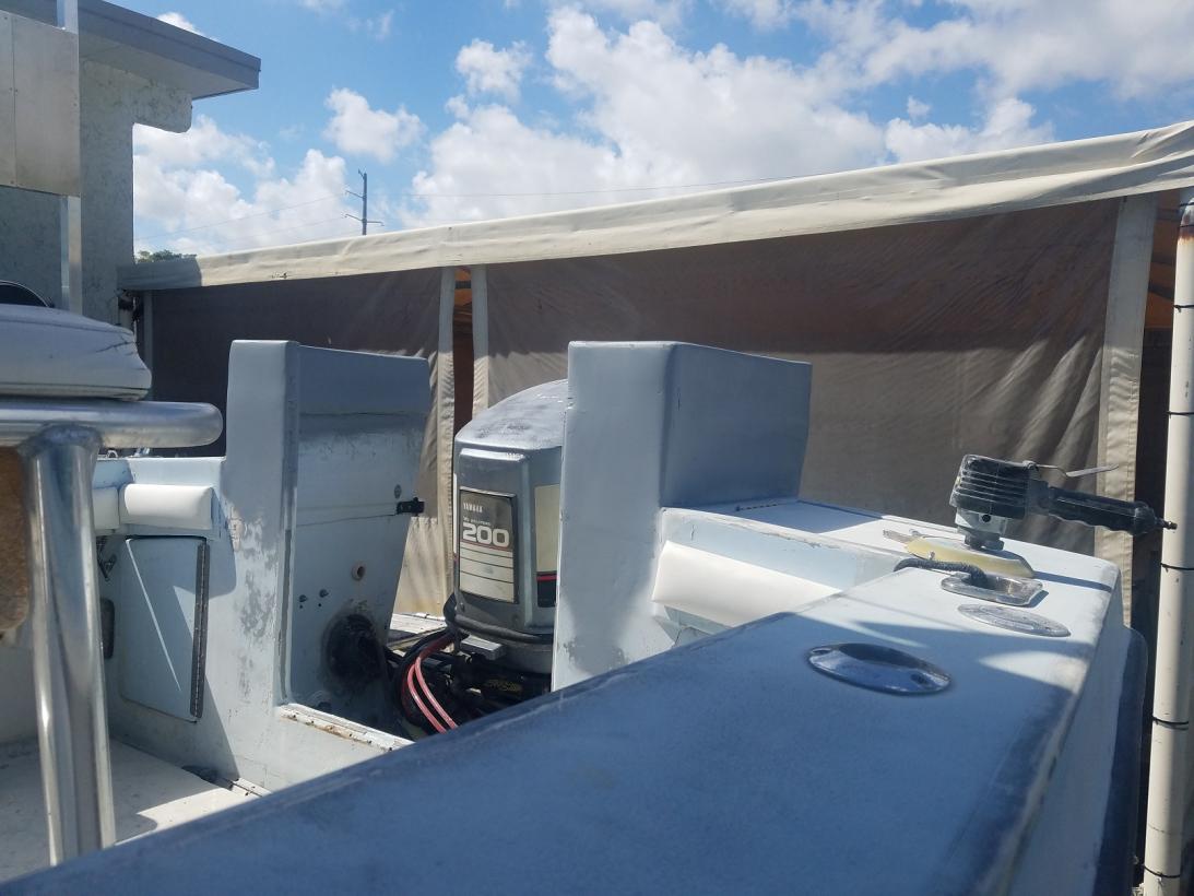

Also, started prepping the engine cover area to be raised up 4". Will start the glass work this week. I think I am going to make the top of the cover out of starboard instead of reusing the existing one. I also plan on pining it in place instead of having it hinged to the front cover. That should make access to the bilge a LOT easier.

That big top looks good on the boat. I hate the look of a tiny little top on a boat.

Thanks - I gotta agree small tops are not even useful - I don't understand the trend at all

Just make sure it's not catching air when the bow is up on plane. It'll slow you down like a giant parachute/umbrella.

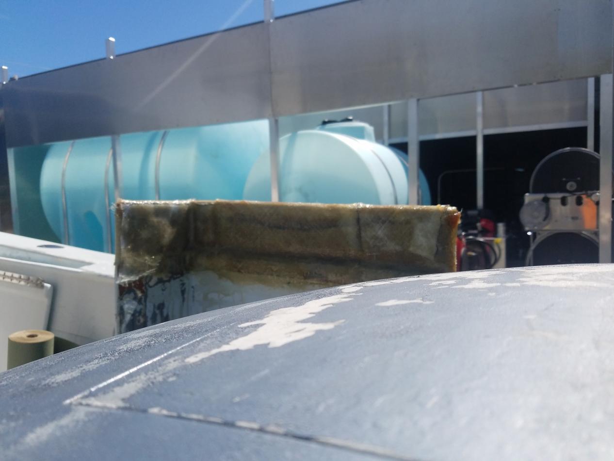

Starting to work on raising the engine cowl cover. Cut some plywood and pegged it in place with dowels. Coated with resin and then laid some 1708. waiting for it to cure enough to sand down some of the renegade fibers and then put another layer or two on before fairing it out.

Doing a little more body work to the splash well/engine cover
