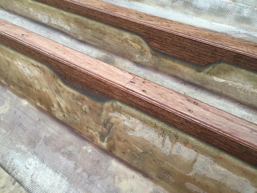

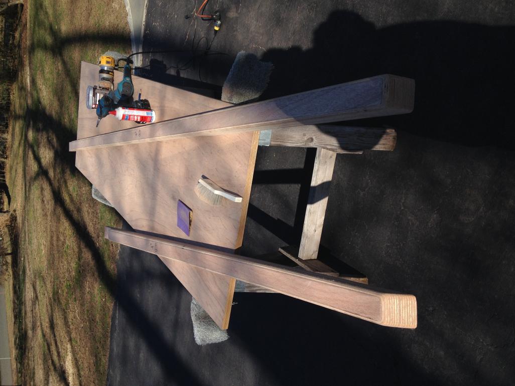

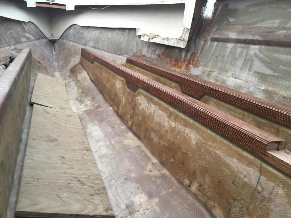

Got a little work done a few weeks ago... Closed the stringers up with marine ply held on place with CSC. Then we fabbed up some marine ply to raise the stringers. Bedded them in poly/cabosil putty. Filled the seam between the existing stringer and riser with poly/cabosil/milled fiber putty along with any other voids. Glassed it all in with multiple layers of CSC and 1708. We also got the old bilge hole patched from the inside.
We have been trying to do all wet layups, seems well worth the long days in order to grind as little as possible.
