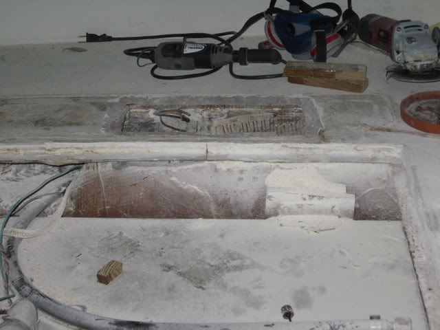

Old 01-01-2007, 11:43 PM
Join Date: Mar 2006
Posts: 947
Default moved to the inside of the boat
ok well since i have made the console more narrow, i had to modify the inside of the boat a little. it used to have a place molded into the floor for the wires to go thru into the console.
so i had to cut that out .
i will post more pics tomorrow and explanation of how im going to modify this portion of the floor or suggestions would be great.
