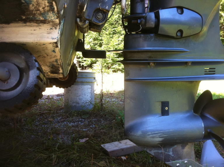

Hey Pianewman-
I finally got to look at my setup this weekend in action. With the Yamaha F100 and the size large hydroshield and a full boat (3 guys, 3 tackle boxes, a kicker, kicker fuel tank), it looks like the anti-cav plate was in fact about 0 inches above the keel, running basically dry at about 31 MPH with minimal lateral spray off the lower unit. No tape measure involved, as I was leaning over the transom at WOT.
I also have the two batteries in the center console, along with a 20 gallon topside tank. I have flotation foam where the under deck tank was.
Again, with the noticeable stern lift at WOT from (I suppose) the hydroshield and 4 blade stern lifting 12-3/4 x 17P prop. A hat tip to Fr. Frank for the suggestions on my setup.

No WOT handling issues, it carves turns as hard as I am comfortable with. No cavitation, and 2 weeks ago ran at absolute WOT for ~11 miles at a time (20 minutes) with no high temp alarm. Twice.
I will look for a picture of the anti-cav plate positioning. I might have a picture in my phone.
How much does the 150 weigh compared to my F100 and kicker. Remember, I am lifting ~428 lbs on the stern when I include the kicker.

OK, I finally got a picture of my setup on land
Anyways, maybe my anticav plate is lower than I thought? I may raise it one hole this weekend.
