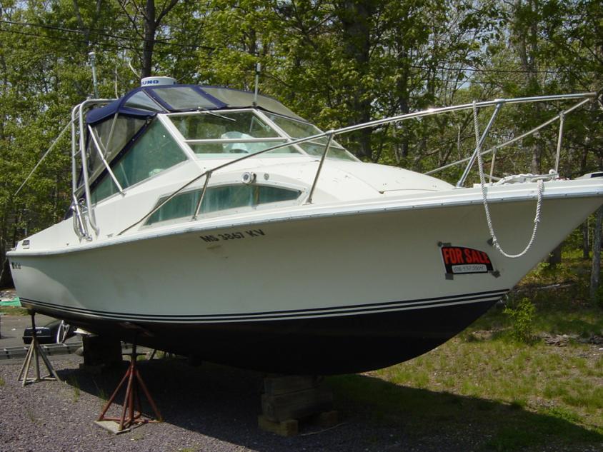

I bet my exhaust risers are not much above the deck, judging by the pics. the scum line on the boat is perhaps 4-5" below the scuppers, so fully loaded, I can see the waterline being close to the scuppers.

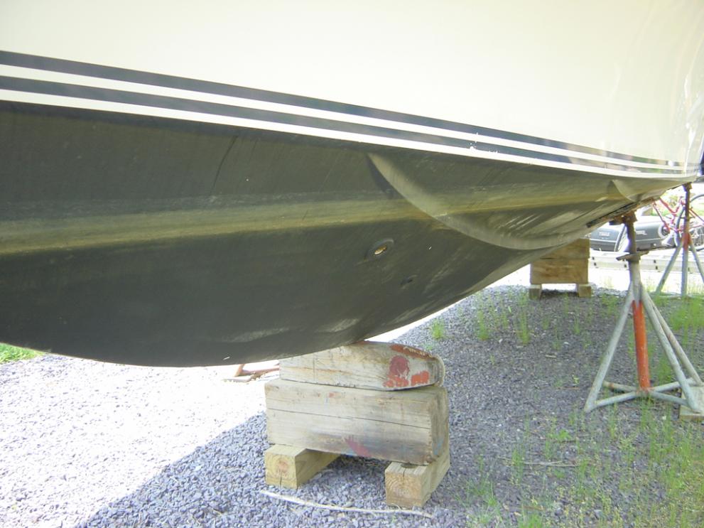

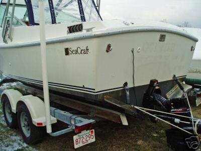

Pictures of the (scum) waterline before the repower. Blue Heron passed these along.

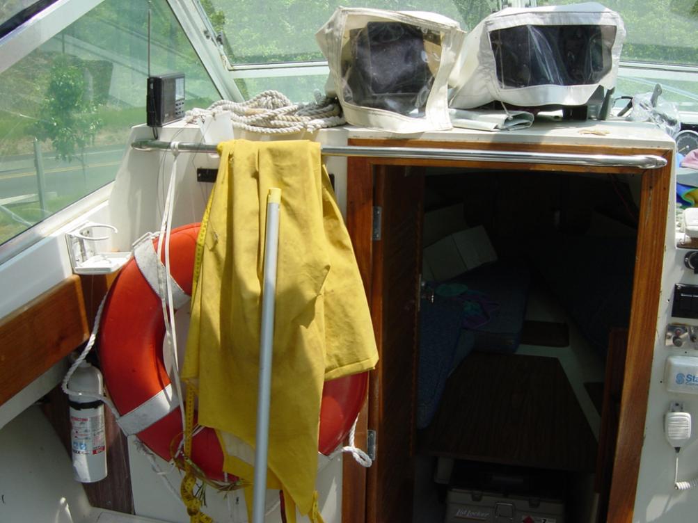

And a few more. I did pick up scraps of the canvas, but not all of it, and almost no electronics. And an awful lot of thru-hulls. Mostly plastic, it looks.

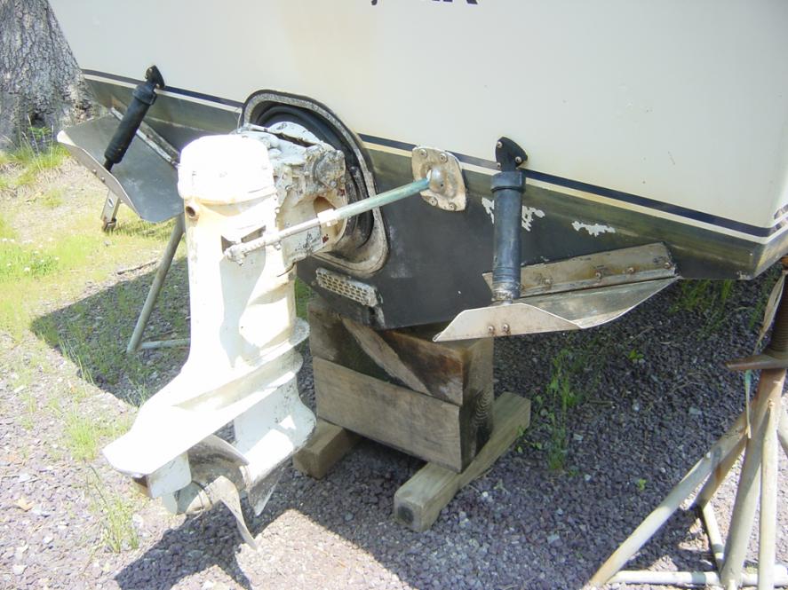

Here a few more. Looks like someone did not like the name at some point. You can see where they took off the lettering in the last pic. I have a couple shots of the old engine as well.
  #40
Old 02-22-2013, 08:58 AM
Location: Greater Boston
Posts: 1,117
That's a funny way to attach an outdrive...
There was rumor that it was used as a rockfinder once.
