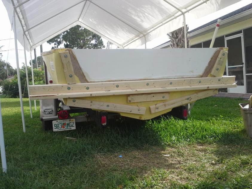

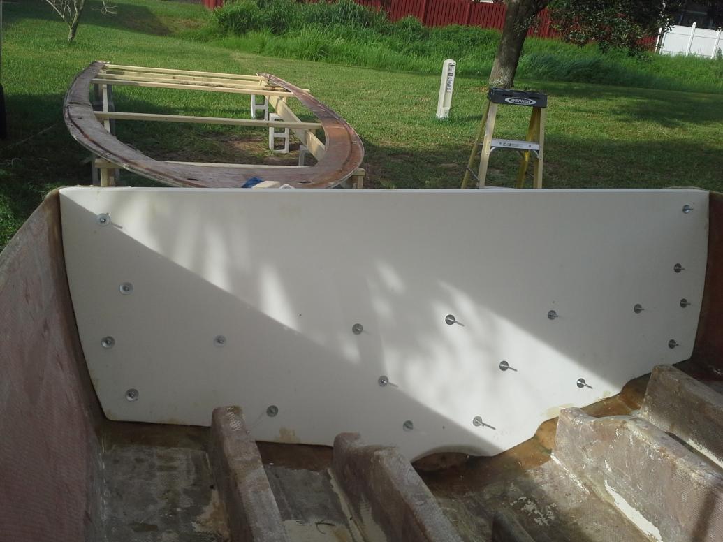

Got the boat squared up, cut the cabin off the cap, and glassed in the transom. I used a product called celtec and it is an awesome product to work with. Its a little heavy so dont think im gonna use it for the rest of the boat. I believe im gonna get some of that corelite and give it a whirl.

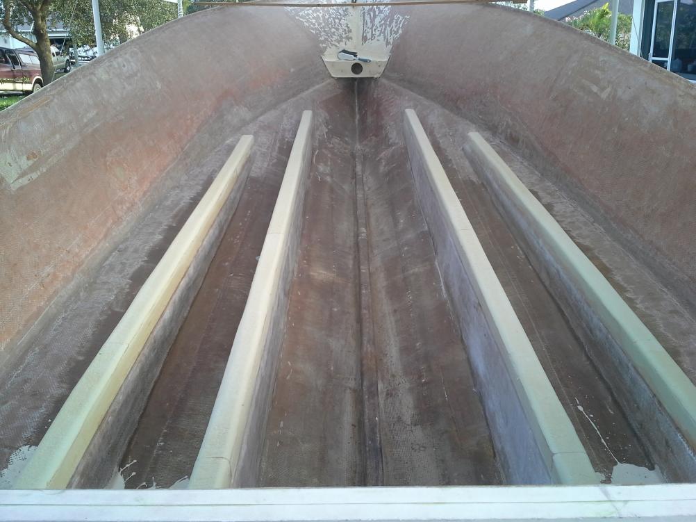

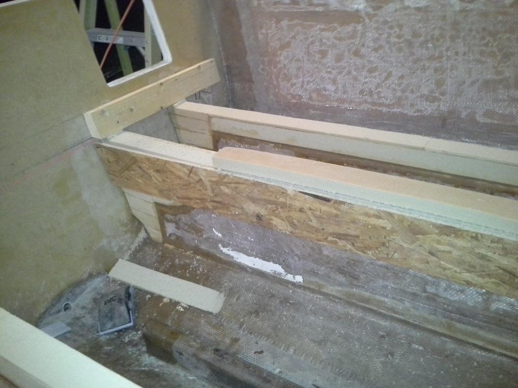

Old 07-14-2014, 12:06 PM
afishin82 afishin82 is offline
Join Date: Jun 2014
Posts: 108

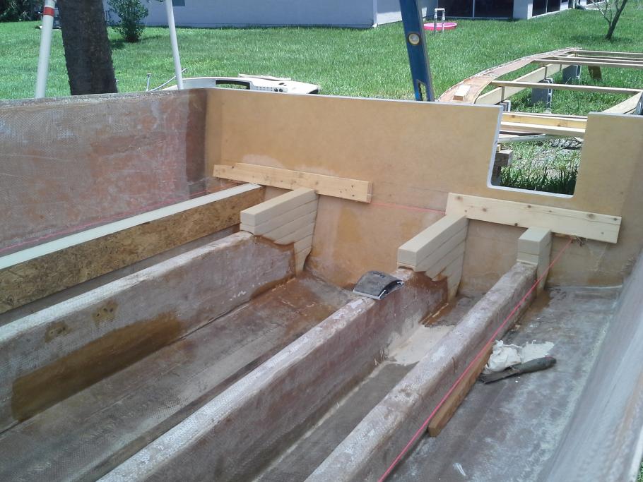

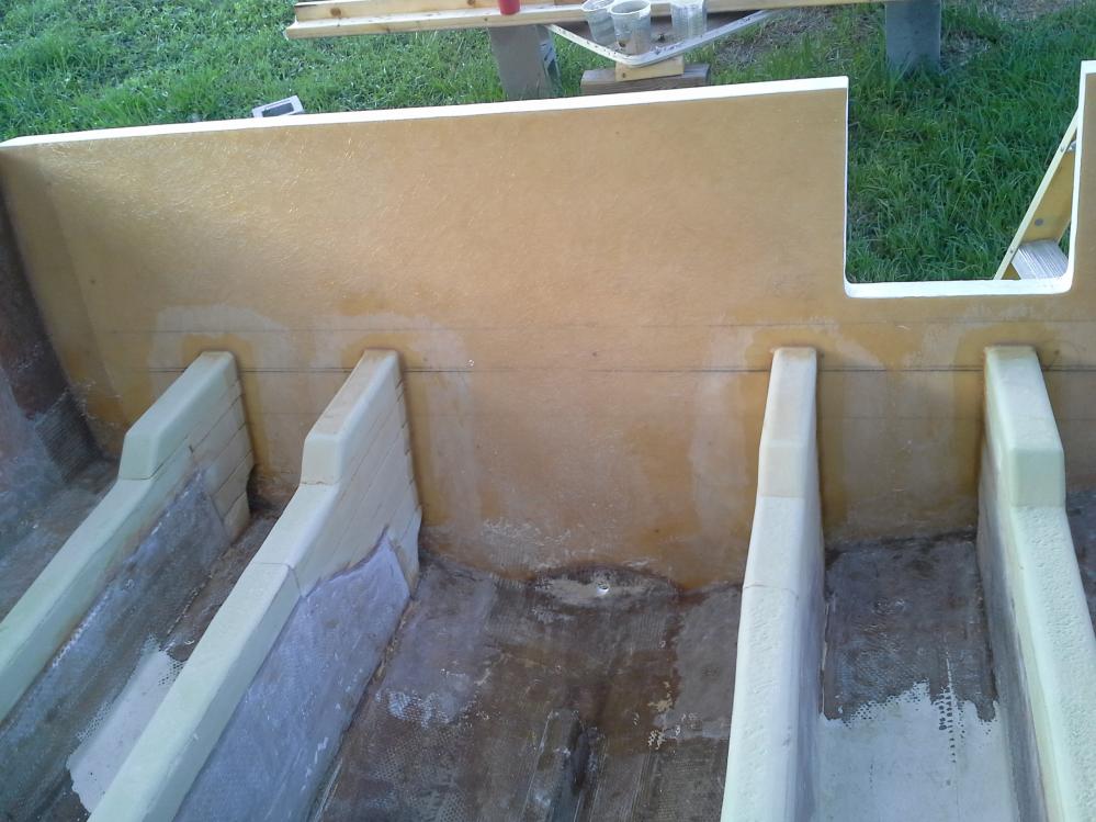

Got the stringers raised 2.5" and 4.5" at the transom. Stuck em down with cabosil and filled all the gaps with it too. Gonna start glassin them up this week!
