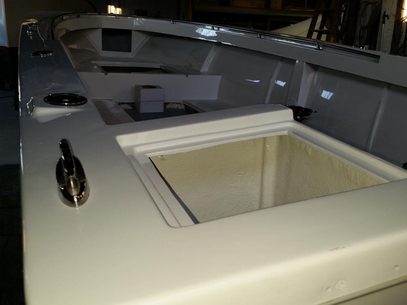

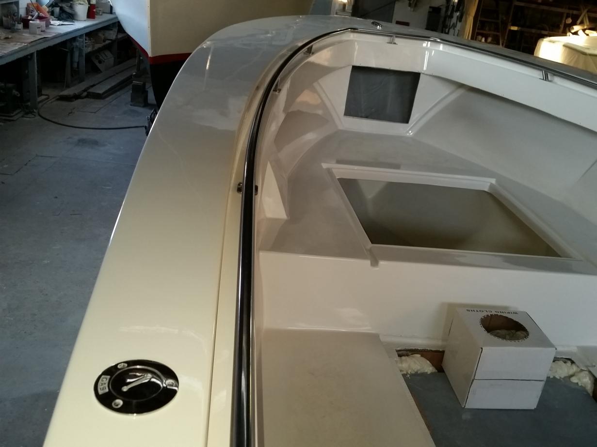

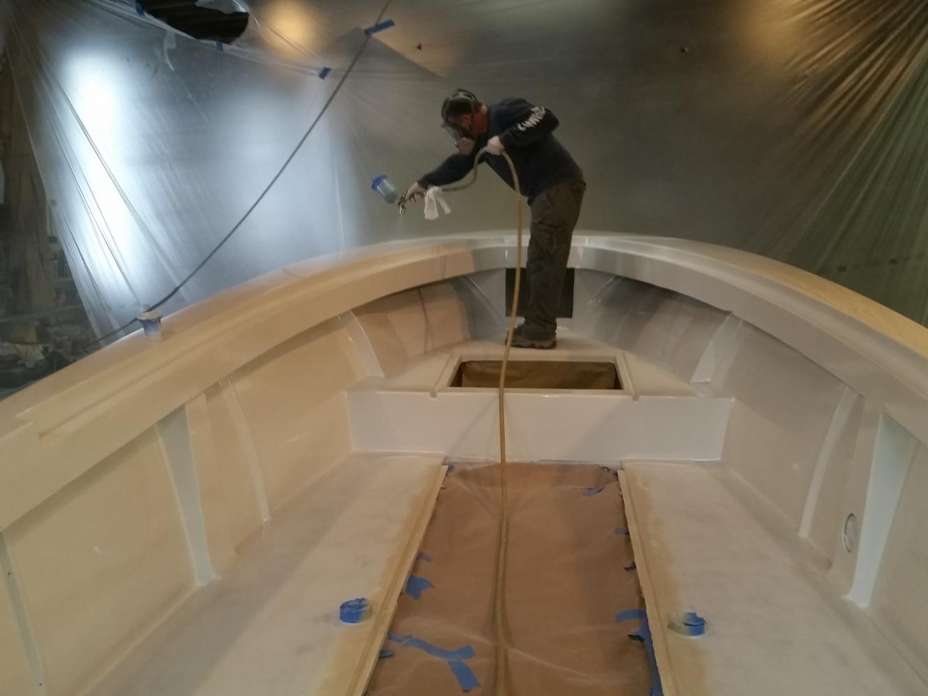

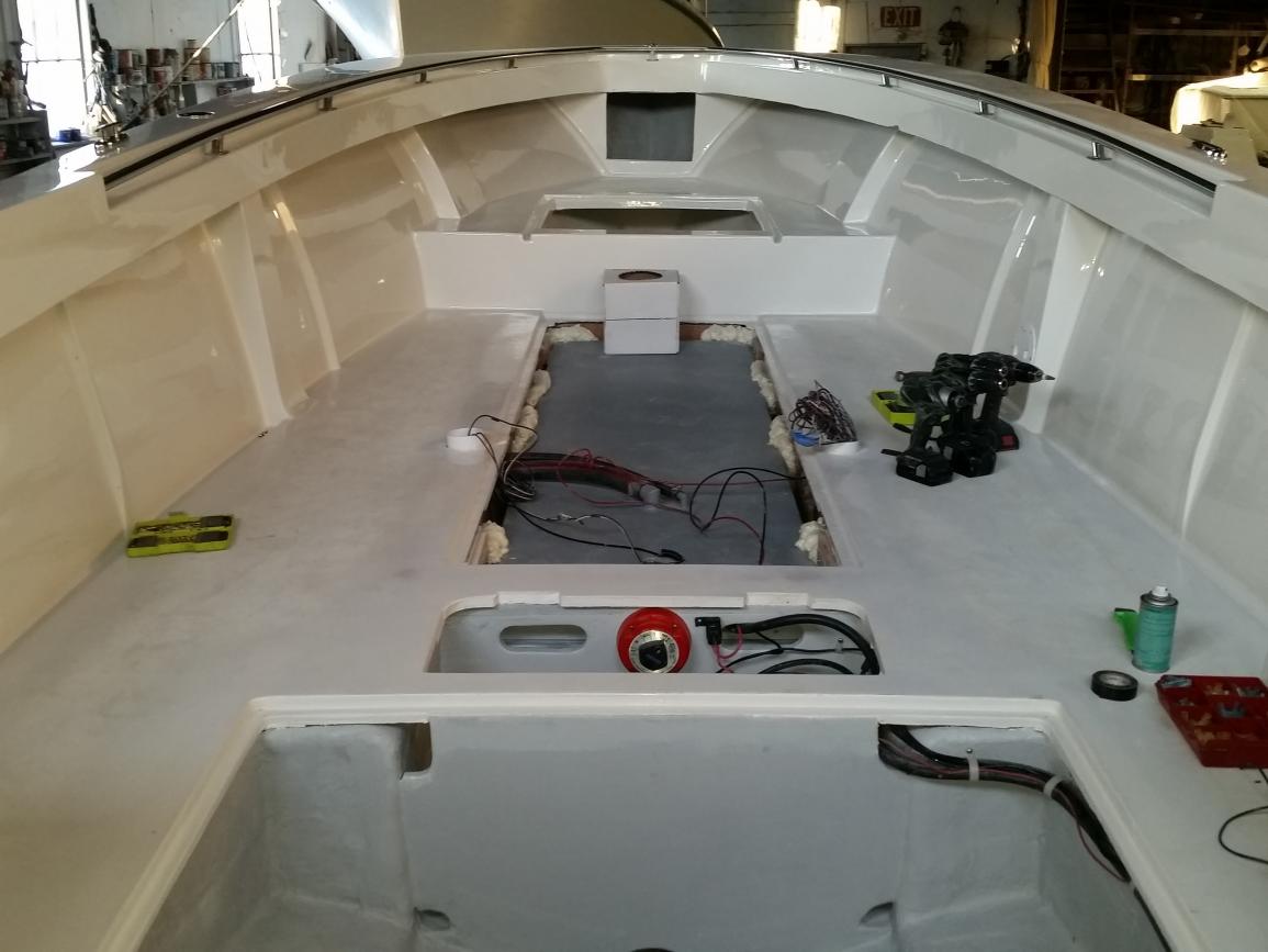

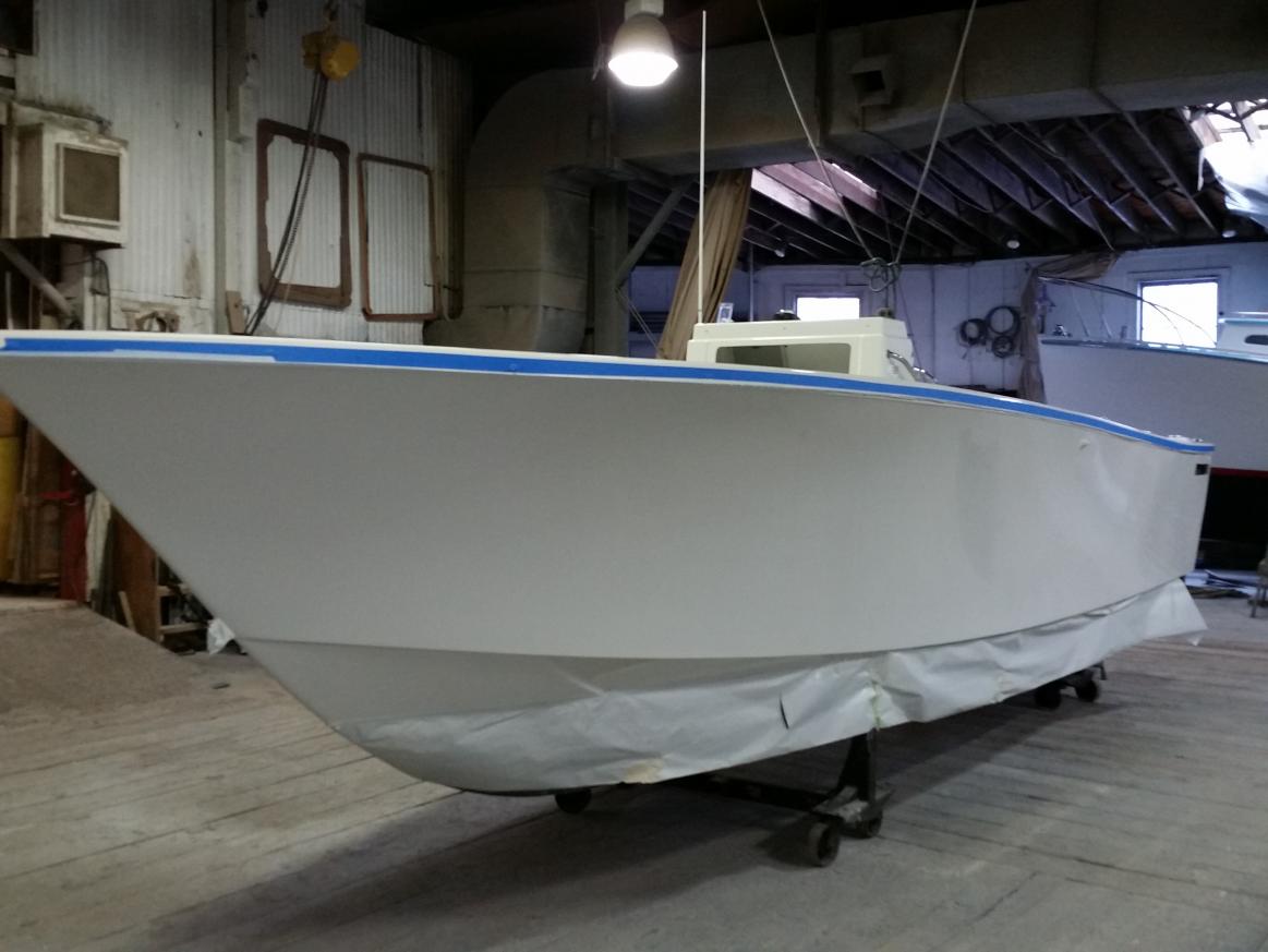

Got into the spraying...top decks and inner liner are done. Used all craft off-white Brightside. Dry sanded everything...800 then 1200 grit. Compounded it all out all the way to finesse II the sponge pad. Came out awesome.
Started mounting the flush hardware and rails...using all oval head Phillips for a clean look. Got the floors all done....down to the non skid. I'll do that last.
There is a lot involved and we're moving right along...also have more pictures coming soon.

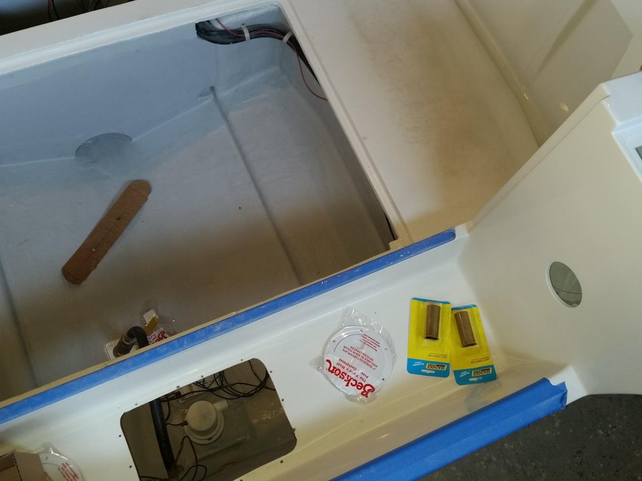

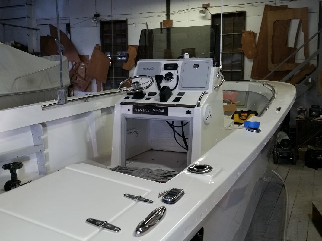

Tank floor cover is on and it's time to install the console so we can keep moving on with the wiring and the hydraulics, etc.

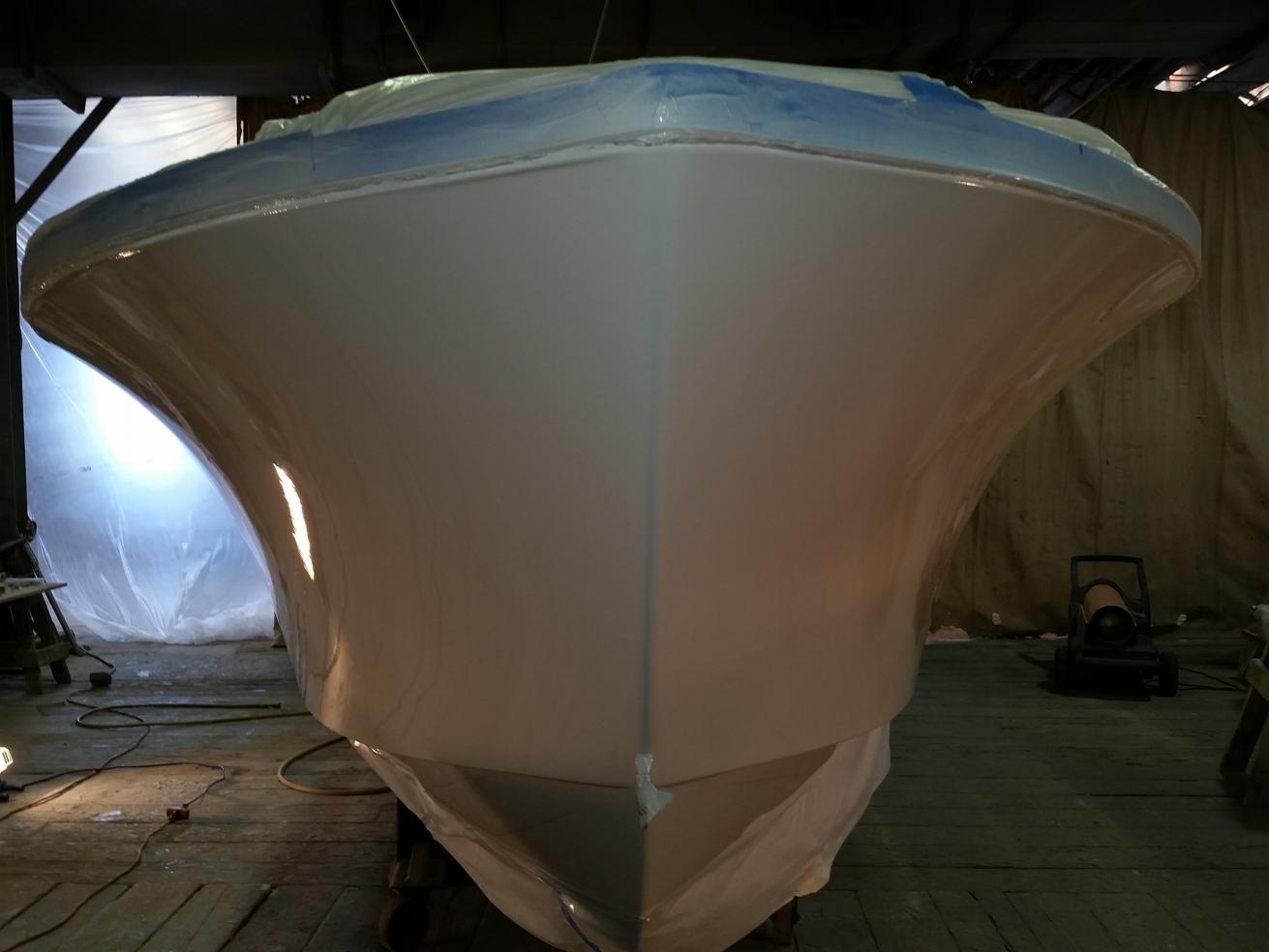

Posts: 287

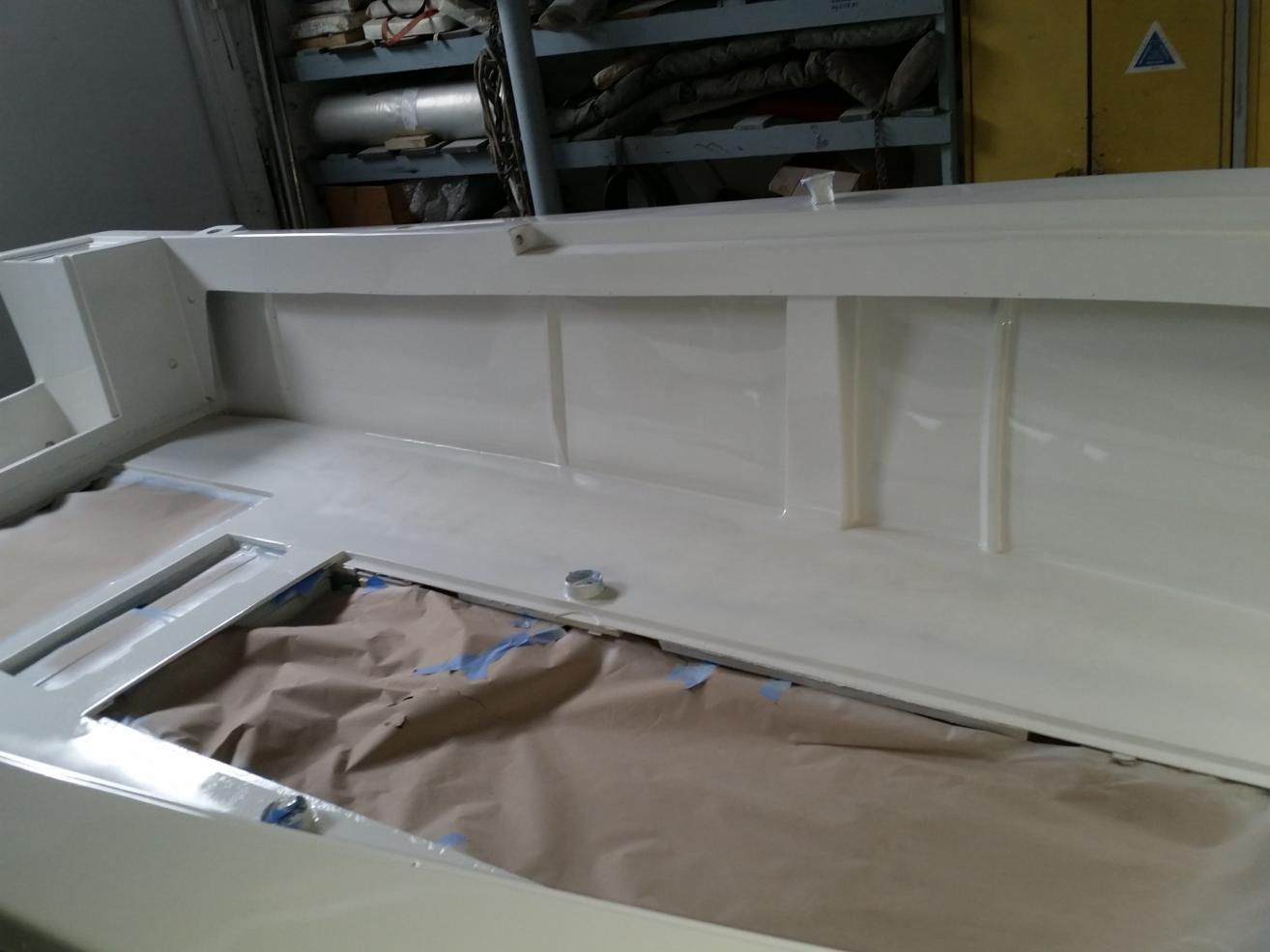

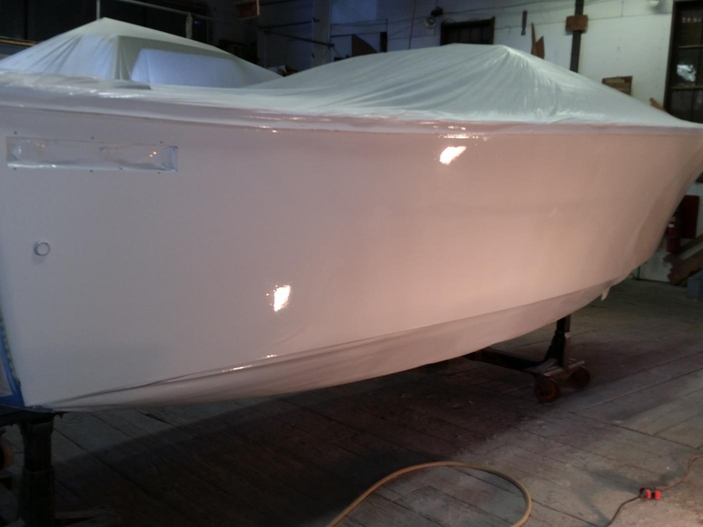

Wanted to finish the hull painting, Awl-Craft 2000 which went on nice and sanded with 1200, compounded & buffed. Then finesse II everything

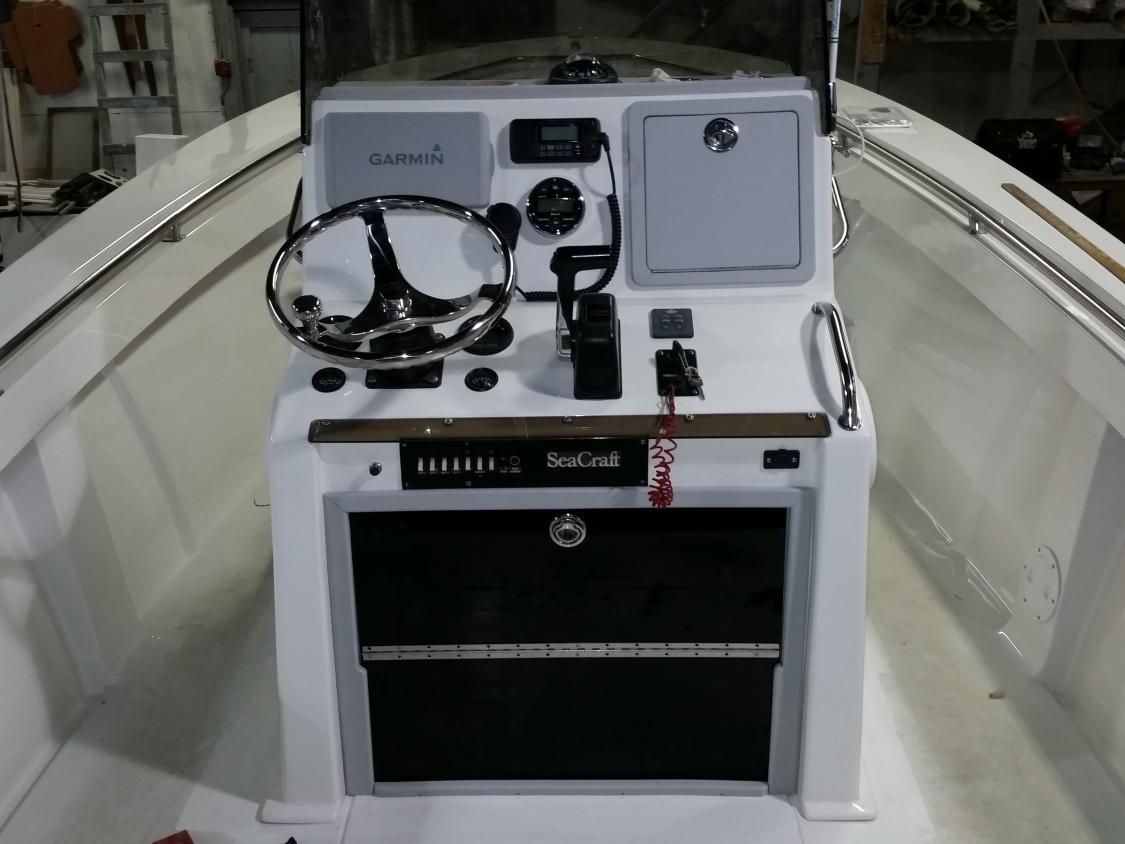

Posts: 287

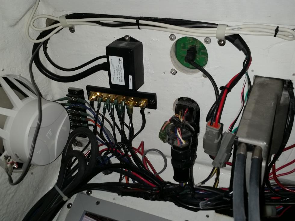

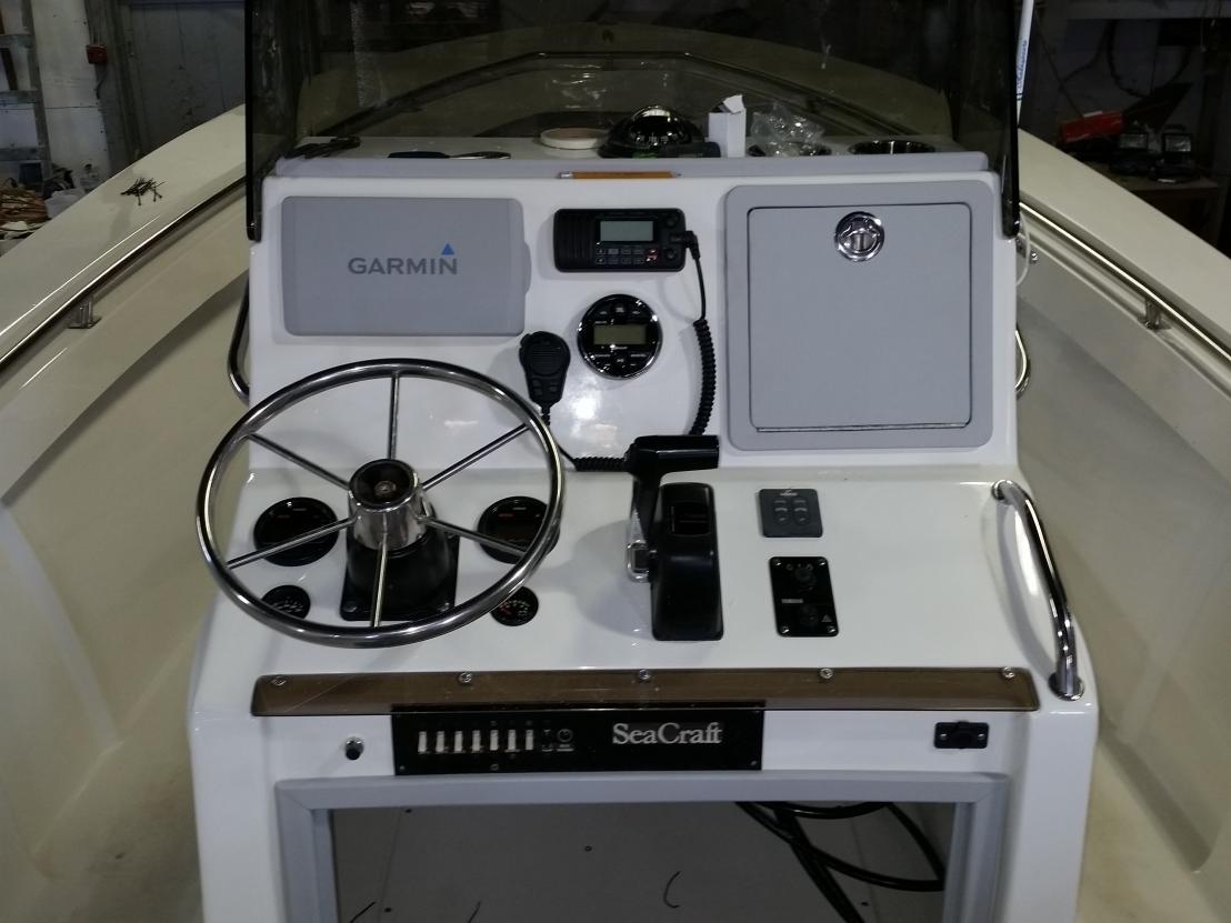

Electronics are now mounted. The new Garmin 94SV, Icom VHF & a JBL stereo. The dash is done

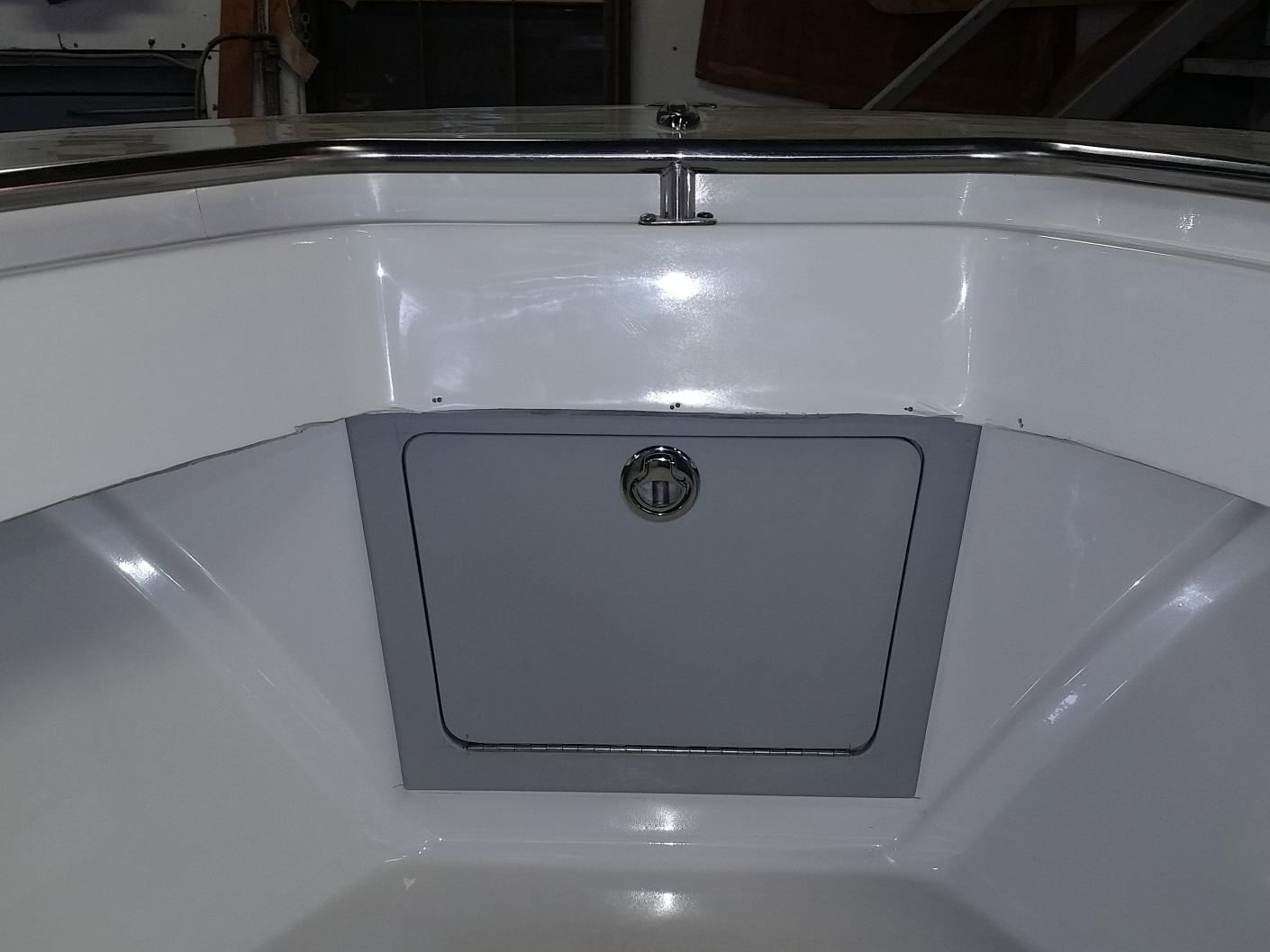

Posts: 287
All Teak was replaced with starboard & we made all the hatches & frames to fit the boat. All were mounted from behind so you see no screws, clean...

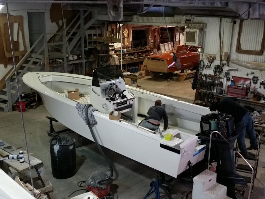

Getting closer
