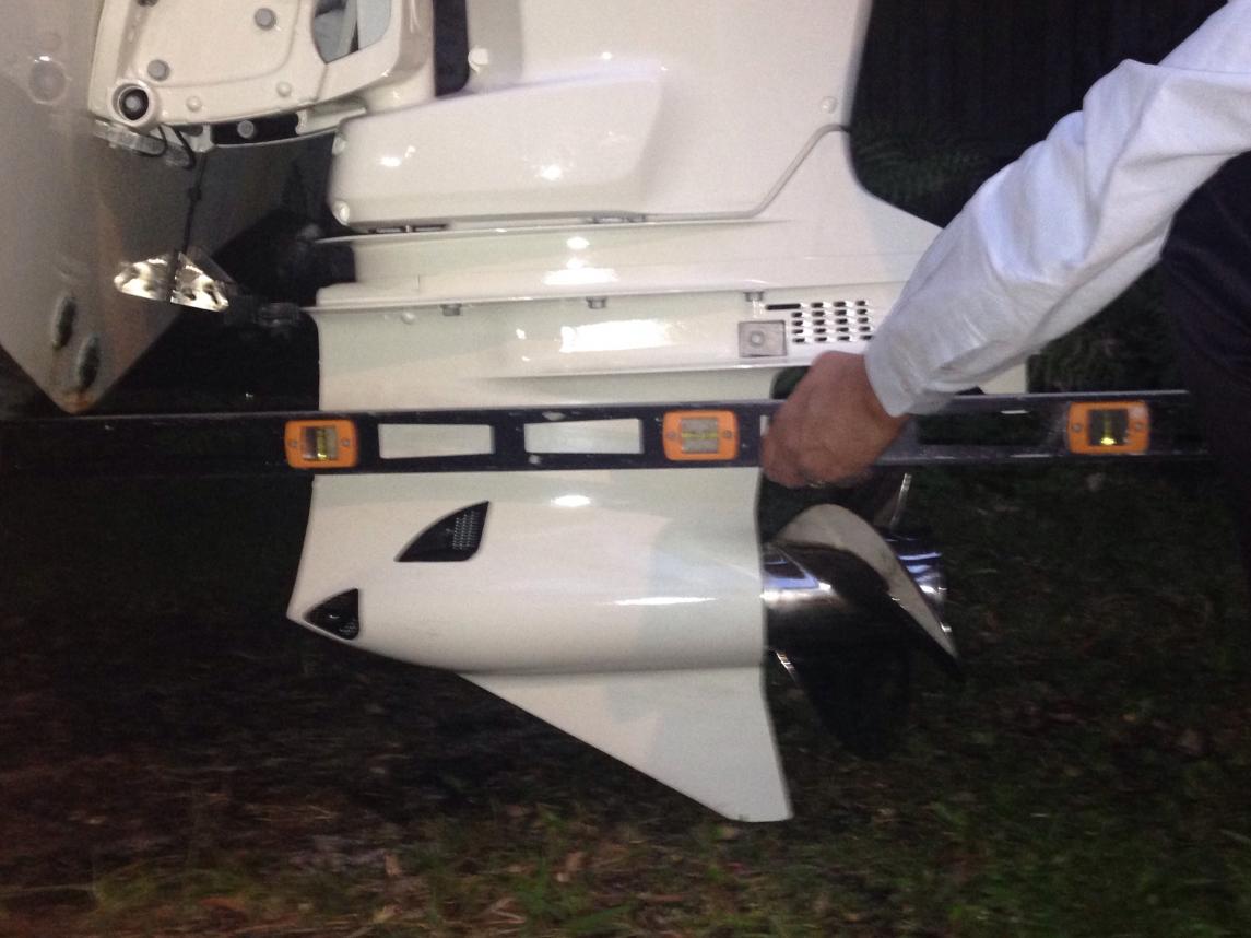

That seems to be the consensus for some of us discussing it offline. As Bushwacker suggested it is best to get the motor up high enough before the prop swapping starts. I would love to see a pic of the motor down in running position and a straight edge coming of the keel. My guess is the motor is more than a few holes too low and will require a bracket like I linked to get it up where it needs to be. They even make one with half the set back of the 10' if putting it back there is of any concern. Considering my 250 is a 30" motor his is probably close to the weight of mine minus the center section weight and shouldn't care either way.

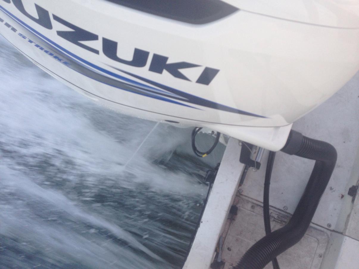

Default Straight edge
It looks to be above the keel an inch already?!

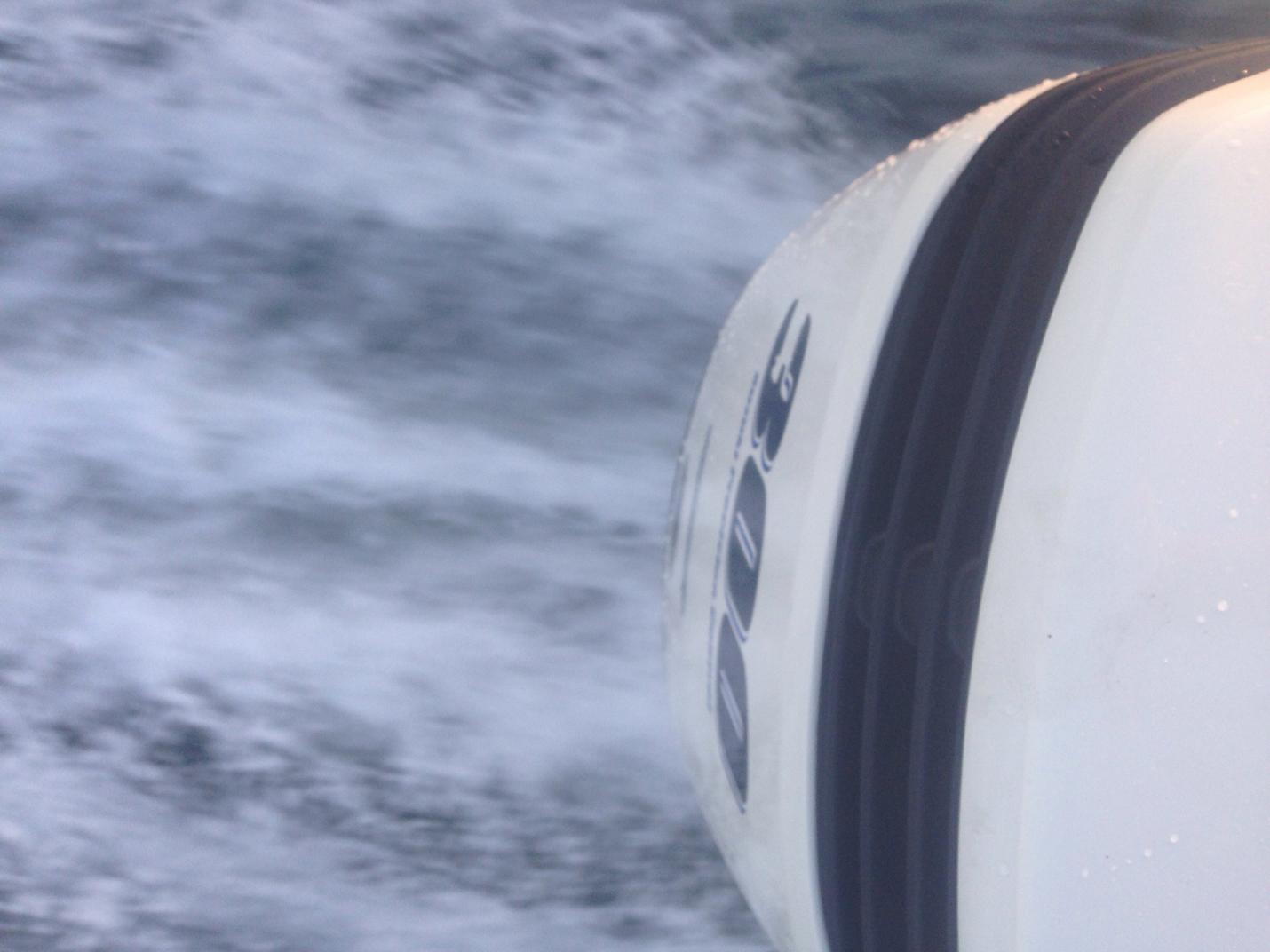

  #37
Old 10-26-2015, 07:03 PM
Default Weekend picture
No visual of anti cav plate
  #38
Old 10-26-2015, 07:06 PM
Default Running #2 pic
Plate running
  #39
Old 10-26-2015, 07:07 PM
Default Pic #1
Plate

Put the level on the bottom of the keel and extend back just far enough to see the AV plate with both parallel.
