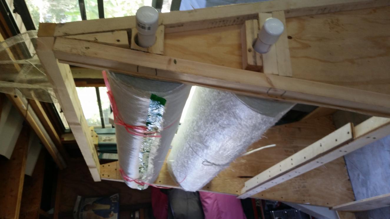

Slow going but at least got the glass rack done. Those rolls are heavy.

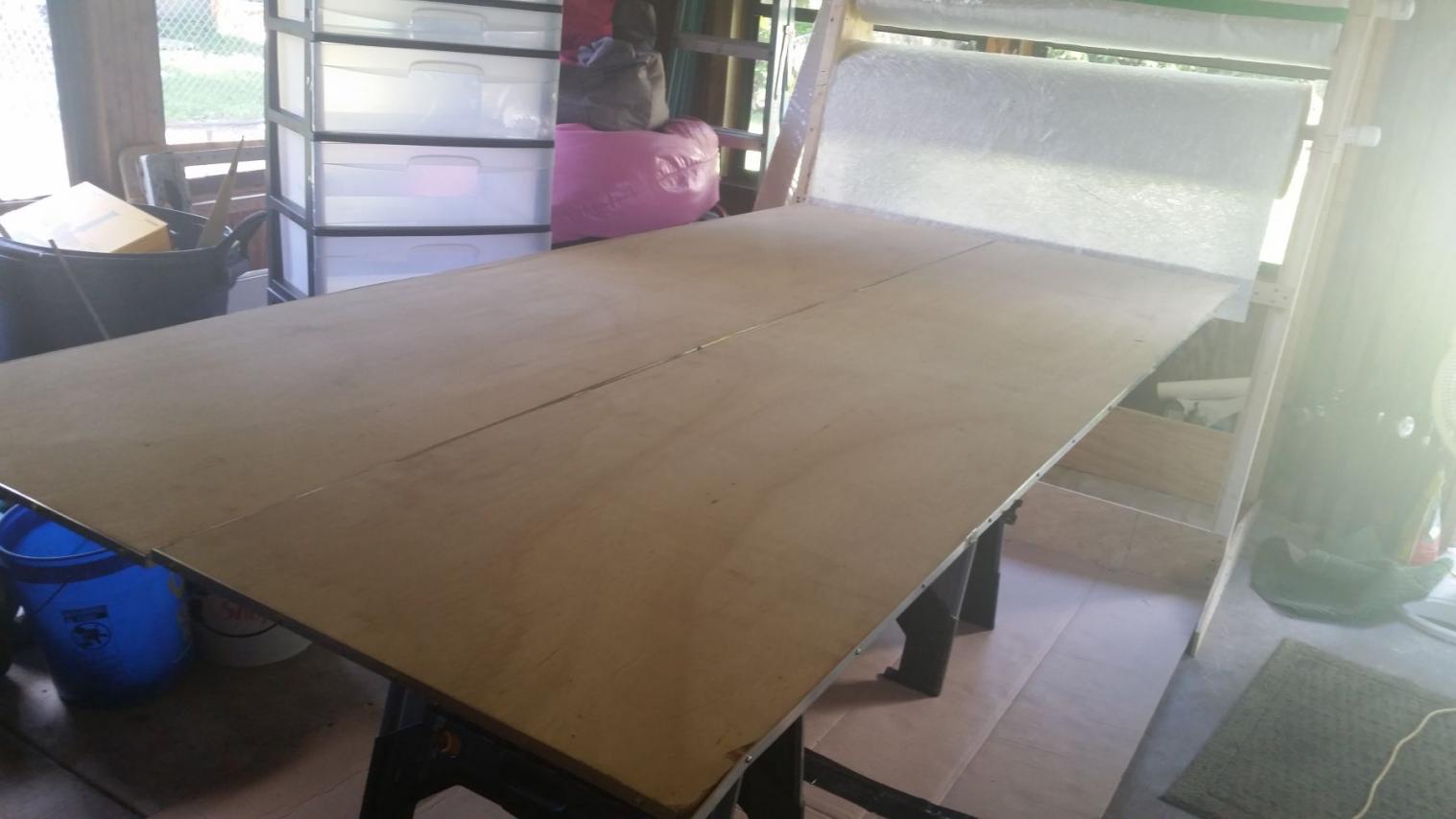

I have the next three weeks to skin coat 11 boards and some final tweaks to the lay up table. Its just is not as rigid as I want it to be. My thought is the final product will only be as good as the lay up table.
Made it in two pieces 22" wide and 1/2 thick with 1/2 X 3/16 aluminum stock on the edge. Have 2 saw horses and will try adding a two more.
Quick question, can I use peel ply over the lay up and use a roller to squeeze out unneeded resin?

I know you already have your table made up...but what I used was a big melamine board table...easy to clean, and when it got gross I just flipped it over and used the other side. I think I went through 2 0r 3 during my build.
That's what I do before I vac bag it. Make sure you use one of the ribbed aluminum glass rollers though. Peel ply also prevents blush on your part if it is an epoxy layup.
