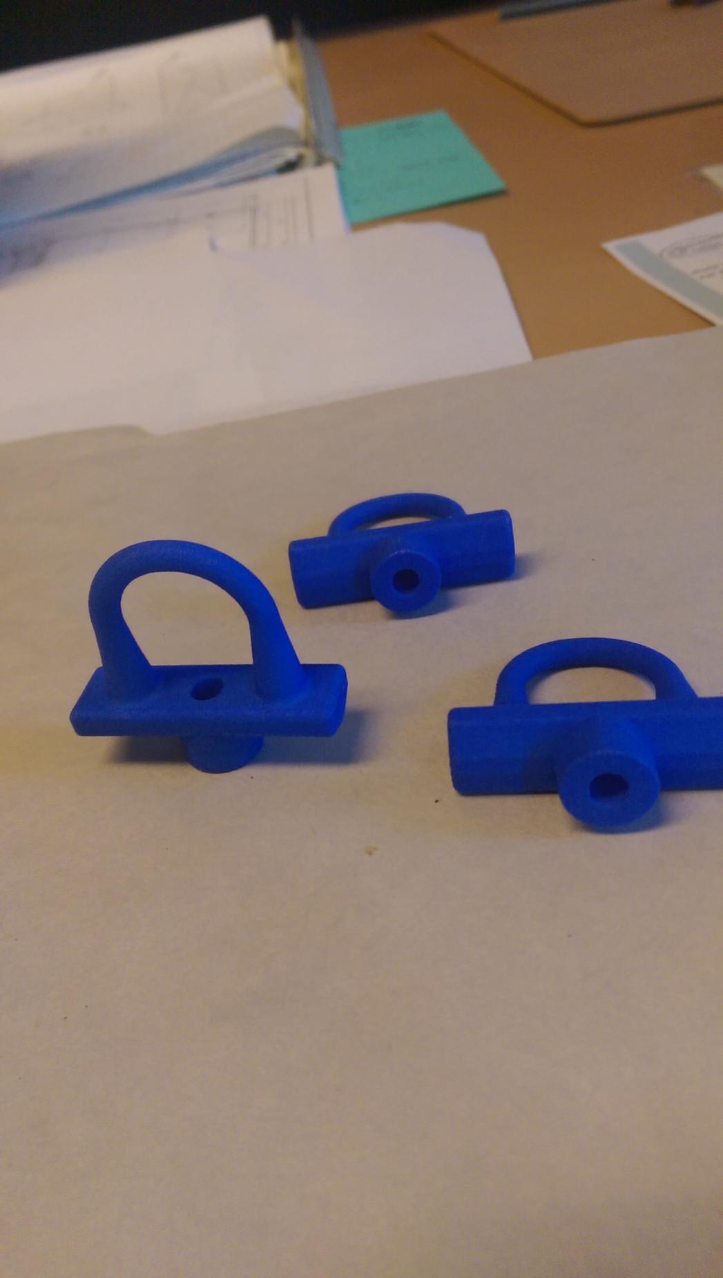

Just got the window latches ,back from printers ,thanks Mitch (flexpat)wiil try tonight

Wink
I wanted blue but not that blue

Kinda bright - should be able to find them in the dark - I did not include capability for installing an 'off' switch
Wonder what they will fade to?

They work great , color is growing on me
