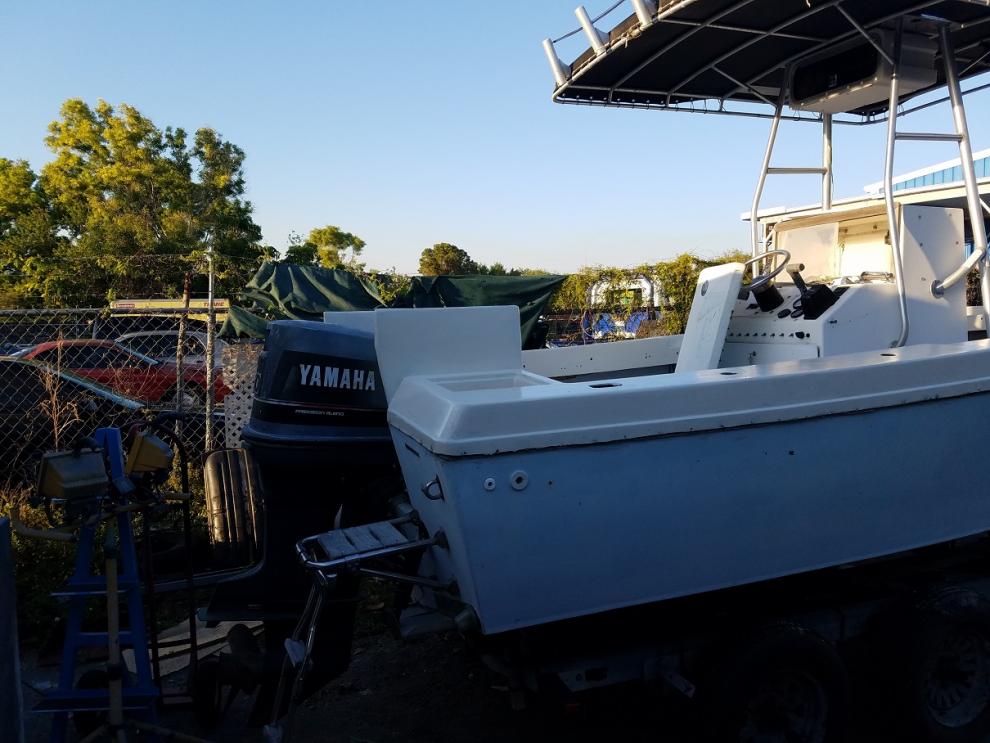

#31

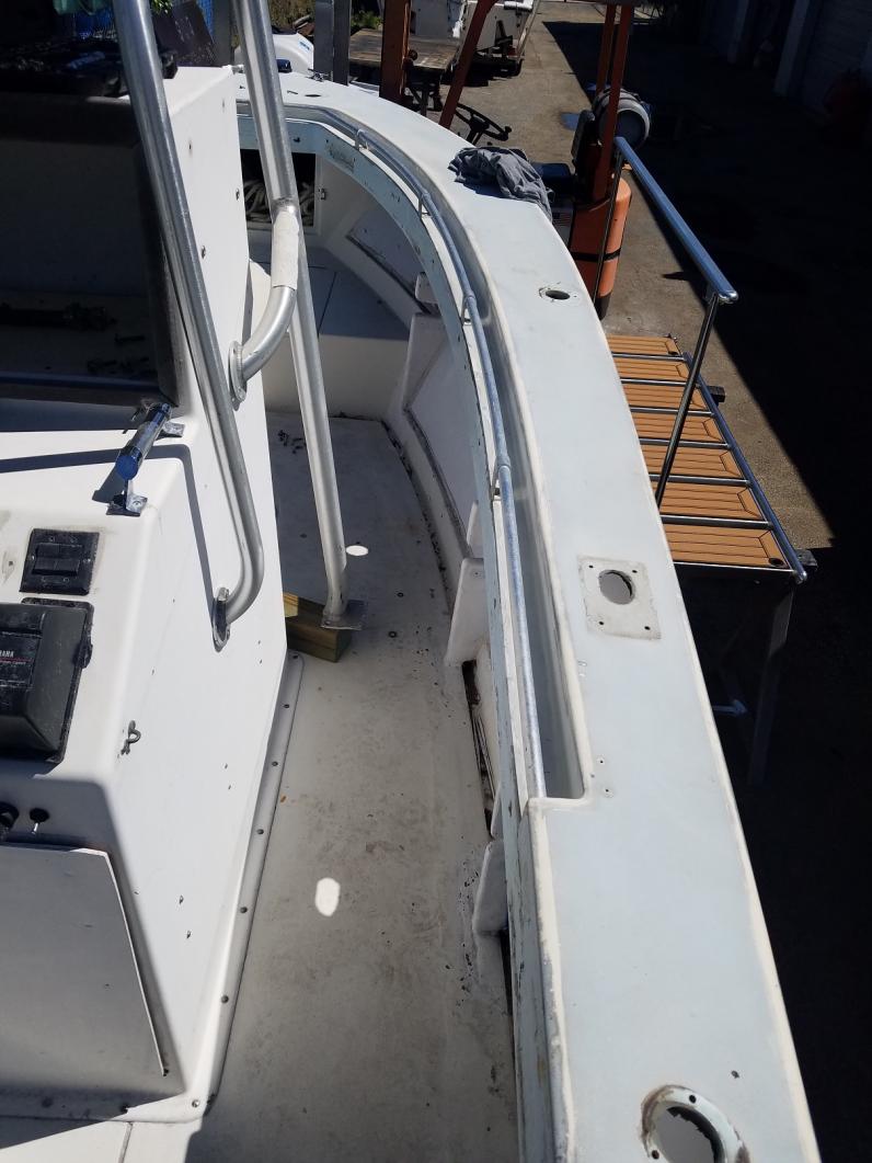

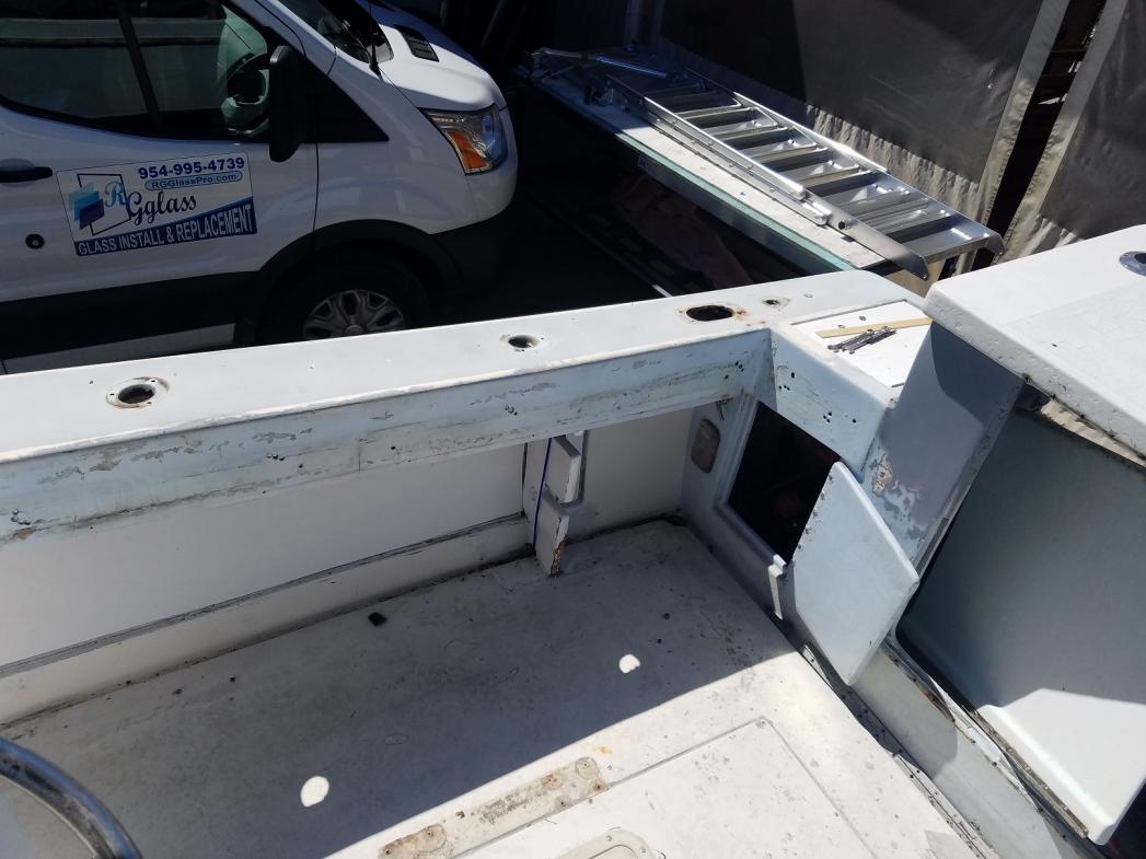

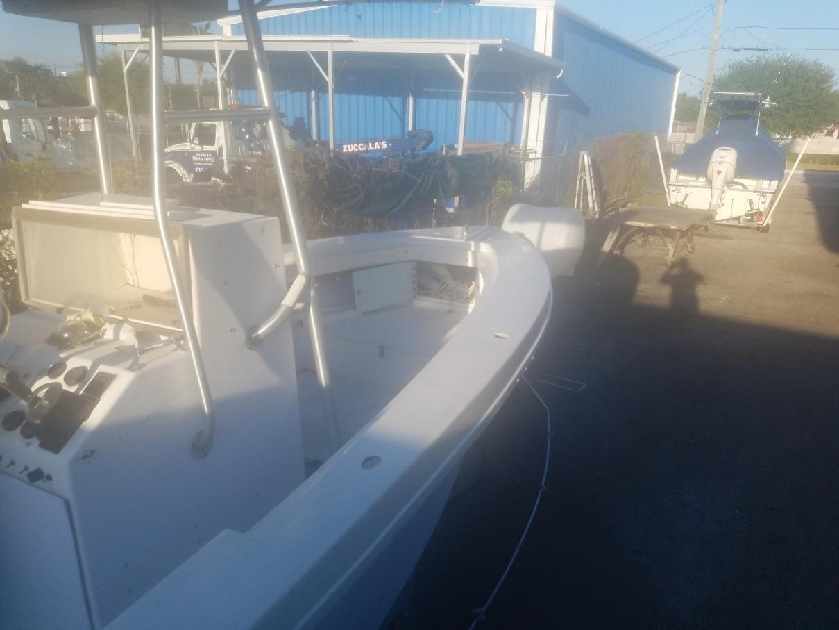

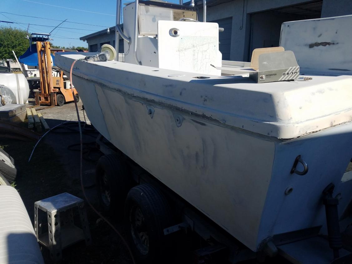

Transom seems to be ok. moving forward. removed rod holders and grab rail. started sanding on the cap. There are virtually no stress cracks and only a few unnecessary holes to patch YAY!
#32
Well did not get to paint the cap and gunwales this past Saturday. Maybe next weekend. Did do some more sanding and filling on the cap. It is almost ready for the epoxy primer I plan on laying down first.

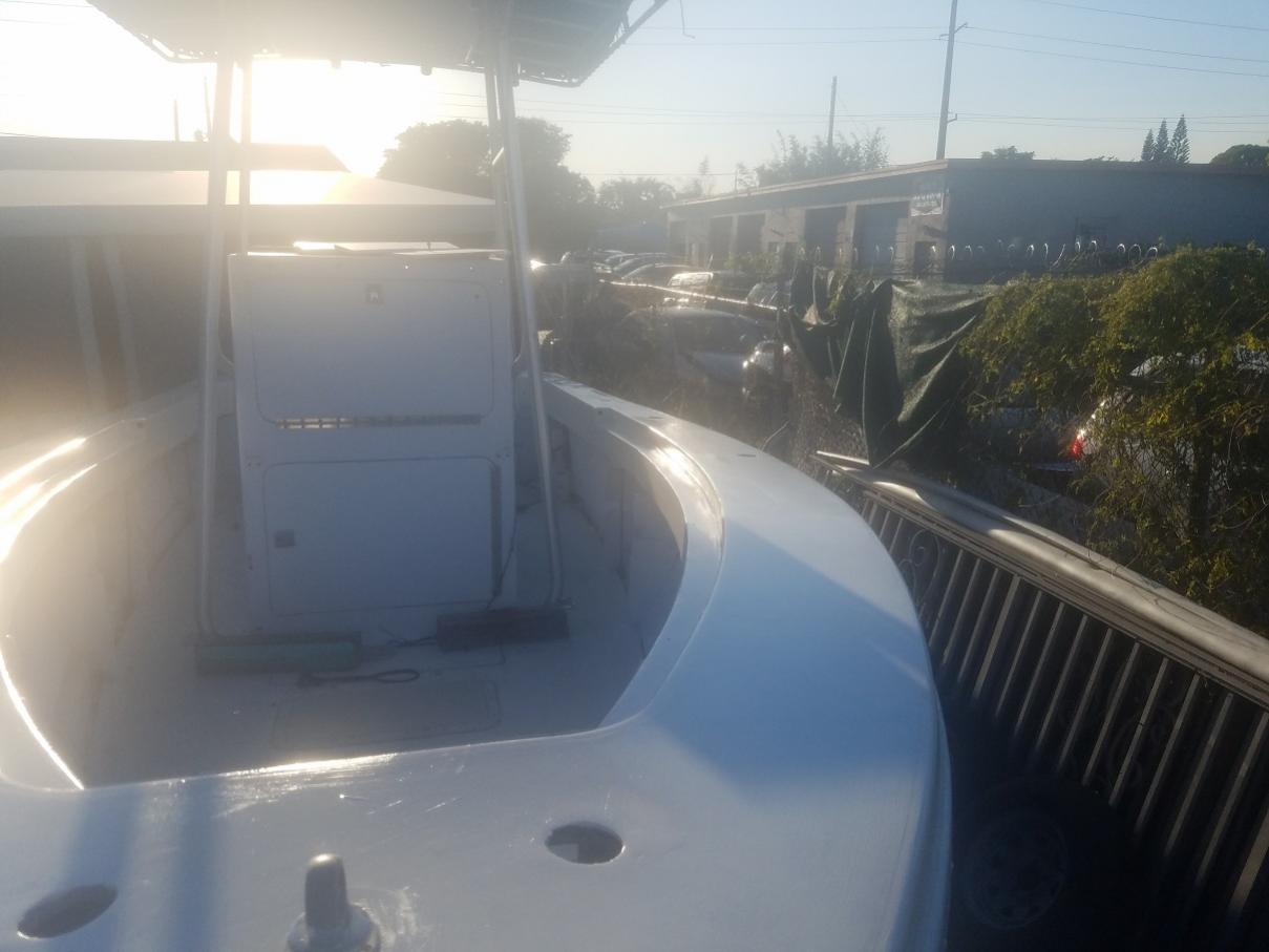

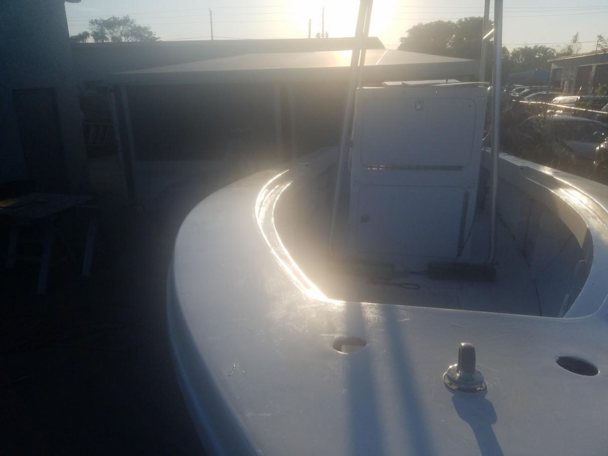

#33

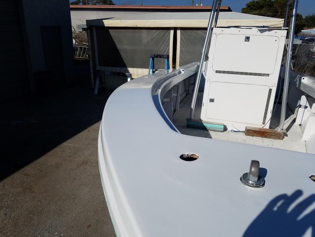

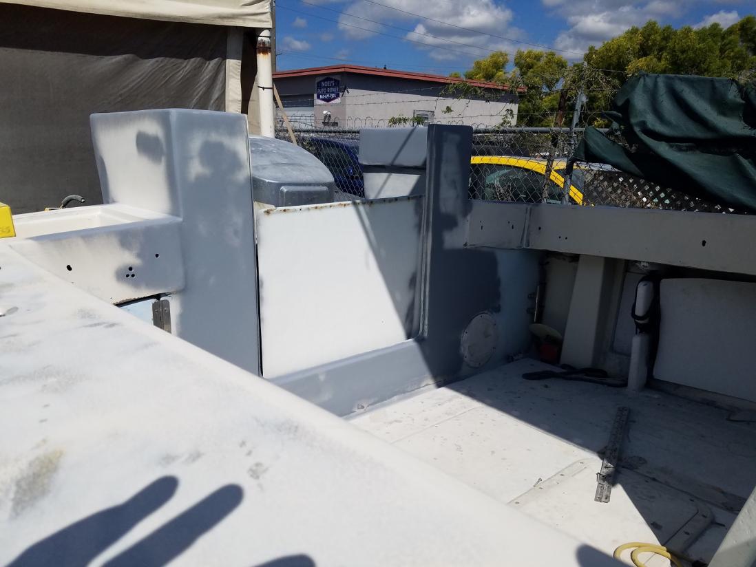

Since the weather this afternoon was amazing, i decided to roll the epoxy primer onto the cap. I proabably needed to use a little more brush thinner but I plan on sanding it smooth anyways. This is just to "lock in" any of the crappy old paint to keep it from lifting or reacting with the top coats.
#34
more pics from today. This kind of makes me even more fired up to get her done
#35

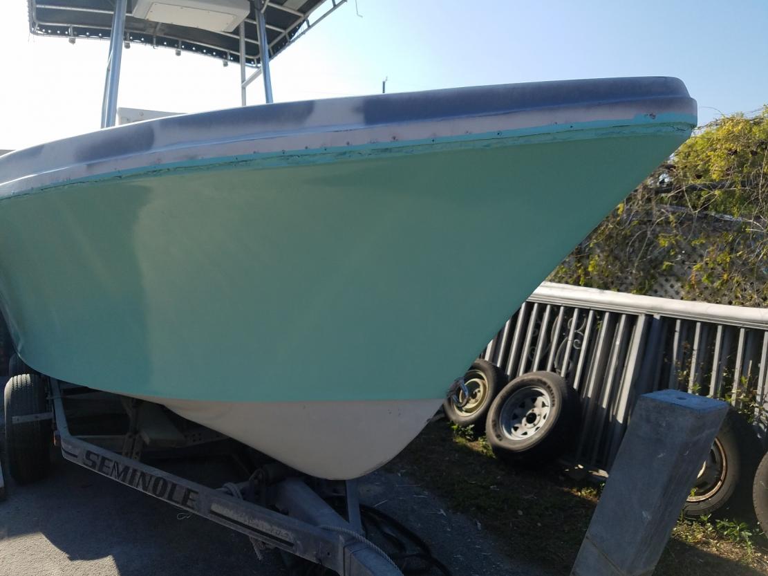

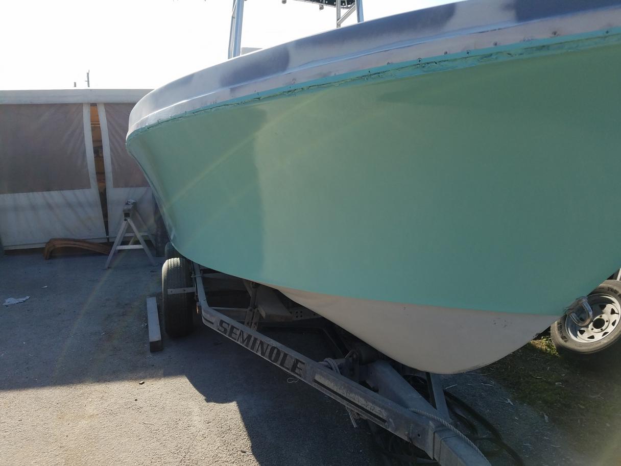

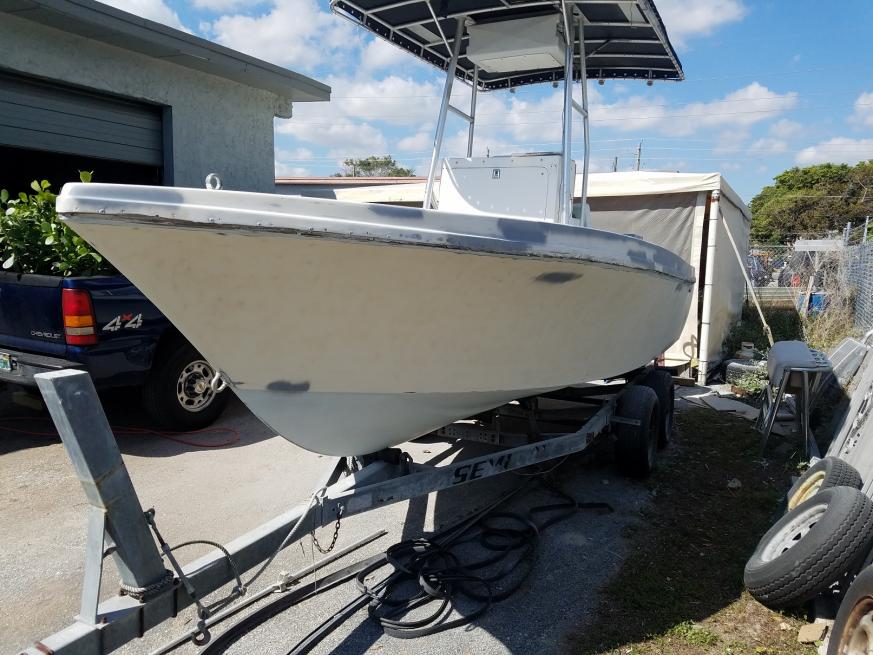

#36

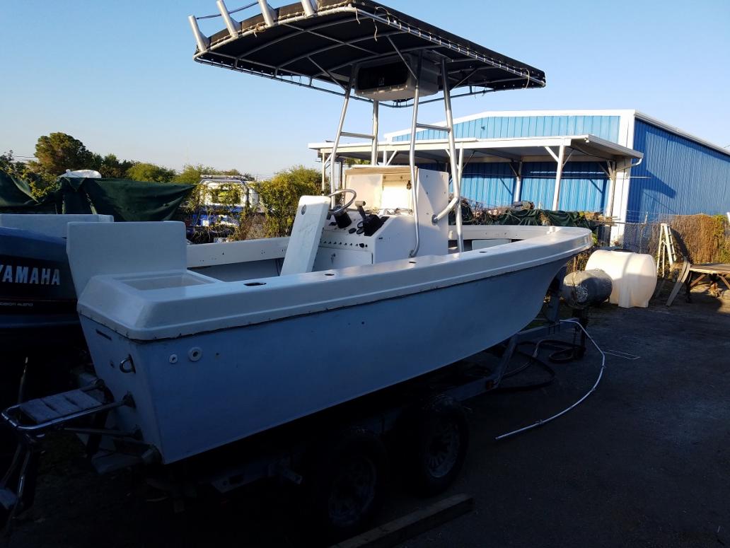

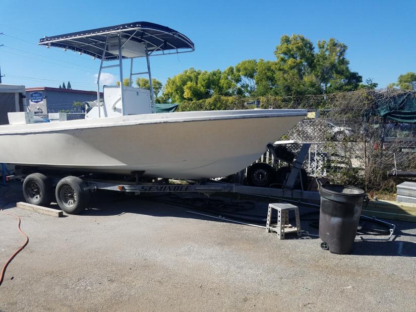

Sanded down the epoxy primer that did not flow out. Started sanding the blue paint from the hull as well. Luckily, the faded/checked blue paint is sanding off pretty quickly and the gel coat beneath is in great shape. No cracking or really any gouges either.
#37
Did a BUNCH more sanding yesterday.
#38
And then even more today
#39
And then I went REALLY crazy

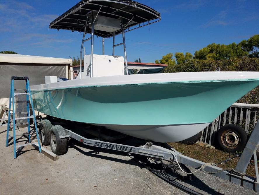

#40

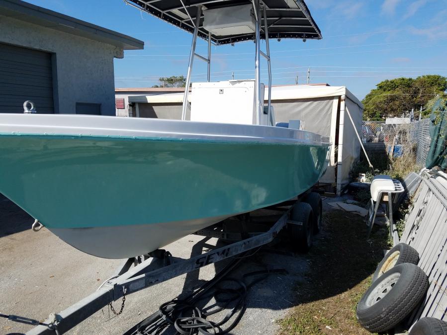

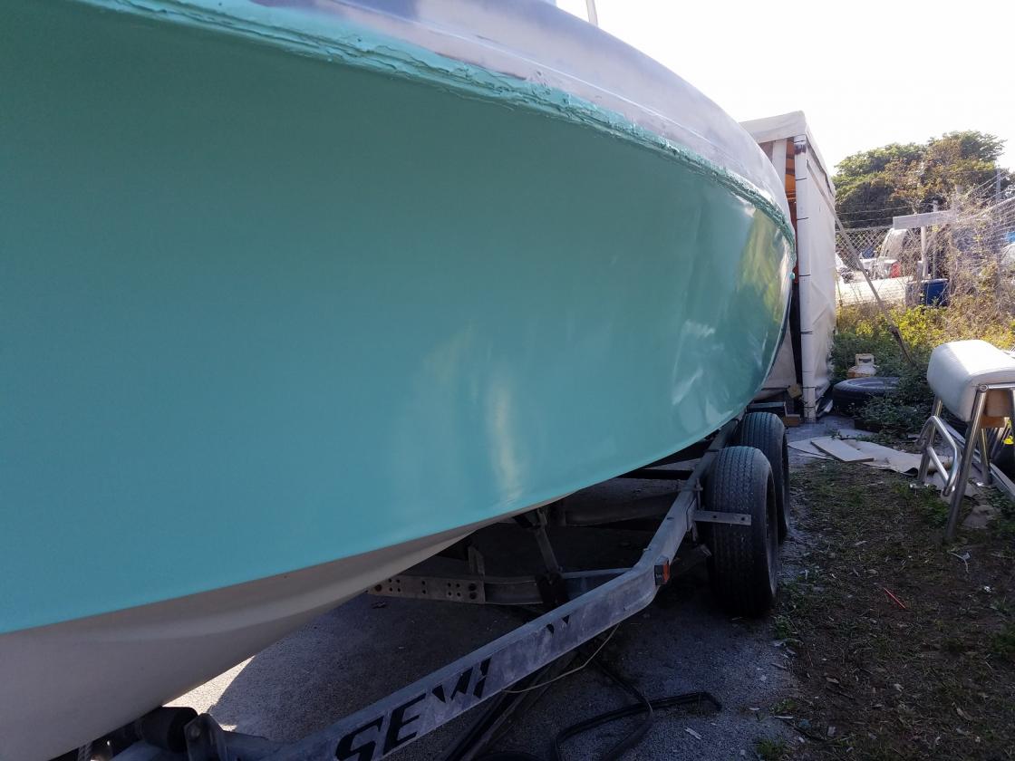

Beautiful morning for shooting some paint on the cap
