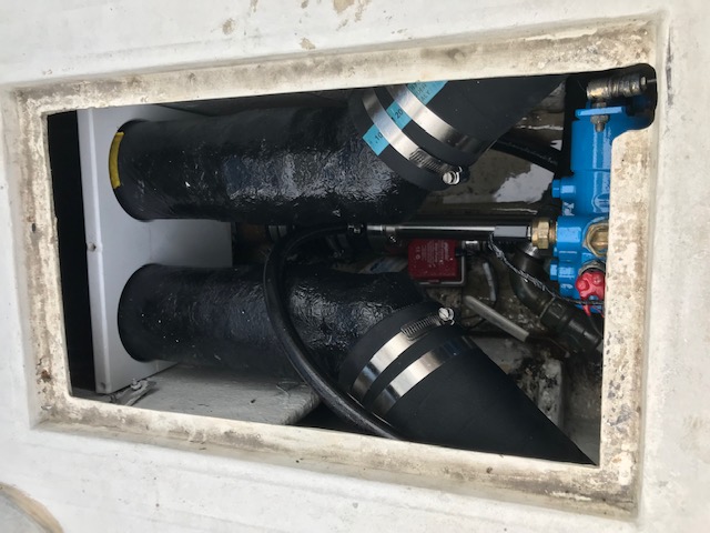

John,
Glad to hear you are up and running. I must be way over propped with my 16 x 17.
cruise @ 23kts @ 3400 rpm. Have any pictures of the dual muffler setup? I would pull a few spark plugs and inspect closely for any signs of reversion if you have not already done so just to be sure. The exhaust on these inboard run close the static waterline.

I don't have any pictures of the install under the deck. I can try and take some pictures this weekend and get a picture of the dual exhaust out the back.
Once we got the engine in the boat, we looked at the riser height in comparison to the water line. We played it safe, 4" extensions were added to the risers. Unfortunately this did not help with the console fitting issues, but well worth the piece of mind.

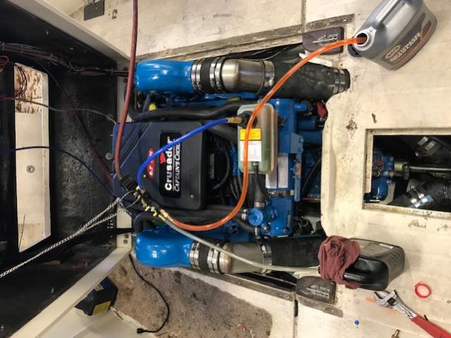

I've been bad with remembering the pictures, but my friend snapped this picture tonight.
  #38
Old 08-08-2019, 08:32 PM
John3325 John3325 is offline
Join Date: Apr 2015
Posts: 173
More pics of install!
